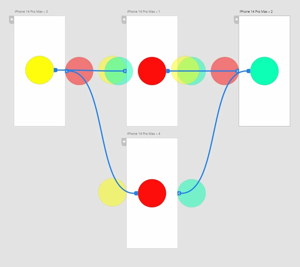

Hi, I have made this design (for reference). You can see the prototypes and design.
So here's the animation preview (attached), I can't go back to the first page without scrolling all the way to the front. How would I be able to do that?
Hamza.

    December 7, 2022
    IMHO you need to add trigger from the last page to start page.

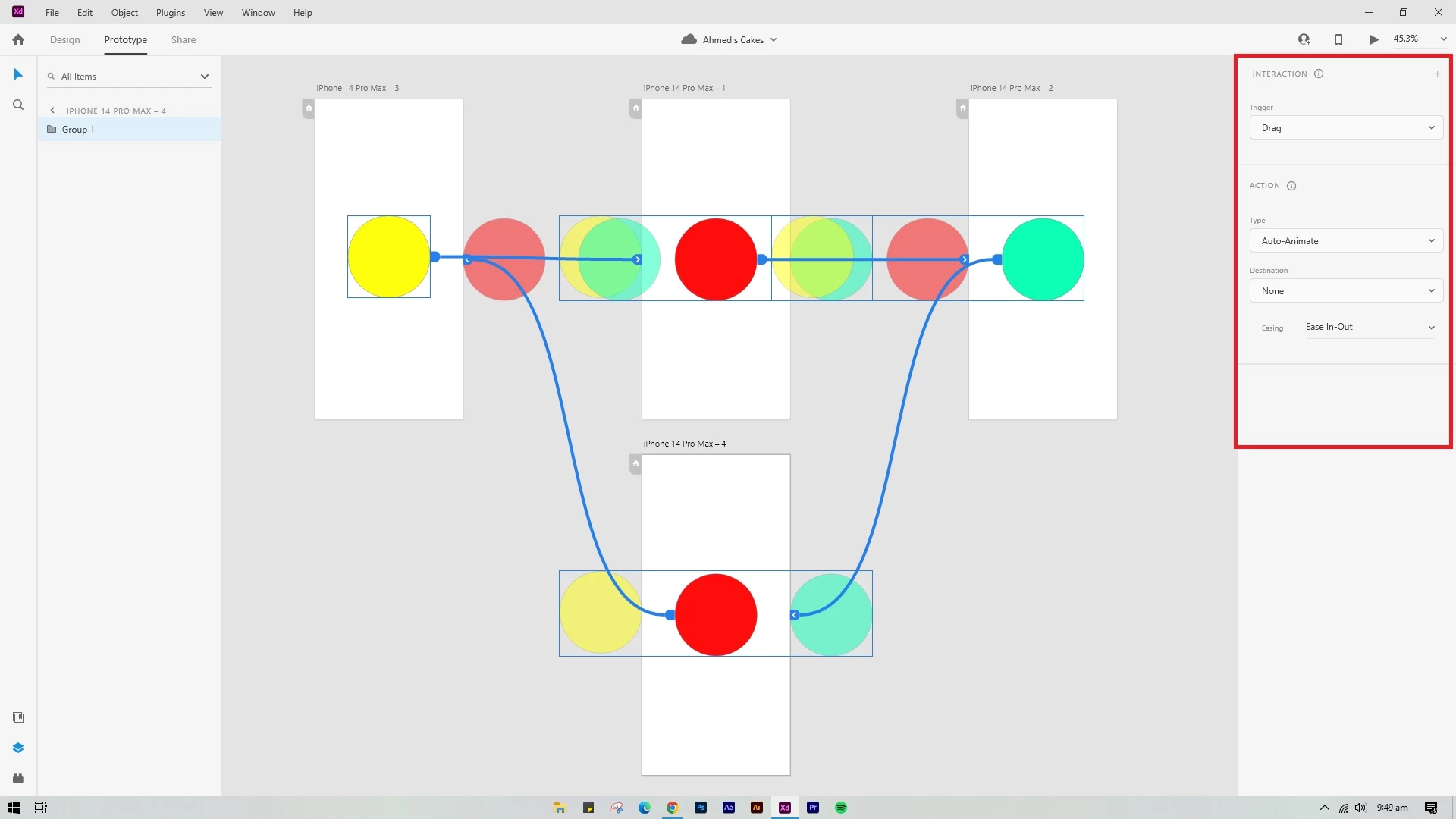

    Hi @Rana Hamza,
    Thank you for reaching out and sharing the design and video. Could you please share the screenshot of the property panel on the right side so that we can check the triggers set up in the design?

    December 8, 2022
    Hi, Thanks for replying.
    The screenshot is attached, all the prototypes have the same drag Trigger and type as Auto-Animate.
