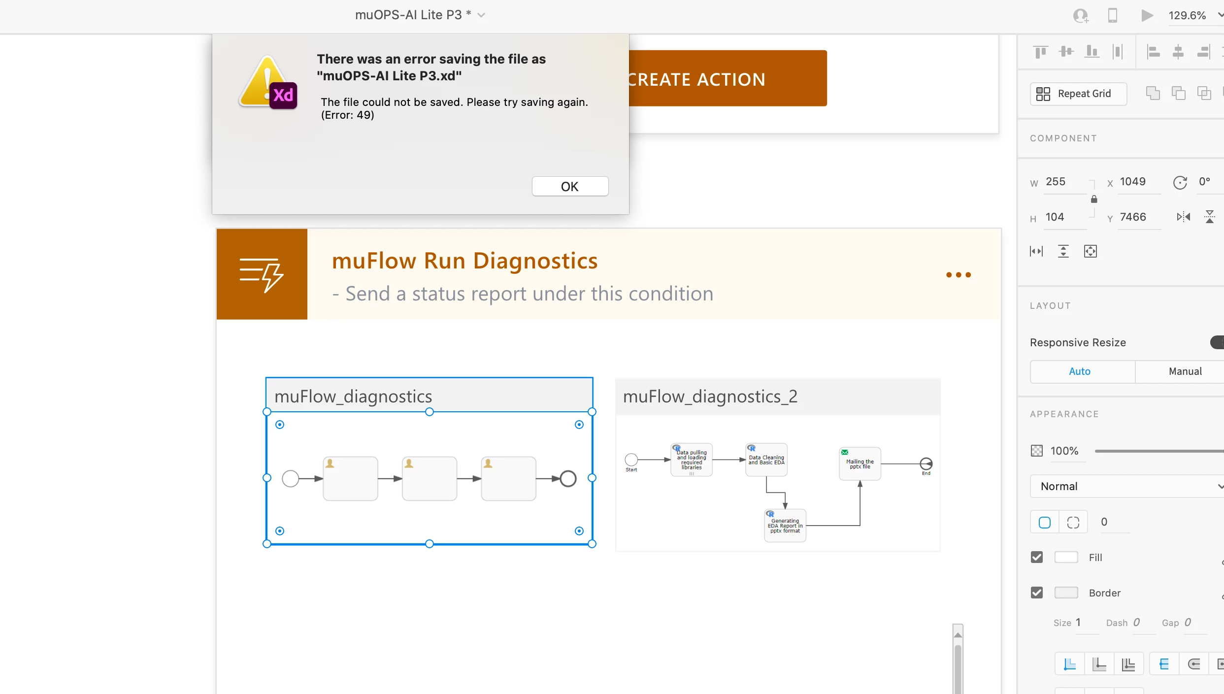

Hi there,
Sorry to hear about the trouble. As per the screenshot you are getting error 49 so, could you please try the suggestions shared here: https://community.adobe.com/t5/adobe-xd/error-49-while-try-to-save-the-file-in-xd/m-p/10507855?page=1#M14337
Let us know if this helps or if you need any further assistance.

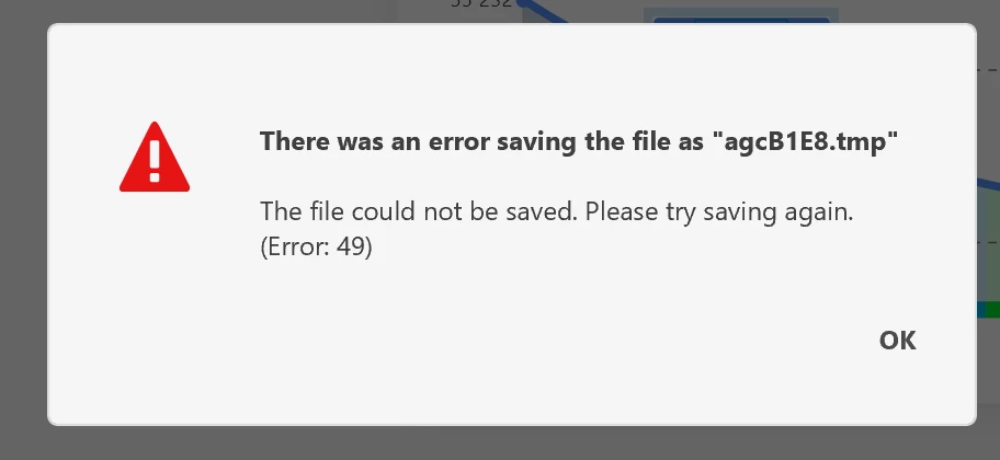

December 2, 2019
I keep having this problem again and again. My file exists only locally on my computer so saving to the cloud solution isn't suitable. I have had several cases where I couldn't save huge chunks of work and had to start all over again losing hours of work! Guys, your software isn't stable and not reliable. I can rename the file, but this will not help me to save it. Looks like the issue occurs when the size of the file hits certain limit.
Also first time it errors it tries to save project to tmp file with autogenerated name if it helps. Nothing helps to resolve this issue except reinstalling Adobe XD, and of course you will lose all unsaved work.
