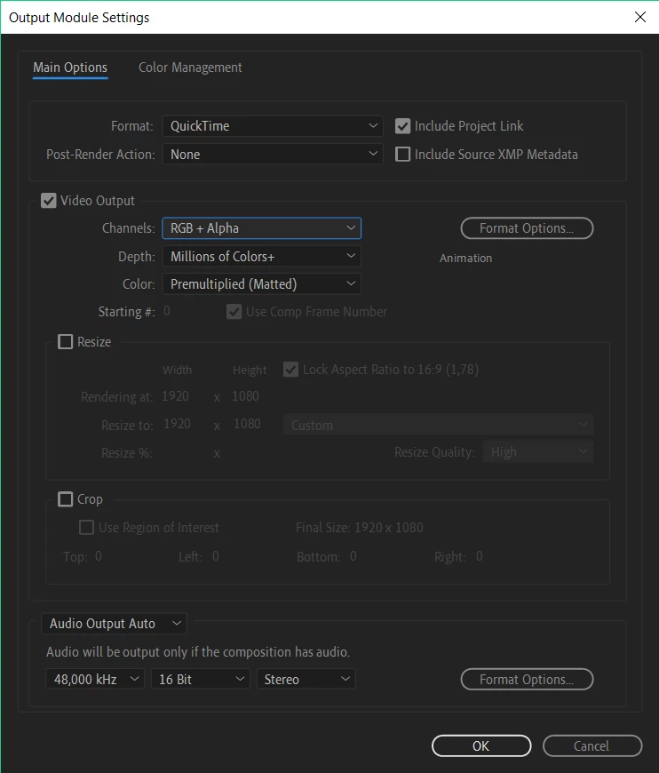

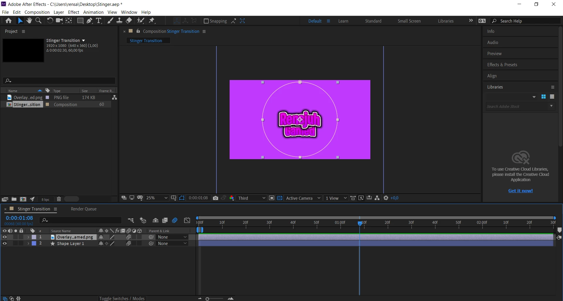

When i render a video it's just a 0 second black screen
This are the settings that i use:

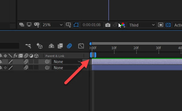

That is because After Effects is by default renders work area and in your composition work area is set to be only 1 frame long
To change that you can:
- grab right blue work area mark and drag i to place where you wist your animation should end
- move your timeline playhead to place where you need your animation to end and hit N on your keyboard
- or if you need to render whole comp and most of your comps you will render like that just change Time Span on render settings from Work Area only to Lengt of Comp

Thanks for reaching out. Did you try the suggestion given by @imeilfx? I agree with his point. I checked it at my end and I observed that if the work area selected is less than 2 frames then you will not get any preview but a black screen for a fraction of a second.
Let us know if you need further assistance or if you have any other question. We'll be glad to help.
