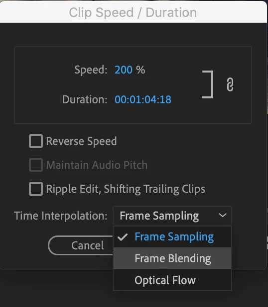

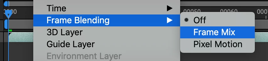

If you want blended frames and you want to keep the speed of the playback real-time, drop you 120 FPS footage in a 24 fps comp or a 24 fps sequence in Premiere Pro, and you'll get blended frames. I don't think you'll like the result. You can also force blended frames in either PPro or After Effects right in the timeline. The time sampling algorithms produce identical results. There is some fairly good information in the User Guide that explains the differences in the frame sampling modes. The names are different but the math is basically the same. AE:
Premiere Pro:

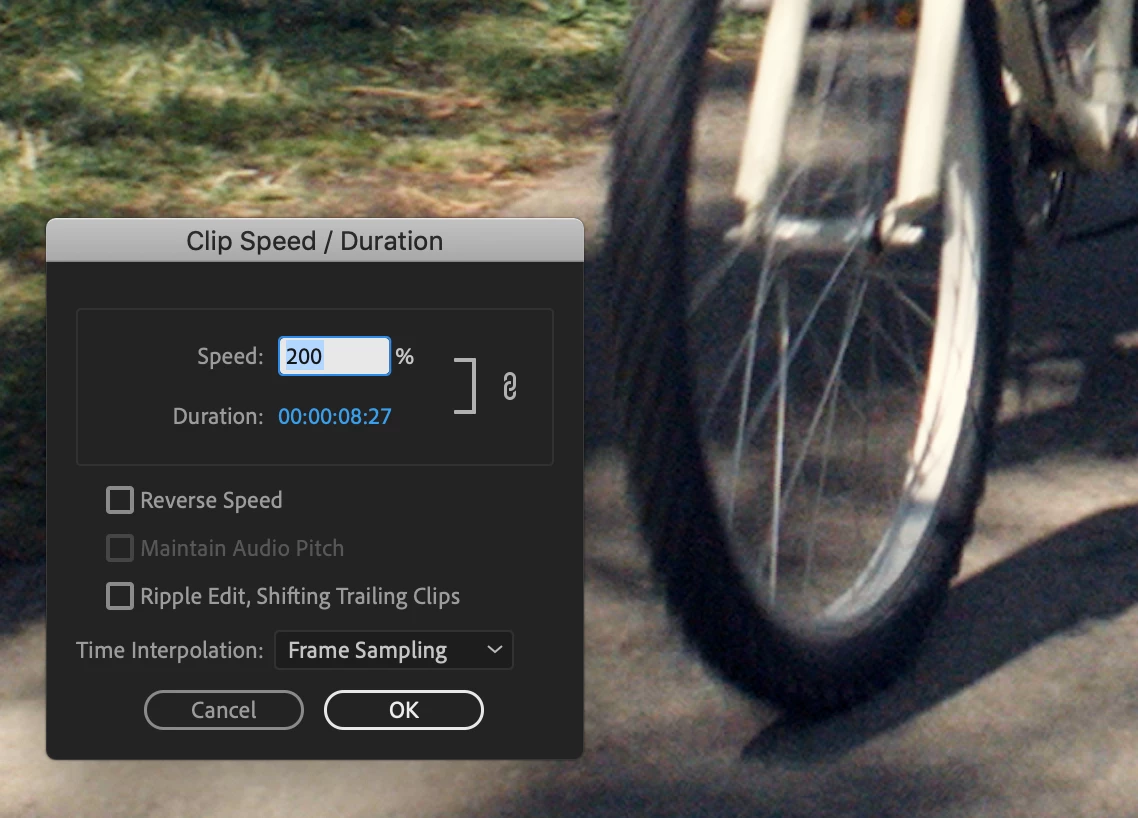

I've got some screenshots for you. Let me explain my production planning. For these shots, I need some time changes for dramatic effect I need to slow down the footage so one second of real-time takes 2 seconds of screen-time and I need to match the motion blur of footage shot at 29.97 fps. The original footage was shot at 59.94 fps with a 359º shutter which gives me the same motion blur as a shot at 29.97 fps and a 180º shutter. Both of those shutter settings give you an effective shutter speed of almost exactly 1/60 of a second. Here is the original frame at 200% magnification playing in real-time with Frame Sampling turned on which causes me to see every other frame of the original footage because I'm sampling every other frame. I don't have the exact same shot with the bicycle in the same exact position shot at 29.97 but the motion blur would be identical.

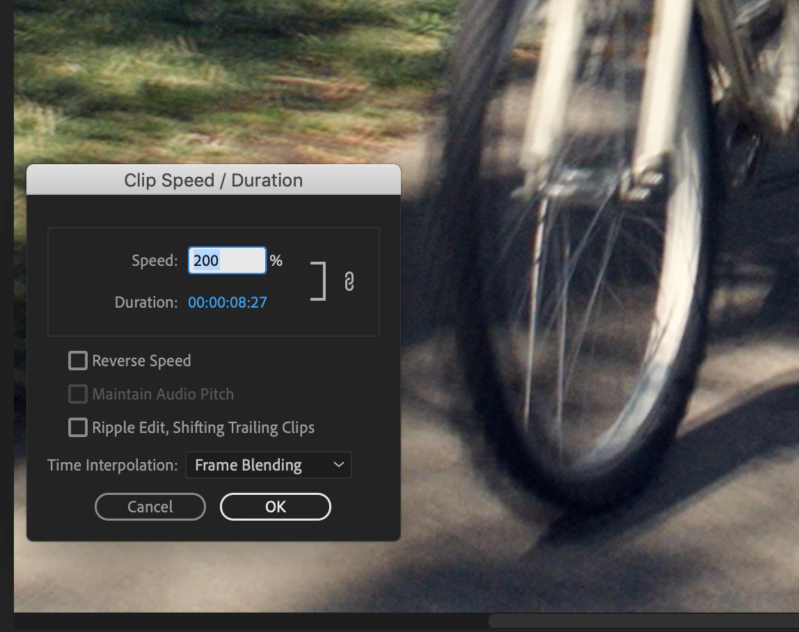

This is what happens when you turn Frame Blending on:
Frame blending in After Effects produces the same result. If you are not doing anything else to the clip but blending the frames there is no need to move over to AE. Your work will go faster in Premiere Pro.

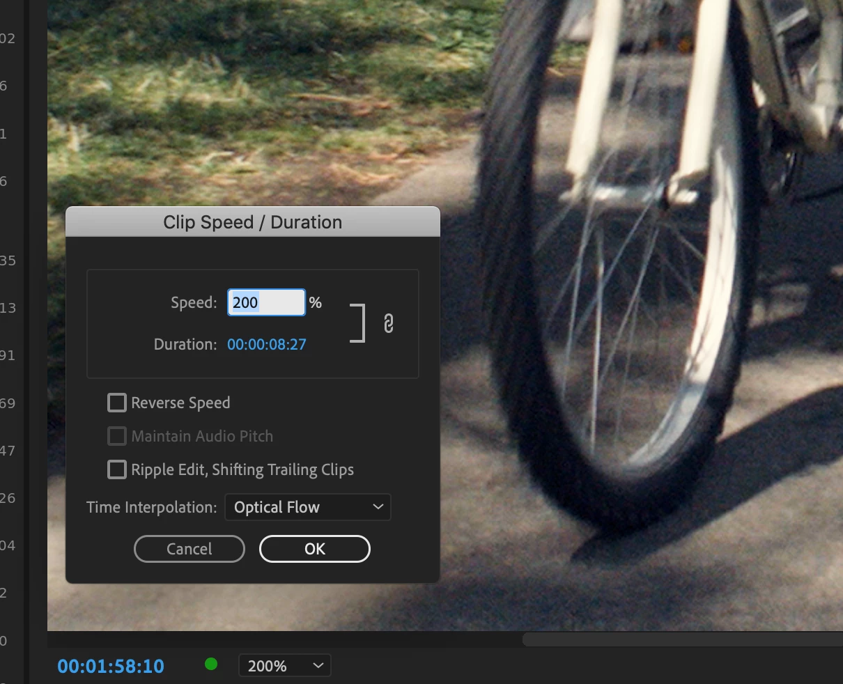

There is one other option: Optical Flow. This option actually tries to calculate the movement of the pixels between frames and generate the best estimation of where the pixels would be.
At first glance, you might think this is doing a better job of blending the frames but it is actually identical to the original frame. You should be able to figure out the math on that one. If there was an intermediate frame to calculate because the speed change was 123% or the sequence settings were 24 fps instead of an even multiple of the interpreted frame rate you would get a better result with Optical Flow turned on than you would with frame blending but that calculation is going to cause an increase in rendering time.
