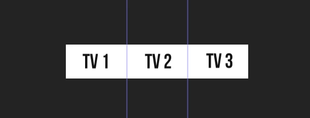

Ok, I didn't explain myself very good.
The video resolution I'm working on is 3860px resolution, but the problem is the PAR that I'm working on. I need it to be 16:3 instead 16:9, so when I display it, it doesn't deform.
The final product has to be something like this:
But I don't get how to modify the PAR of my project to work on that.
