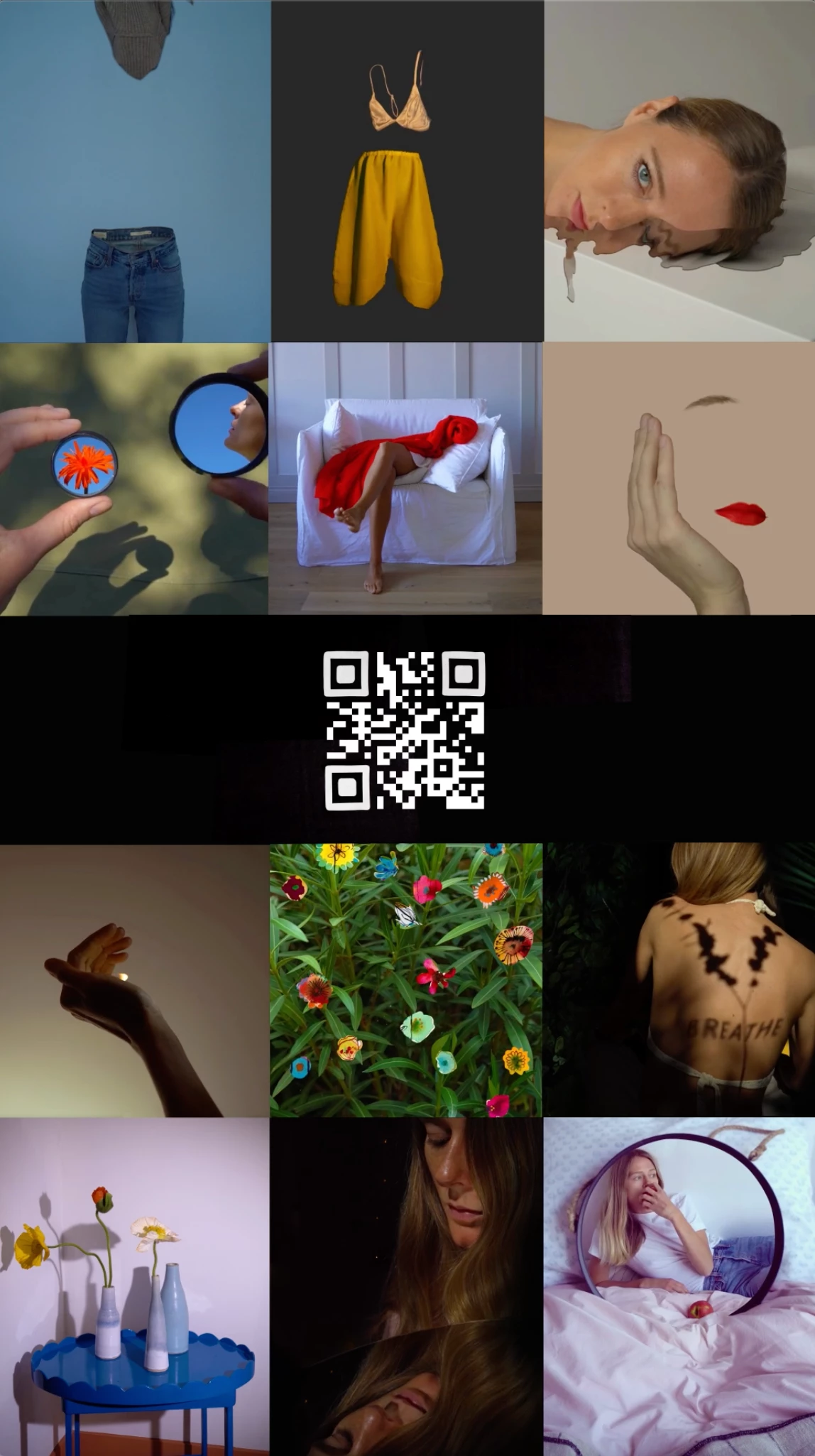

I usually make artwork for a relatively small sized screen such as smartphone or tablet, either in 1080x1080px or 1080x1350px format. For this brief I need to combine a lot of mp4 of those dimensions in a grid to go on a bus shelter of 1080x 1920px (the bus shelter is roughly a human size).
When i create a new composition (1080 x1920), drop in my MP4s and then scale them down, they lose their quality.

(attached is a screen shot of the final layout), the loop is 18 sec long.

When you scale down a video, the detail is going to be reduced, especially if it has fine detail, the detail level is going to decrease. This is your screenshot:
I think it looks good. I don't see compression artifacts. I see as much detail as I expect. If the top right closeup was cropped from a larger image instead of scaled down, the detail would be about the same.
Just as in any photograph or video, you can increase the sharpness, vibrance, contrast, saturation and color balance of the image. If you want an overall increase equal in all of the scaled videos you could add an adjustment layer to the entire composition, apply Lumetri and start fiddling with those settings. I might consider that. If you need additional control over each scaled video, add Lumetri or other color and sharpening effects to the individual layers.
I don't want to get too far into the weeds on compression, but you also need to understand that color in an MP4 file is limited to 8-bits and color is compressed in blocks of 4 pixels. Very thin lines surrounded by vastly different colors, like a pure red 1 pixel thick horizontal red stroke against a white bakground is going to loose some of the red in the red pixels and the white will become a little less white. I don't see fine lines or a lot of graphics in your layout, so this  comp isn't going to suffer very much from that limitation, but you do have to account for the limitations imposed by compression when you design a comp.
I think that an adjustment layer with Lumetri applied and a little tweaking of the sharpness may all that is required.
