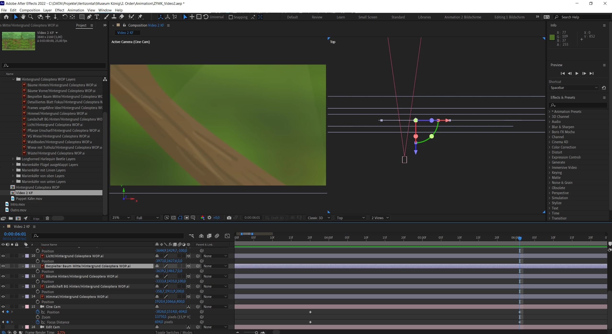

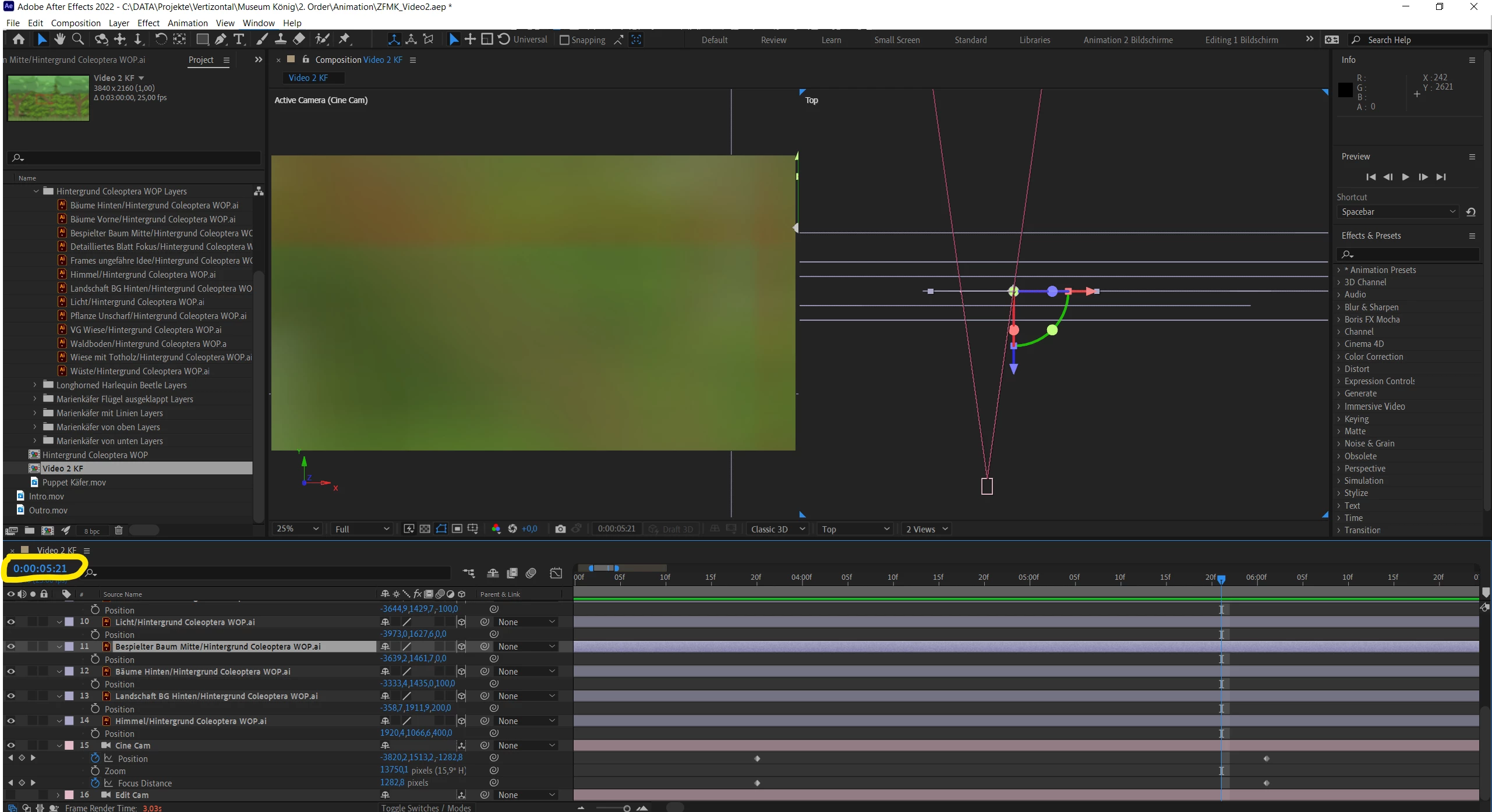

Hey! I ran into this problem multiple times now. I need to use depth of field. I have a 3D Object, that is fixed in its position. I want to move the camera closer to the objects while the objects stays in focus, therefor I adjust the focus distance accordingly to the movement of the camera. Everthings fine until 5 frames before the camera comes to halt the object gets heavily out of focus from one frame to another, even though the focus distance is right and it should be in focus. When the camera stops everythings fine and in focus again. Enabling / Disabling motion blur doesn't change anything.
I just don't understand what's wrong or how I can keep it in focus. Can you help?

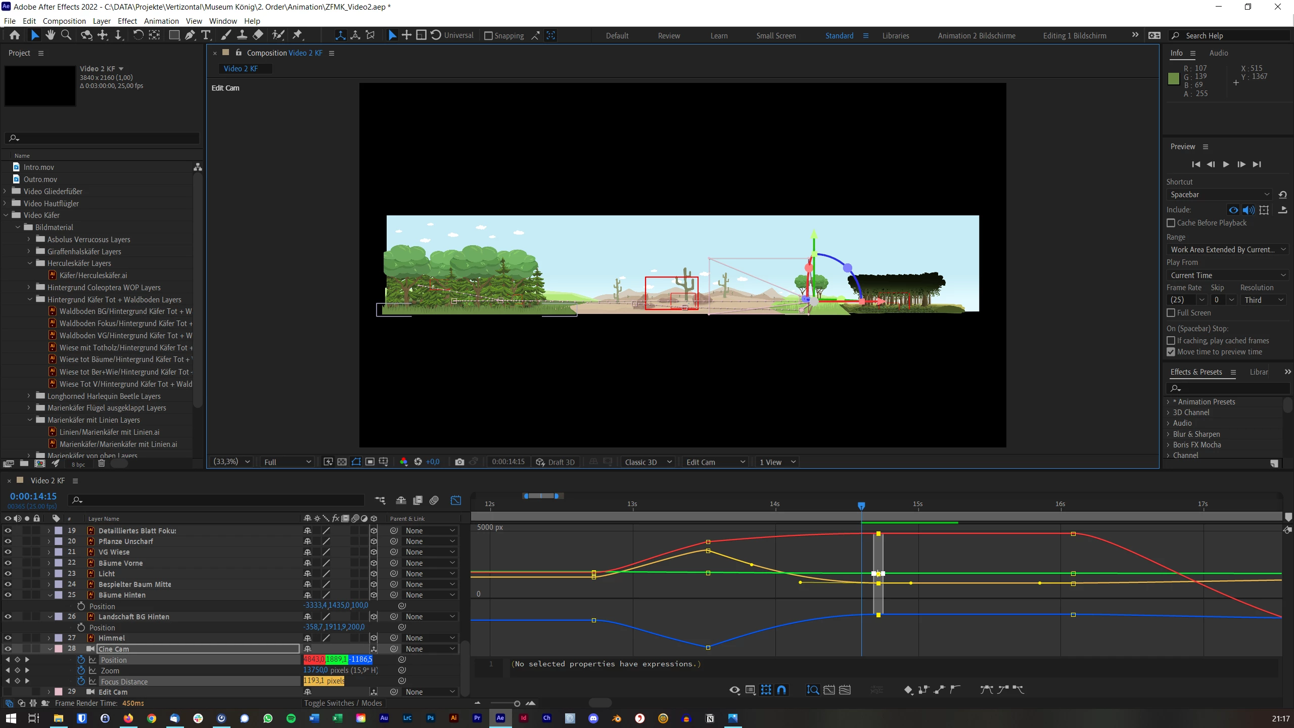

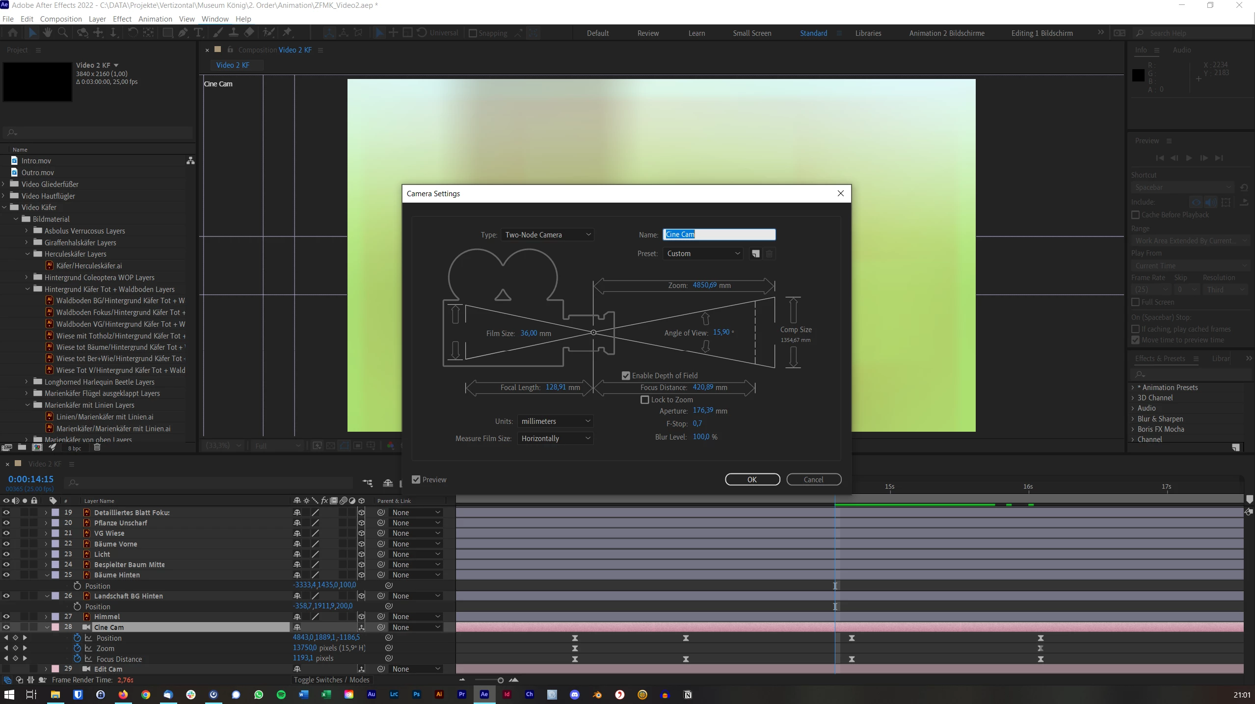

Yes you are right, the video is in 4K and I am nearly exclusively working with illustrator files. I keep continous rasterizing off usually while editing, otherwise my PC would get too slow for me to really be able to work properly. I thoght I had the camera set up with 35mm, although it seems now to be at 128,91mm. I tried and changed it to 35mm but after adjusting the view with moving the camera nearer to my object I ran into the same problem. Aperture is set at 500 pixels. In my previous video I had a fairly similar setup but with the layers way more apart from each other, mostly 500 pixels between. Same problem. That's why I chose less space between the layers in this projects hoping to fix this. The object from the screenshot above is so far from center of the composition because my composition is pretty wide, I have different scenes in this background to which I fly the camera (see the new screenshot attached).
I think I might have narrowed it down to what might the exact problem, but I still don't have a solution.

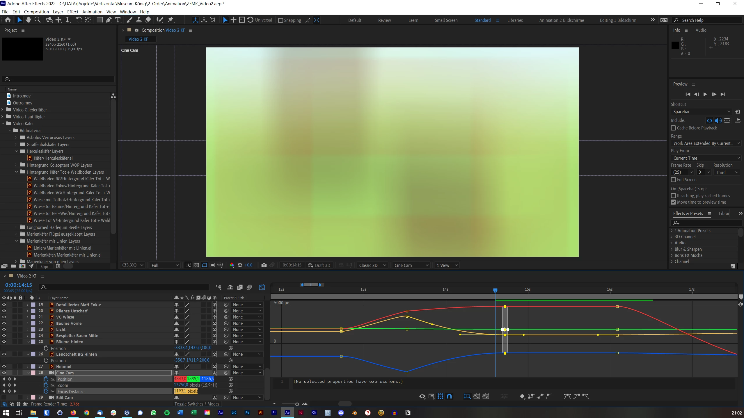

As you can see in the other screenshot even though the keyframe for the camera movement and the focus distance are exactly on the same frame and I only eased them simutanously with F9 their values don't go perfectly together on the last frames leading to the one with the next keyframe. If I switch all of the keyframe's interpolation to linear the problem is gone, but as you may think, the movement looks weird and stops abrupt. Do you know if there is a way to ease just exactly alike, so the focus distance is right?

A pin hole camera is based on a cosine function, so the interpolation is never perfectly linear. You need to tweak the value graphs accordingly to mimic this behavior.
