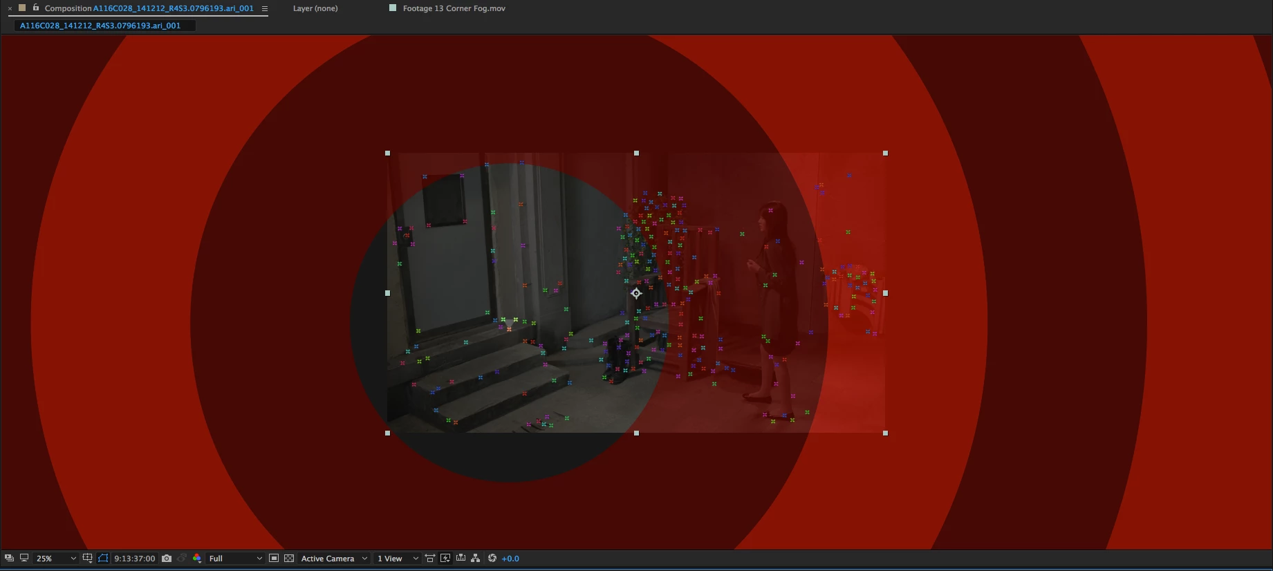

The 3D camera tracker is randomly not creating tracking points or when it does, they are HUGE. This happens regardless of the type of footage. The shot used in the test I'm posting here only has a MINOR camera movement with plenty of places to lock onto. I'm inserting a screen shot. I'm on the latest version of AE, on a mac tower pro 3.7 GHs quad core, 64 gigs of ram, AMD firepro graphics card running Sierra 10.12.6. Video footage is quicktime prores4444 2880 x 1620
Please help! Desperately needed for current project.
In this shot, you can see that the tracking marks are missing but it still thinks something is there. (Note white triangle on the top right) This is happening throughout the shot.
And Finally, - this madness......

I would have to see the  shot but from what I can see there isn't much in that shot that has the changes in parallax required to do a good camera solve. When the tracking markers are way off like that it usually means the shot is not compatible with camera tracking.

Camera tracking in AE works very well for a lot of shots, you can make it work for some difficult shots, but it does not work for all shots. No camera tracker does. If there is any lens distortion in your shot you are going to have to make some kind of correction for that. I usually remove the lens distortion before I start a composite. It makes things a lot easier in the long run.
What are you trying to do in your shot? If you wanted to put something in the frame on the door then Corner Pin tracking in Mocha or even AE wold be a far better solution. If we knew exactly what you were trying to accomplish we could probably give you some suggestions that would work.

I'm just trying to find an accurate way to track shots where there is some camera panning or other movement. I have tried this on a variety of shots some with little movement, some with a lot of movement. some with very little to latch onto, and some with a lot. It doesn't seem to matter what's going on in the shot, the tracker is having a very difficult time. (I don't recall this being as big of a problem on earlier versions. I'm adding a still from another shot where there was plenty to grab onto, but all of the targets created are also HUGE.
