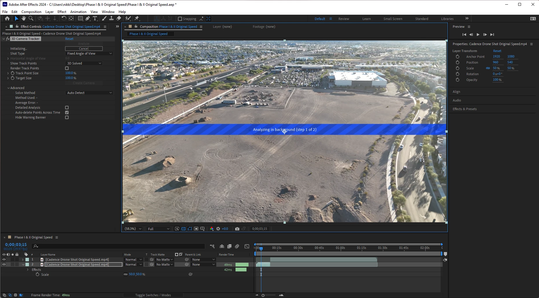

I have a minute and 25-second clip of drone aerial footage that needs to be edited with logos, a site plan, etc. I find using the 3D Camera Tracking tool the most efficient way to work with the space to place graphics into the project (when it wants to work). I initially bypassed the "forever analyzing" problem by rendering the original clip at 600% of its speed with the optical flow enabled in Premier Pro. Then, I place the rendered video back into After Effects, making it 15 seconds of footage. I did animate the whole thing and needed to create edits on it, but I wouldn't say I liked the video quality it turned into after rendering again and slowing the footage down. So I am doing my best to use the unaltered version of the footage.
I've been trying to cut the footage at 10-second variables, hoping it will quickly analyze the field. However, I am stuck on "initializing." Sometimes, when it does want to start analyzing frames, it will be attached to frame 1 with no progress.
I could try motion tracking instead, but after doing that for multiple different logos and pin graphics, I've decided it's just not as fast as a workflow as 3D Camera Tracking is when it wants to work.
I've tried changing the shot type to variable zoom. I've tried changing the solve method to mostly flat scene and have even selected detailed analysis, and none of these options seem to want to help the situation. Before anyone says it is too flat of an area, this is incorrect, as I had been able to successfully analyze rendered points onto the scene from the sped-up version of the video.
Not sure what information you need from me to start working this problem out. Let me know. Thanks!
