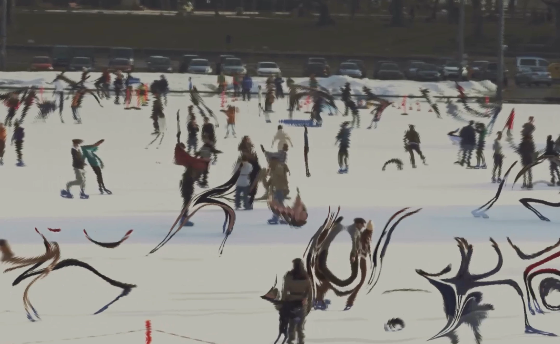

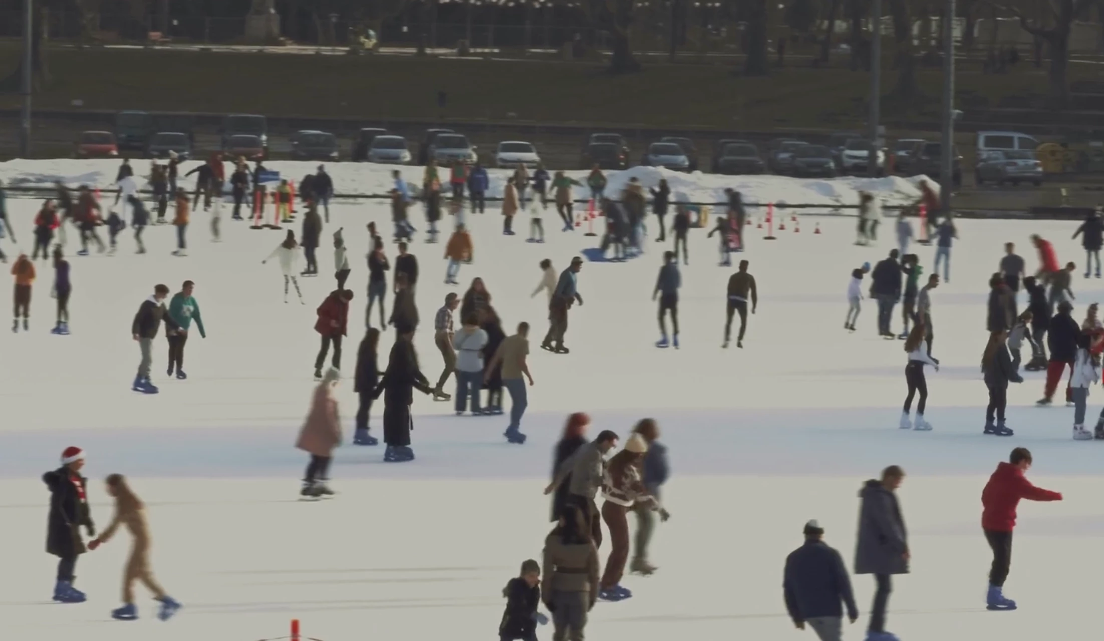

What I've Accomplished:
I've successfully created a time dilation effect with simple panning shots using this workflow:
  1. Track and stabilize the background
  2. Apply time dilation to moving subjects (which correctly positions them in 3D space)
  3. Reverse the stabilization to get the final composite
This works perfectly for simple camera movements. You can see the results in the before/after images attached.
