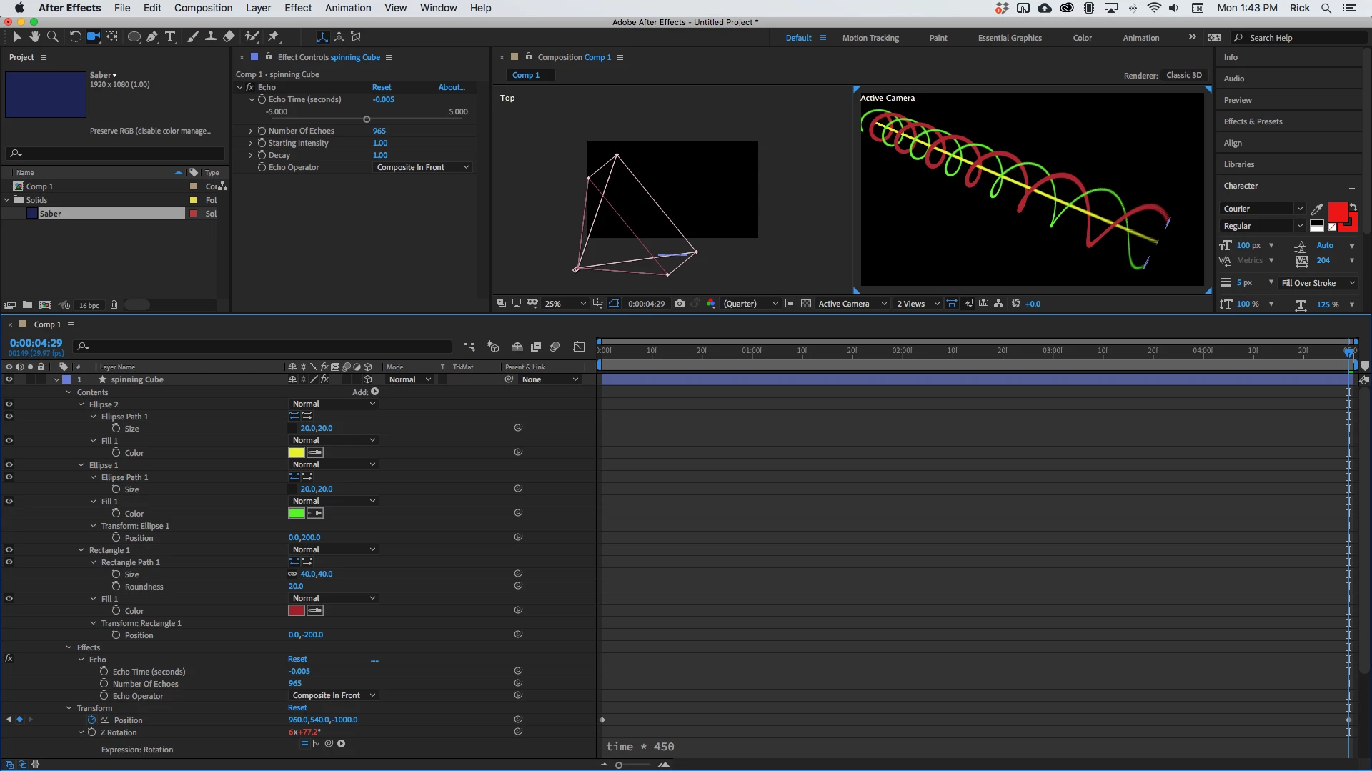

You can generate something like your double helix using a shape layer and echo but it will not generate a path that saber can use.
Saber will not follow a motion path, only a mask path, and unfortunately, mask paths only exist in the X, Y plane.

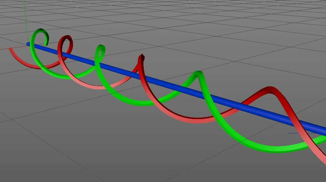

Feb 22, 2021 11:43 AM UTC
To clarify my idea, please have a look at the video. I would like the red, green and yellow lines to rotate around the blue line. For this I need a path that I can define in 3d space. Do you have a tip for a solution?

Feb 22, 2021 10:02 AM UTC
C4D is its own world. You cannot bring in any actual 3D data. Cineware or for that matter the C4D comp renderer merely act as a container. if at all you'd have to do your sweep animation in C4D lite entirely by exporting the AE cam to a C4D scene, doing your stuff and re-importing the result.
