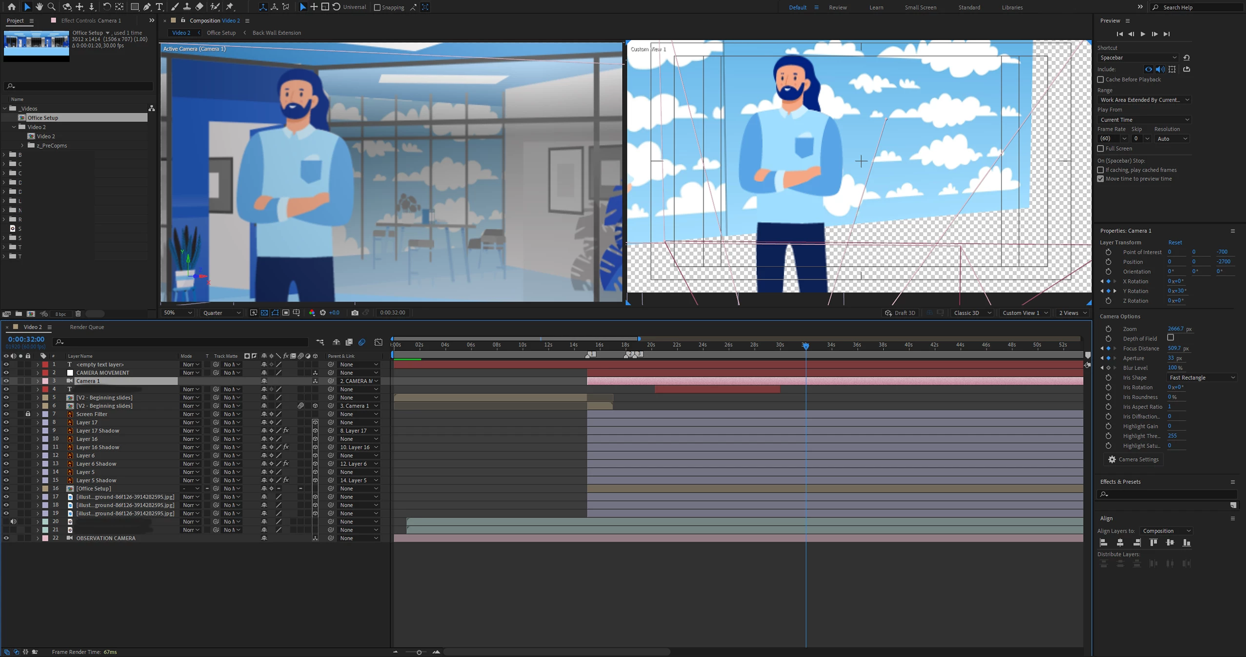

I've encountered a 3D behavior in After Effects that I'm unfamiliar with. There's a 3D layer I can see in the active camera but not in custom view (or any other preset view, such as Front, Left, Custom View 2, etc. However, Default does work). After some testing, this only happens with precomp layers where I enable "Collapse Transformations". The 3D room is precomped to keep it self-contained (and I need to reuse it for multiple comps), but that seems to make it invisible to the custom view. I did not mark the precomp as a 3D layer, as collapse transformations is all I need to make it 3D (plus I don't need to move the room). Interestingly, if I do enable "3D layer" on the precomp while it has collapse transformations enabled, I can see the wireframes of the objects in the custom view though they're still invisible.
Below is a screenshot of what I see. The left view is the active camera and the right is custom view 1. I lined up the custom view to roughly the same area as the active camera to show the comparison:

Actually, I just figured out that the Time Remapping of the precomp was causing the issue, though it doesn't make sense to me. Since my Office Setup composition never moves, I made it a one-second comp and had it Freeze Frame in my regular comp. This worked as intended for the render, with the 3D office visible for the whole duration. However, the custom view acts as though the precomp is still only one second long, despite being a freeze frame, so you can see it for the first second of the timeline but it vanishes after that. Weird.
To solve this, I simply made the precomp have a duration of ten minutes, which is longer than the final video will be, so I can forego using Time Remapping.

I see the wireframe from the camera in the Custom View. You may have rotated the custom view or placed the camera in an unusual position.
The other views are only helpful in lining up the layers on the virtual 3D set. They will not render, and what you look at in those views has nothing to do with the final render. They only show the relationship between the 3D layers.
Jul 14, 2024 5:01 AM UTC
Hi Rick, I appreciate your reply. Yes, I placed my custom view very close to where the camera happens to be at this timestamp (simply for the screenshot, normally it's not like this). My intention with the views (in this case, custom view 1) is to adjust objects in the 3D scene without moving the official camera. The regular camera object is the one that will render. I have no intention of rendering with the custom view.
I'm curious why the precomp (named "Office Setup" in the screenshot) isn't appearing in the custom view, as I'd like to shift objects around that precomp. It's difficult to make adjustments when I can't see the precomp.
