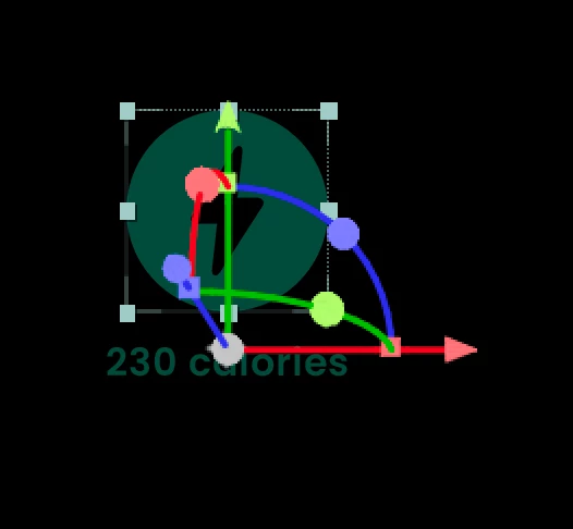

Hi all!
I'm trying to use 3D rotation on a layer but when I activate the 3D function the axes look... skewed?? I created this same rotation a few weeks ago on a different project but not sure what's happened here! I had this issue a few times in the past but haven't had it since - does anyone know how to fix this at all please? Have attached a screenshot!
TIA!
Mylenium
September 23, 2022
Your artwork is tiny and that alone could indicate that you have a very short lens with an extreme curvature that would distort any 3D item at the shortest distance, including the transform widget. Start by actually creating a camera layer and check the focal length setting, then adjust your scene. I'm pretty sure your artwork will look like a tiny speck once you do, revealing how much "zoomed in from space" you actually are.
Mylenium
September 23, 2022
Thanks for your reply - I've done the same animation with near-identical artwork before and never had an issue with this... I don't tend to use cameras on my work as I only do relatively simple animations so not 100% sure how to do this but will give it a try!
