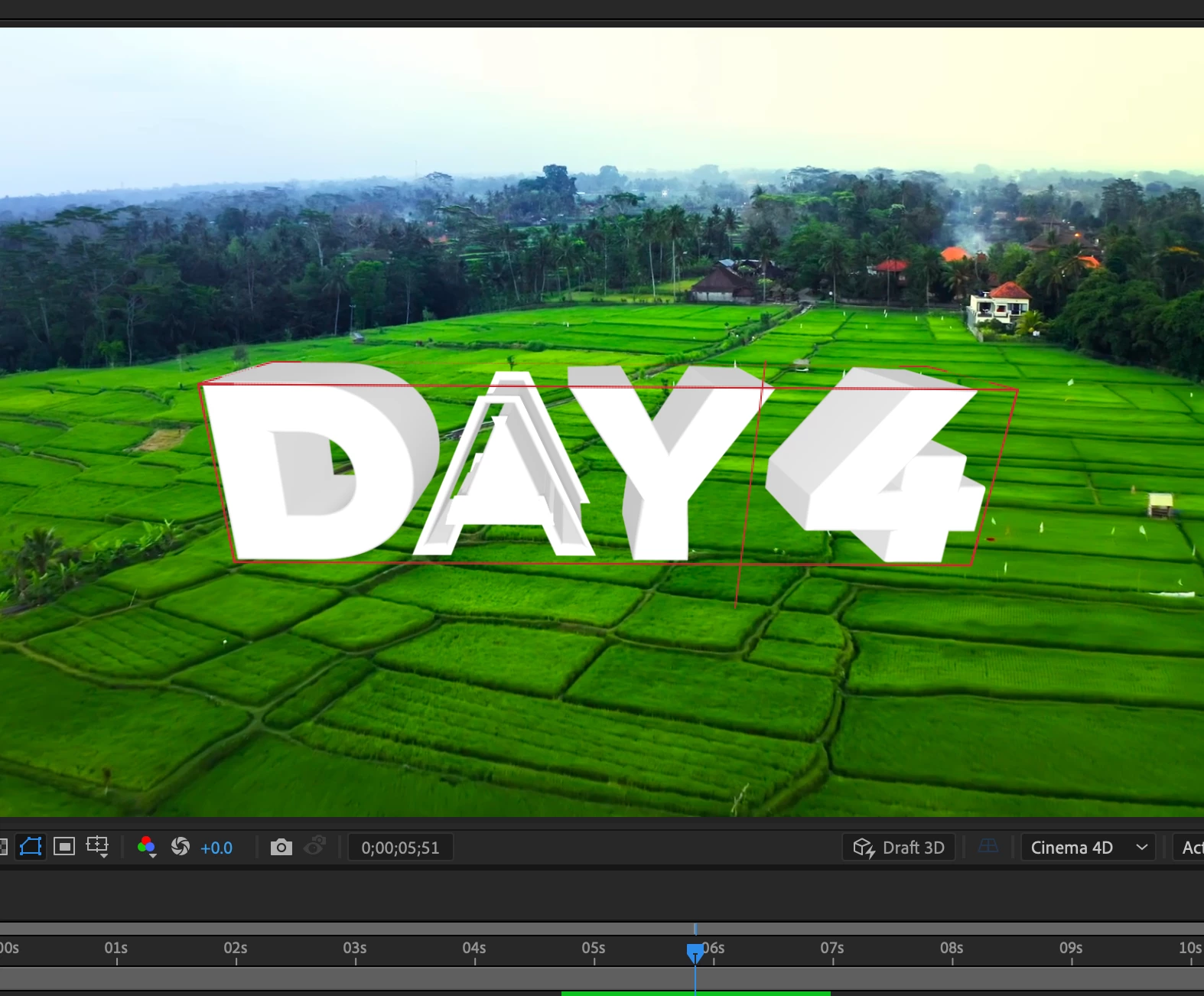

Hi, Using maximum render quality in Cinema 4D settings under composition settings and trying to motion track this text.... the A for some reason is not looking great at all and I'm not sure why it's doing it. I've tried changing font sizes and render quality and everything....

I can see that at the top of the "inner" part of the A, there's an inverted triangle, which suggests that the font you've chosen is the cause of the issue.
The lines are crossing, causing the inversion, which is then flipping what's meant to be filled and what's meant to be empty.
Do you have to use that font?  Does changing it fix it?
If you do have to use that font, try Layer > Create > Creates Shapes from Text.  You should then be able to tweak the A path to stop this cross over.

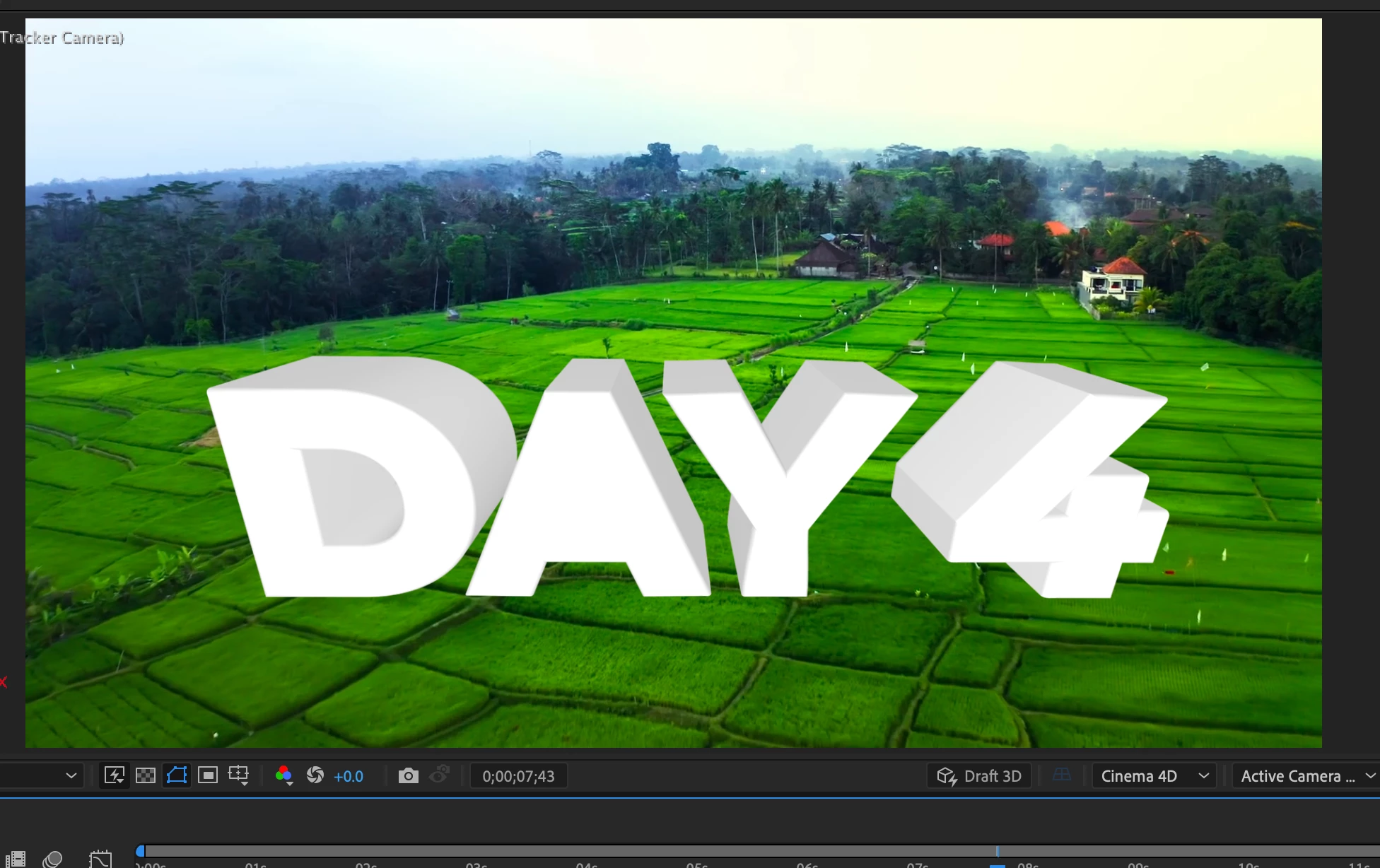

Thank you! so that worked for the most part, but now the A just has a solid fill in the middle unlike the D.
