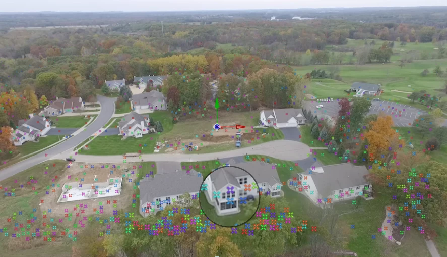

Hello All,
I'm having an issue where my 3D tracked points are staying affixed to objects after I scrub thru the timeline after the footage is analyzed.... SO FAR SO GOOD.... but soon as I "Create Null and Camera" those same tracking points drift as footage is played. I've included some screenshots. Any help would be greatly appreciated. Thanks!!
1st Frame After Analysis is run (No camera created yet)

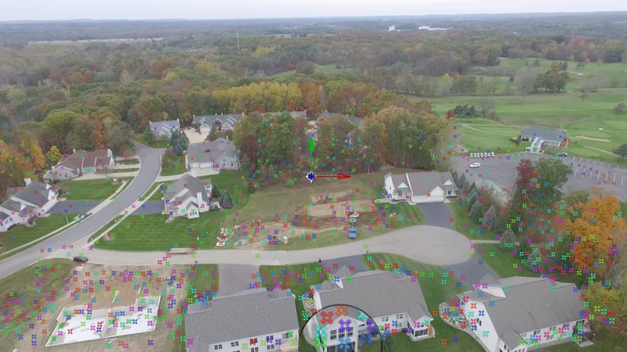

Scrubbed thru footage - notice tracking points in the same place

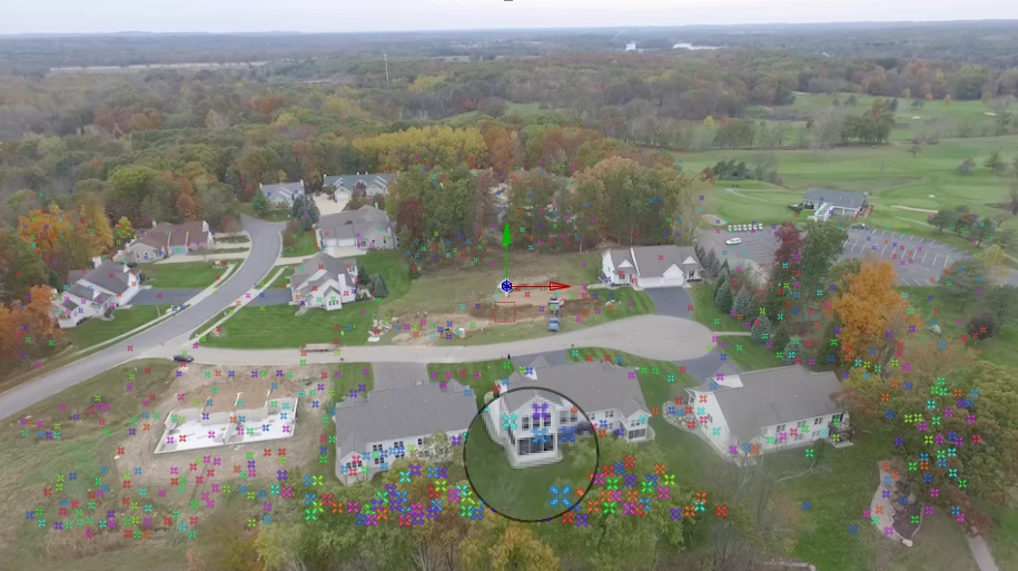

After Camera Created - 1st frame - Tracking point starts out in the correct place

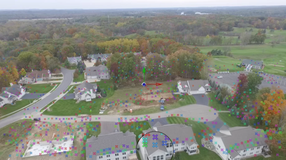

Scrubbed thru footage after camera created - notice the 3d tracked points drifted up the footage

This problem, the problem of tracking points not following the expected path is only solved by setting the proper analysis settings in the Camera Tracker and picking the right points. In a shot like this, setting an origin and ground plane and then adding a reference solid and a camera are critical to figuring out how the tracking is going. If you just add a null like the OP said they did, there is no reasonable way to verify that the points that were selected are on the same plane. Most of the time, inexperienced users don't properly set up the tracker or pick the right points.

The first screenshot shows a 3D cursor and the OP says no camera or null is created. This tells me that it is highly likely that the footage layer is 3D. That is an error that would be solved by reading the manual. There could be another 3D layer in the comp but because the screenshot is cropped and no workflow description is offered we don't know. As you look down the stack of screenshots the 3D cursor does not move from the center of the frame so this tells me that the OP has either added a camera to the scene not using the 3D tracker or that the footage layer that was tracked is a 3D layer. Again, reading the manual, or providing details would point this out.

Is your footage a 3D layer? It can't be. The tracked footage has to be a 2D layer.
The only real good way that I have found to test a Camera track is to:
  1. Set an origin and ground plane somewhere close to where the actual origin and ground plane is you your scene so the target looks like it is attached to the ground - the perspective must be correct
  2. Create a solid and a camera using the origin and ground plane and scrub through the shot to see if the solid sticks to the ground
  3. If you have any doubt that the track is correct you can make the solid bigger, add the Grid Effect and rotate the solid so that it lines up with the perspective of the shot
Once you have a good origin and ground plane you can put as many 3D layers in the scene as you want and they will track perfectly.
One more thing, if there is lens distortion in your footage it must be removed before you track or anything you place in the scene will drift as it approaches the edge of the frame. AE's camera lens is perfect, real lenses can be pretty good. Your shot looks like there is a slight bit of barrel distortion but you are probably Ok.
BTW, cropped screenshots are almost completely useless. I am assuming your footage is a 3D layer because there would have to be another 3D layer selected and transparent and you would have to select render Track Points in the camera tracker to have a 3D cursor in the comp panel. It would probably do you some good to carefully study the Help files and some good tutorials on camera tracking.
