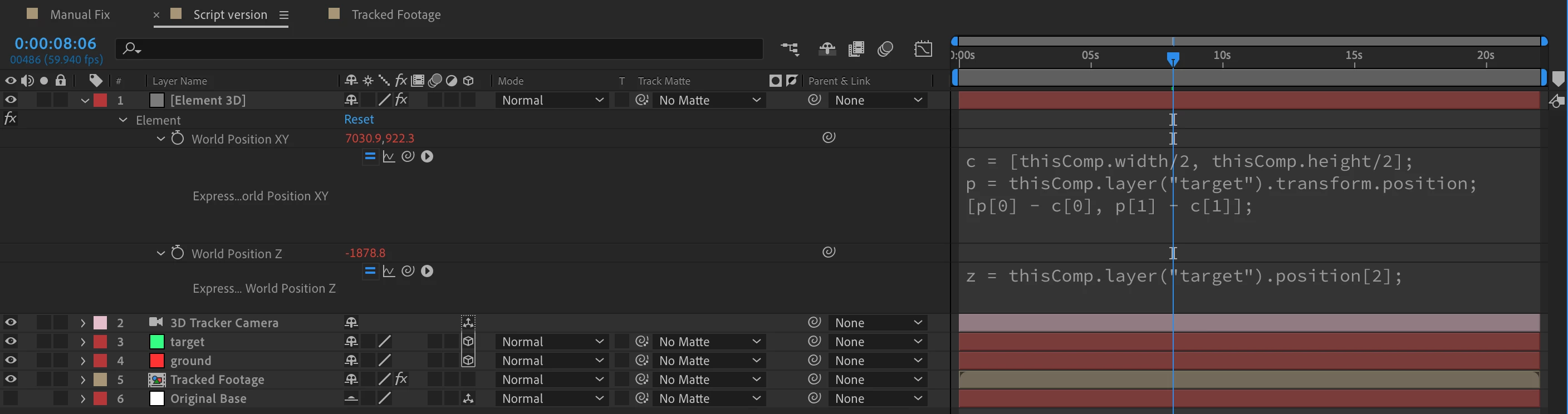

Jul 20, 2024 4:35 PM UTC
I have not had time to create the tutorial, but I have some animation presets to help you align your Element 3D model to a "target" layer that you have placed using AE's Camera Tracker. If the "target" solid is precisely where you want the World origin of your Element 3D models.
This is the expression for World Position XY;
c = [thisComp.width/2, thisComp.height/2];
p = thisComp.layer("target").transform.position;
[p[0] - c[0], p[1] - c[1]];
This is the expression for World Position Z;
z = thisComp.layer("target").position[2];
I will let you know when the tutorial is up.
