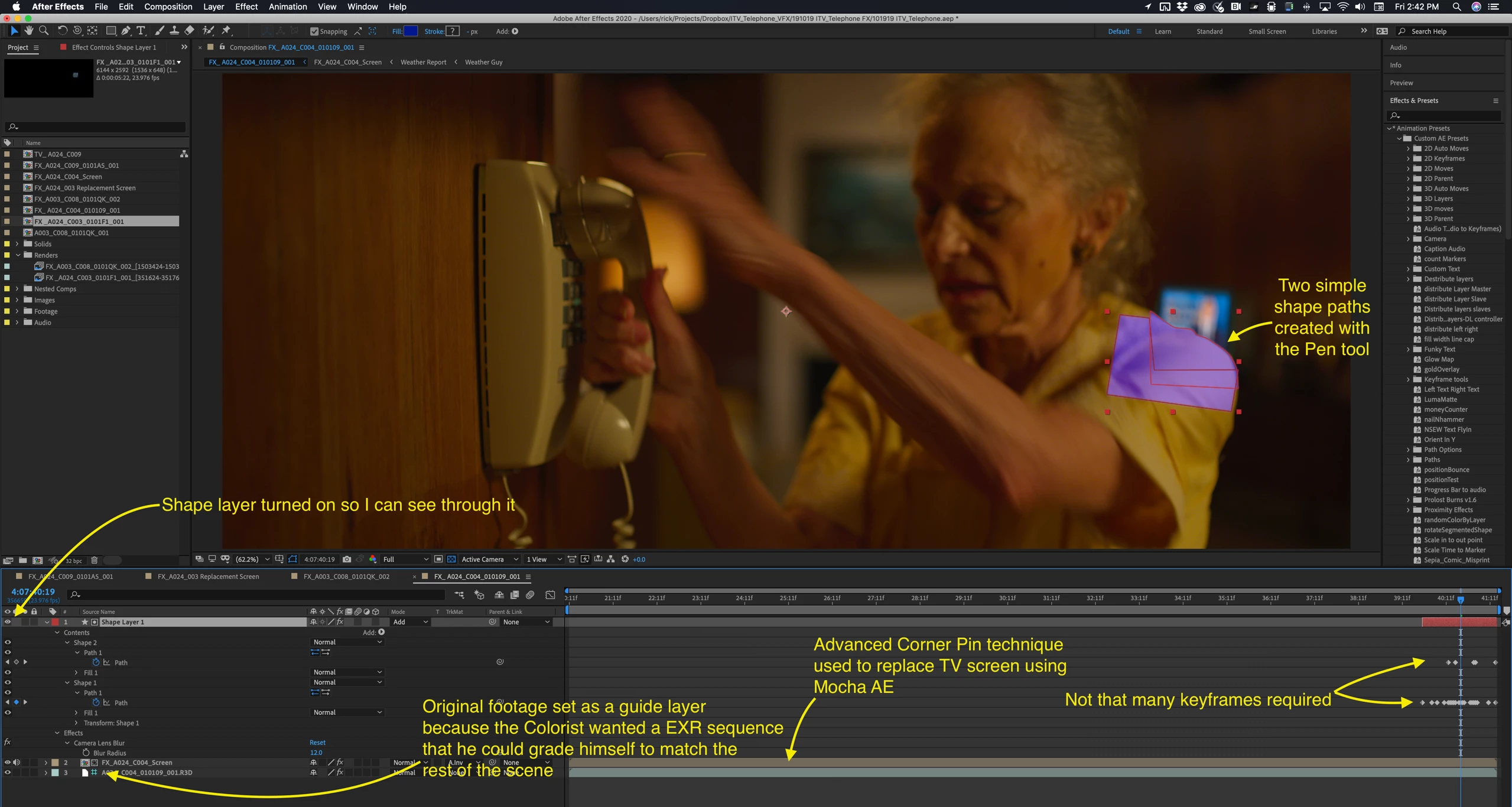

Here's the shot. It is about 12-seconds long. The actor walks to the phone and answers, focus follows the actor. Only about the last 20 frames have the actor in front of the TV. This is the final composite showing an animated shape layer (turned on so you can see through the layer and see the two paths I had to keyframe manually.

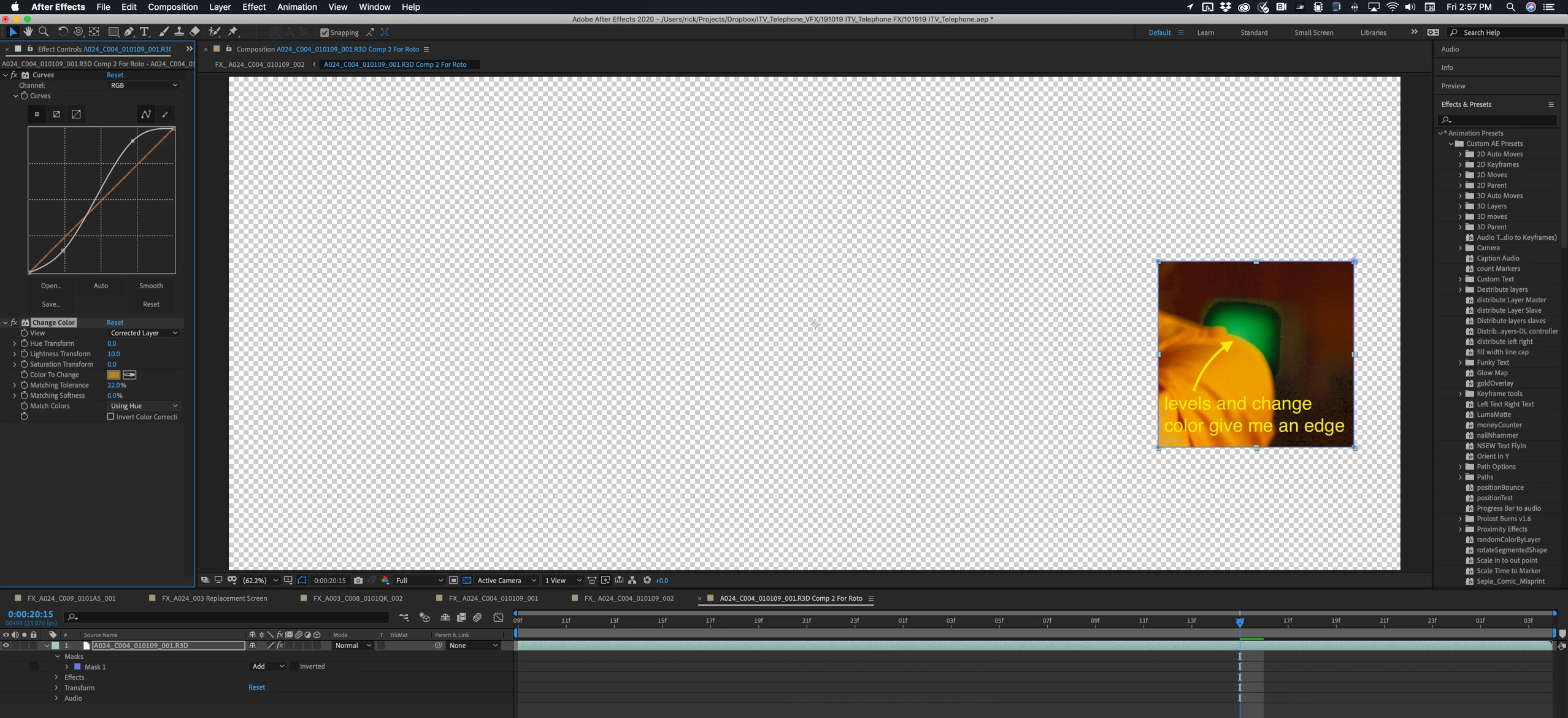

This was actually my second attempt at generating a matte. My first idea was to give Rotobrush a try. The original layer was duplicated, trimmed to the first frame where the actor's shoulder needed a mask, a mask was added, some color correction was applied to try and generate a good line. This is 6K Red footage by the way. You can't get a much better image than that. It looks promising.

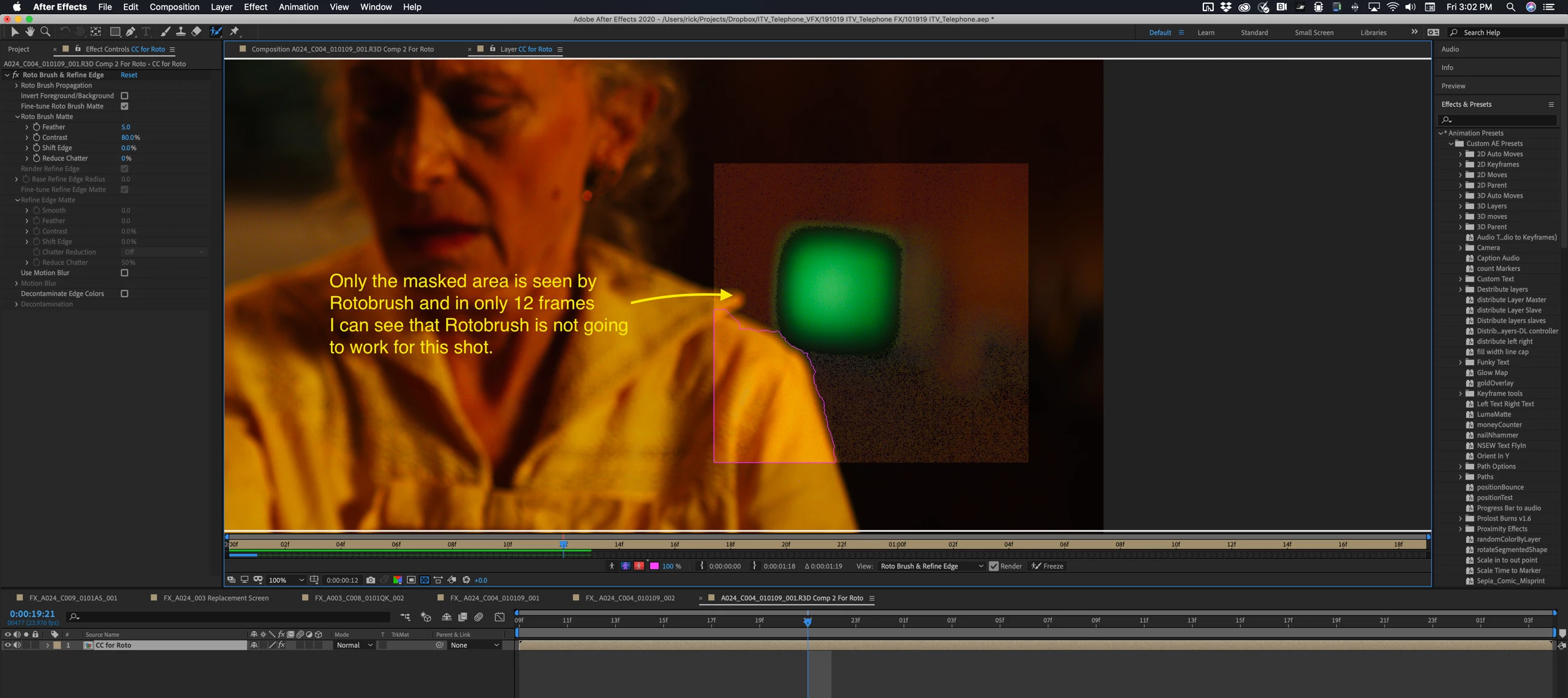

I used curves and Change Color to try and improve the edge between the TV screen and the actor. The entire thing was pre-composed and then I opened the nested comp in the Layer Panel and tried Rotobrush. This is what the matte looked like after just 12 frames.:
When you open up the nested comp in the layer panel you will see all of the footage but Rotobrush will be limited to just the area inside the mask. After about 20 seconds of propagation, I could tell that the change in focus was going to be something that I had to handle with some hand roto and Camera Lens Blur.
So that is one example of how to efficiently roto something. If I had handed this shot to a half dozen students most of them would have not trimmed the roto to just the 20 frames, a few of them would have tried to mask out the entire actor, and a few of them would not have even thought of using an animated shape layer as a track matte for the screen replacement.
So I guess that is at least part of the answer to the question you asked. Efficient roto requires you to analyze the shot, make a good try at what you hope will be the fastest solution, then change the workflow when you run into trouble so you can get things done. The most important thing for you to learn is how to figure out how to do roto with the least amount of effort. If it was not for the change in focus and the continuously softening edge of the actor's shoulder Rotobrush would have been able to create the matte that would be used as a track matte for the TV screen in about 10 minutes. Creating the matte by animating a shape layer path took me about 12 minutes. It was the shortest part of the entire project.
