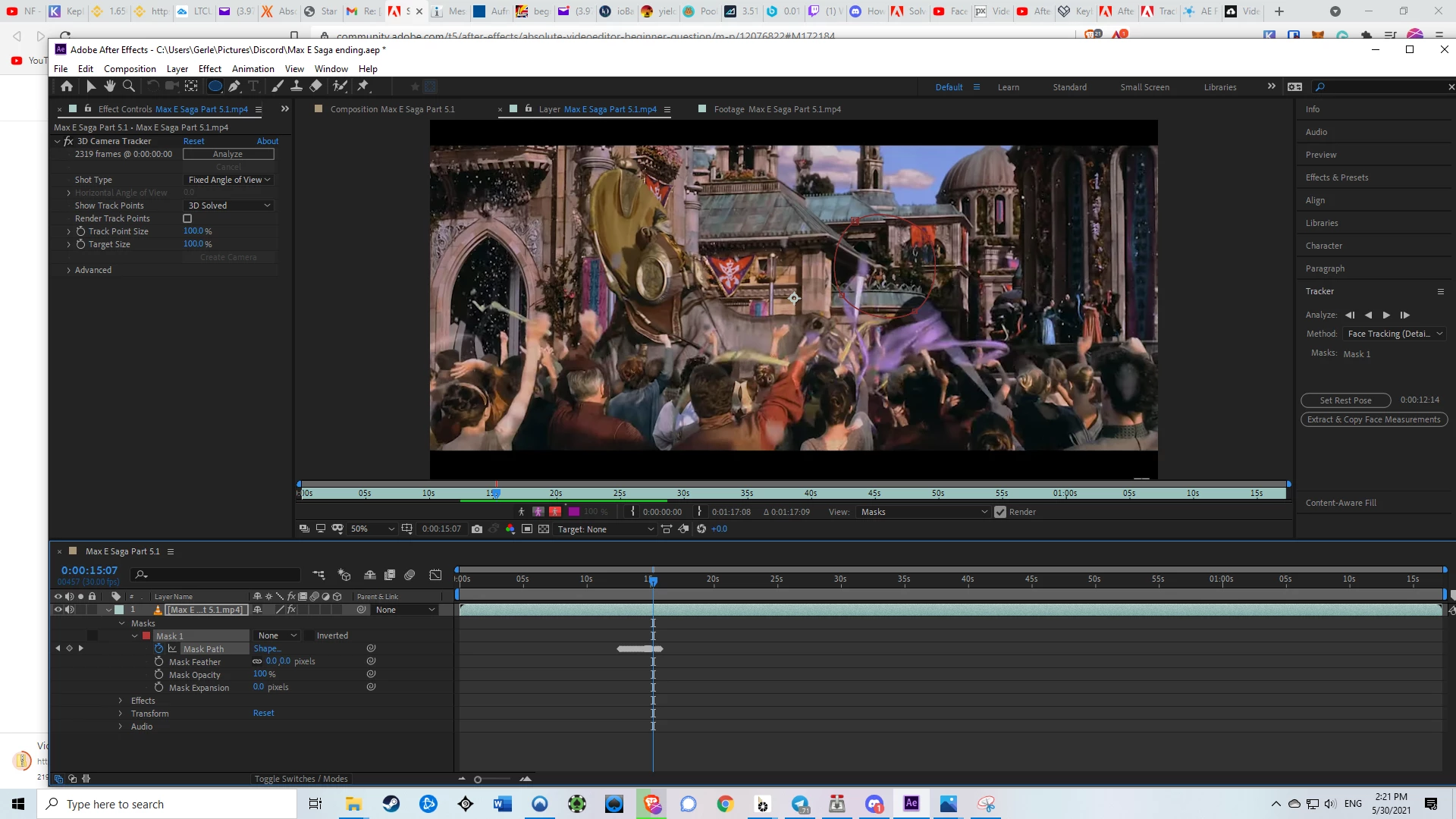

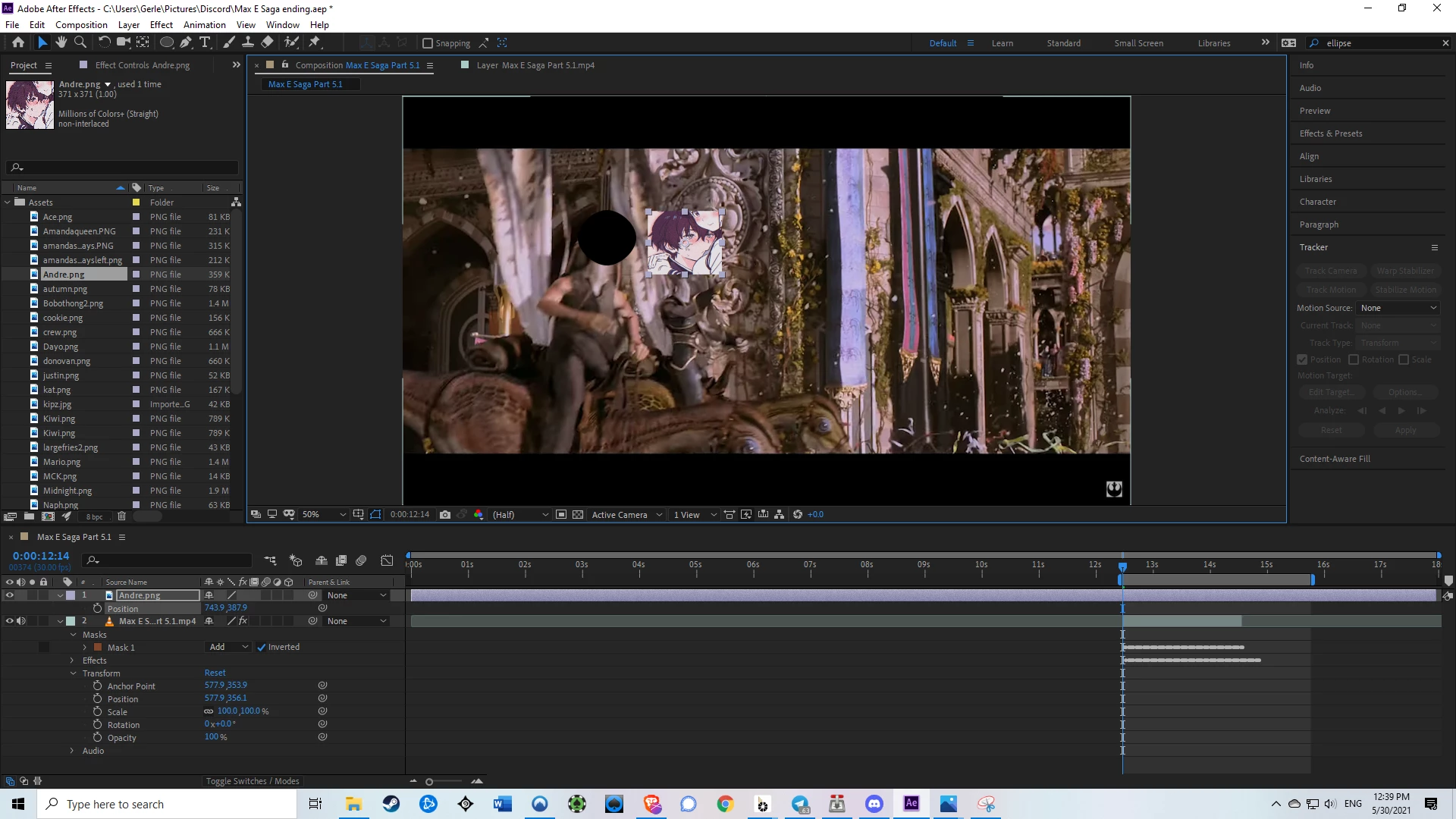

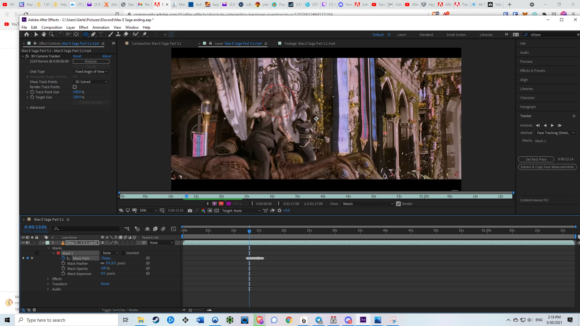

First, in the future, please embed your screenshots instead of using the Drag and Drop area. It's buggy and inconvenient. Use the toolbar or drag them to the reply field and make them big so we can see them.
Second, let's talk about workflow. Each of the shots that you want to track and replace a face should be a separate composition. All of your screenshots show a very long sequence with little bits of mask tracking data for a few seconds.
It looks like you have just manually keyframed an ellopse (circle) mask. The masks do not look like you used face tracking. From what I'm guessing about the shots Feature Tracking or corner pin tracking in Mocha AE is going to be a lot easier than using face tracking. Manually keyframing masks then tryint to attach other layers to the mask position is going to be the most cumbersome workflow and you would just be better off manually keyframeing the position of the replacement faces.

Ok I made some good progress. Every shot is its own composition now. I use the motion tracker and link a null object to it to which I link the picture. This works pretty well so far. Not all steps ahead are clear atm but I think I can prolly find out most stuff with youtube or documentation. Thanks for your replies! Btw. this is only for a private group of friends and not to publish on a public platform. If I really can't find it in youtube or tutorial I'll come back here. Thanks again!

Thanks for your reply. So far I successfully created an inverted Mask which follows the face of the character I wanna replace with a picture. But I don't know how to anchor that picture to the "anchor point". So the picture moves accordingly to the character in the video. If that's even the right technique. I watched Oussks tutorial but repeating the steps doesn't bring the same results. Maybe because the character doesn't have a human face?
Another question I have is how do I limit how long the mask is applied in the video. After the character is gone from the screen I obviously don't wanna use the mask anymore. Do I use keyframes for this? I also added a picture of the project if that helps.
Thanks again for your help!
Gerl5FF3Author
May 30, 2021
Do I need to use several compositions for each mask I wanna use? That is the most burning question for me at the moment. How can I set for what frames the mask is applied to? In the first picture the motion tracking works fine but after the character disappeared the mask still remains in action? It is probably in the timeline but I can't get it to work.
