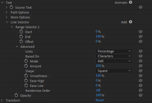

I would like to add basic opacity text animator to text layer through scripting and change its attributes.
I am looking for access mainly for:
Start
End
Offset
Units
Based on
Mode
Opacity
What I got so far. I am able to create animator with text selector:
var animator = newLayer.Text.Animators.addProperty("ADBE Text Animator");
animator.name = "Line Selector";
var opacityAnimator = animator.property("ADBE Text Animator Properties").addProperty("ADBE Text Opacity");
var selector = animator.property("ADBE Text Selectors").addProperty("ADBE Text Selector");
I can access and change most of the settings like this:
selector.property("Offset").setValue(1);
selector.property("Advanced").property("Mode").setValue(2);
However as soon as I change the units to Index from percentage like this:
selector.property("Advanced").property("Units").setValue(2);
I lose all control over selector. I can no longer change anything.
If I again use something like:
selector.property("Start").setValue(100);
or
selector.property("ADBE Text Index Start").setValue(100);
it does nothing.
Also i was not able to find a way to change the Opacity of the animator whatsoever. Even before the "units" change. Not sure what is the correct syntax there.
Thanks for your help,
Martin

Adress the properties by their relative property indices instead of the UI name. Your script simply locks up because the property names are no longer valid after your changes. If you wanted to stick with using the named properties, your code would have to have provision to check for those things and adapt accordingly, i.e. you would need to branch with conditionals.
Mylenium
Jan 4, 2022 11:34 AM UTC
Hi Mylenium,
Thank you for your answer. When working with indices I can access everything now.
I was able to access everything like this:
newLayer.text.animator(m).selector(1).property("Advanced").property("Based On").setValue(4);
However I have still struggled with Start/End and Opacity. I though these should work, but neither did.
newLayer.text.animator(m).selector(1).property("End").setValue(4);
newLayer.text.animator(m).selector(1).property("ADBE Text Index End").setValue(4);
I was able to find different syntax which finally worked, if someone will have the same trouble:
//Start to 0
newLayer.property("ADBE Text Properties").property("ADBE Text Animators").property(m).property("ADBE Text Selectors").property(1).property("ADBE Text Index Start").setValue(0);
//End to 1
newLayer.property("ADBE Text Properties").property("ADBE Text Animators").property(m).property("ADBE Text Selectors").property(1).property("ADBE Text Index End").setValue(1);
//Opacity to 0
newLayer.property("ADBE Text Properties").property("ADBE Text Animators").property(m).property("ADBE Text Animator Properties").property("ADBE Text Opacity").setValue(0);
Now I have one hopefully final question. Now I am addressing the animator with index "m", because I know I have only one animator on layer. But in the case there will be multiple. How can I check for the index of a animator i have just created with  var animator = newLayer.Text.Animators.addProperty("ADBE Text Animator"); ?
