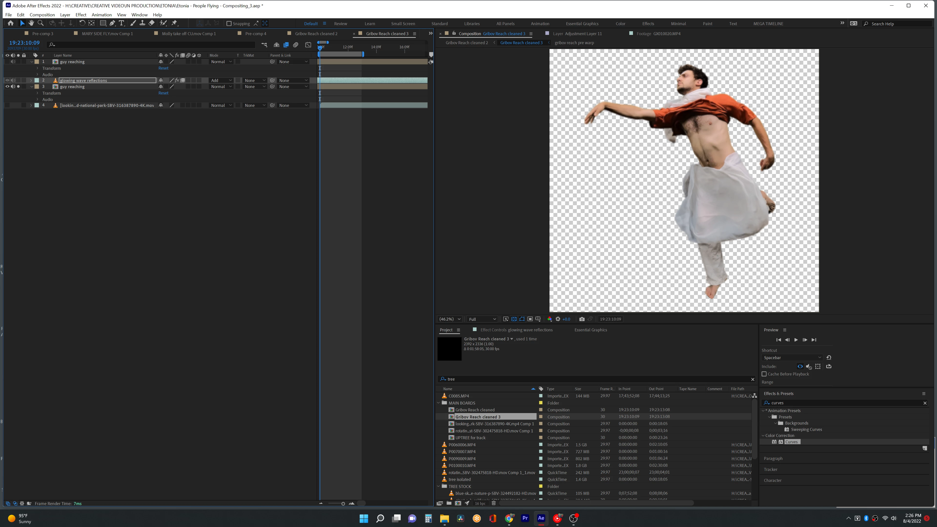

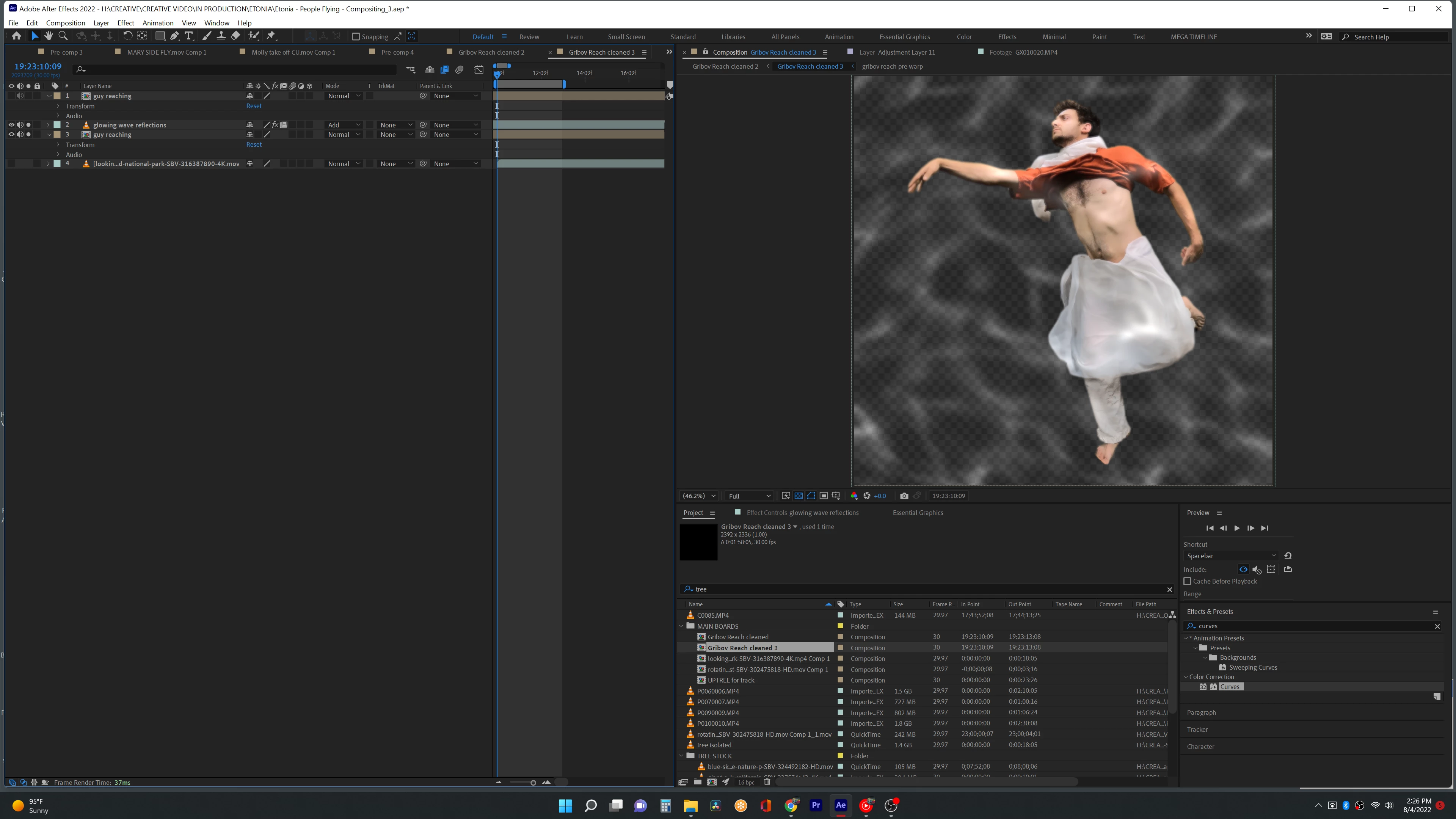

I want to add wavy glowing lines to my character who is keyed out.  I place my black and white wavy lines video over my character clip and change the blending mode to "add". It works of course, but the black areas of the wavy lines clip still exist since I have no background and it doesn't know what to "add" to over transparent areas.  So I try two methods to make the wavy lines alpha match my character:
1. Preserve underlaying alpha
2. Duplicate character layer, place it above wavy lines clip and use duplicate as an alpha matte for wavy lines.

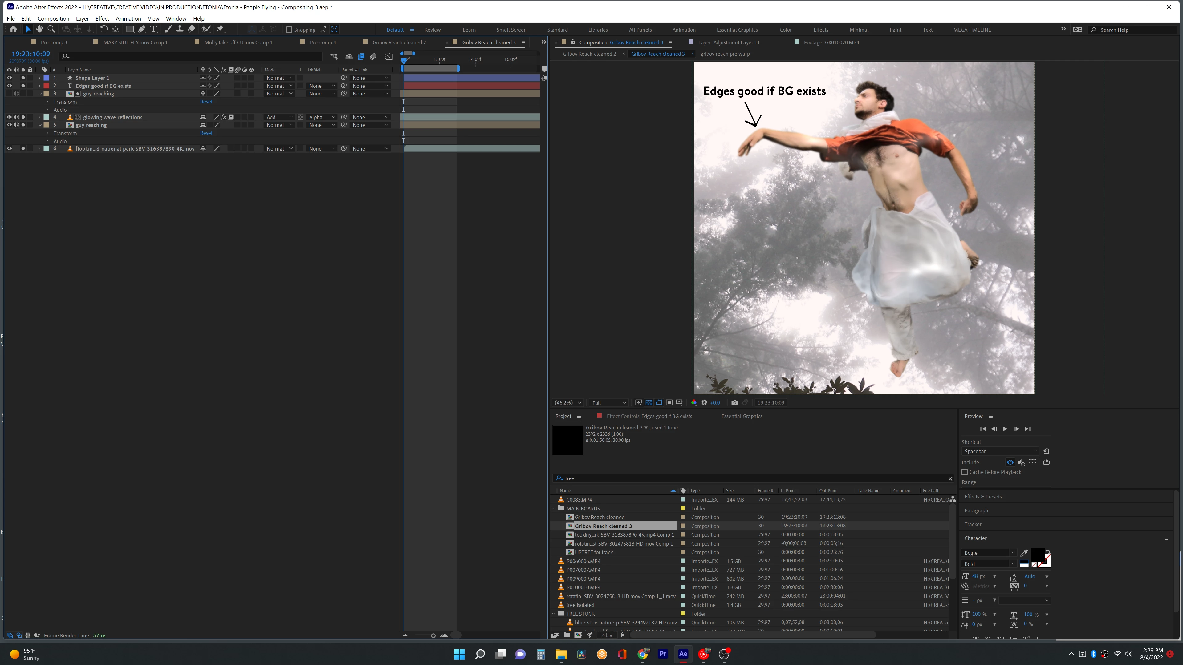

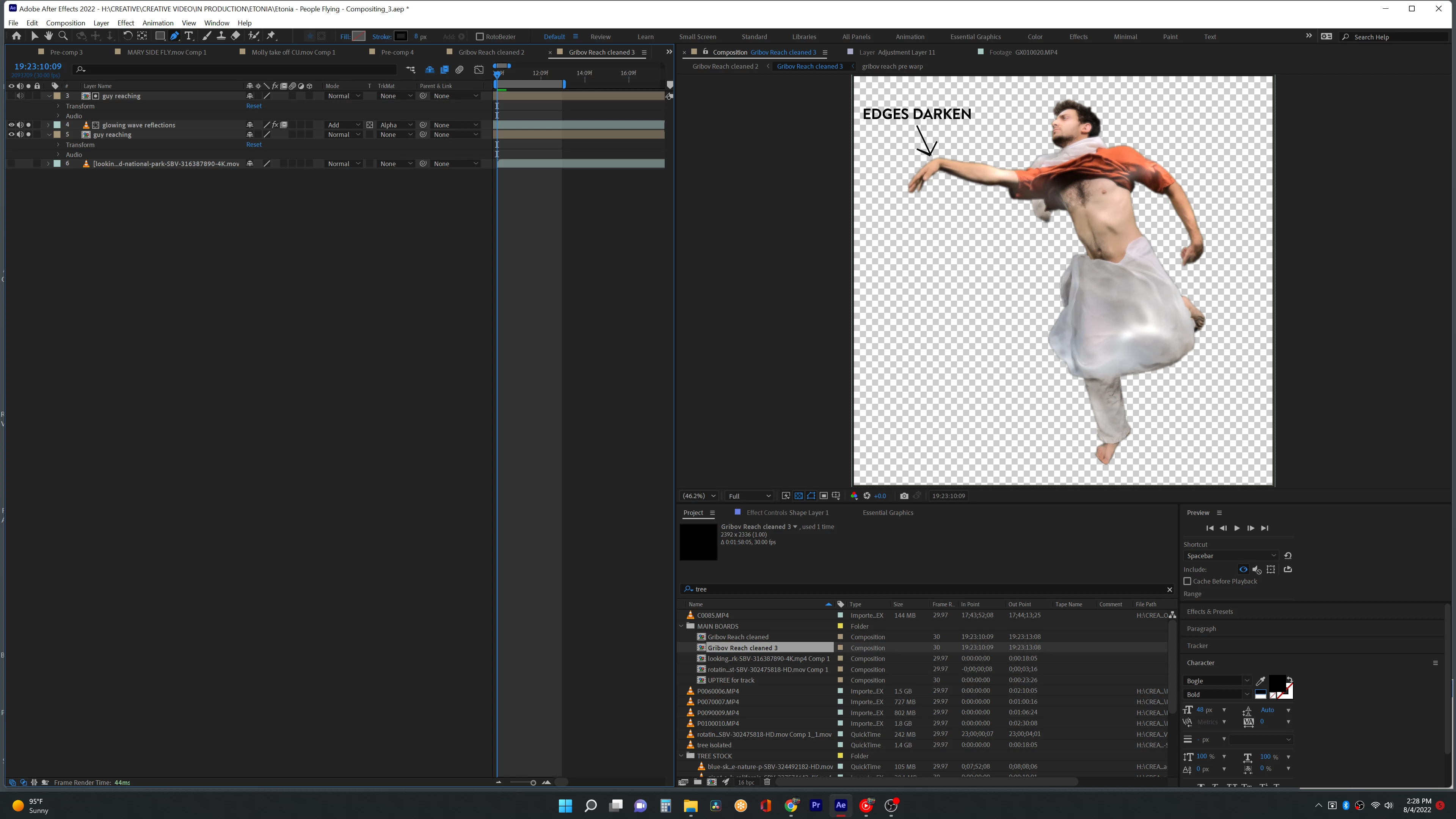

In both cases what I end up with are darkened edges around my character as long as there is still no BG layer.  Once a BG layer is added underneath things work fine and edges look great.
I would ideally like to export an alpha transparent video of my character with the glowing lines and no BG without the weird dark edges.

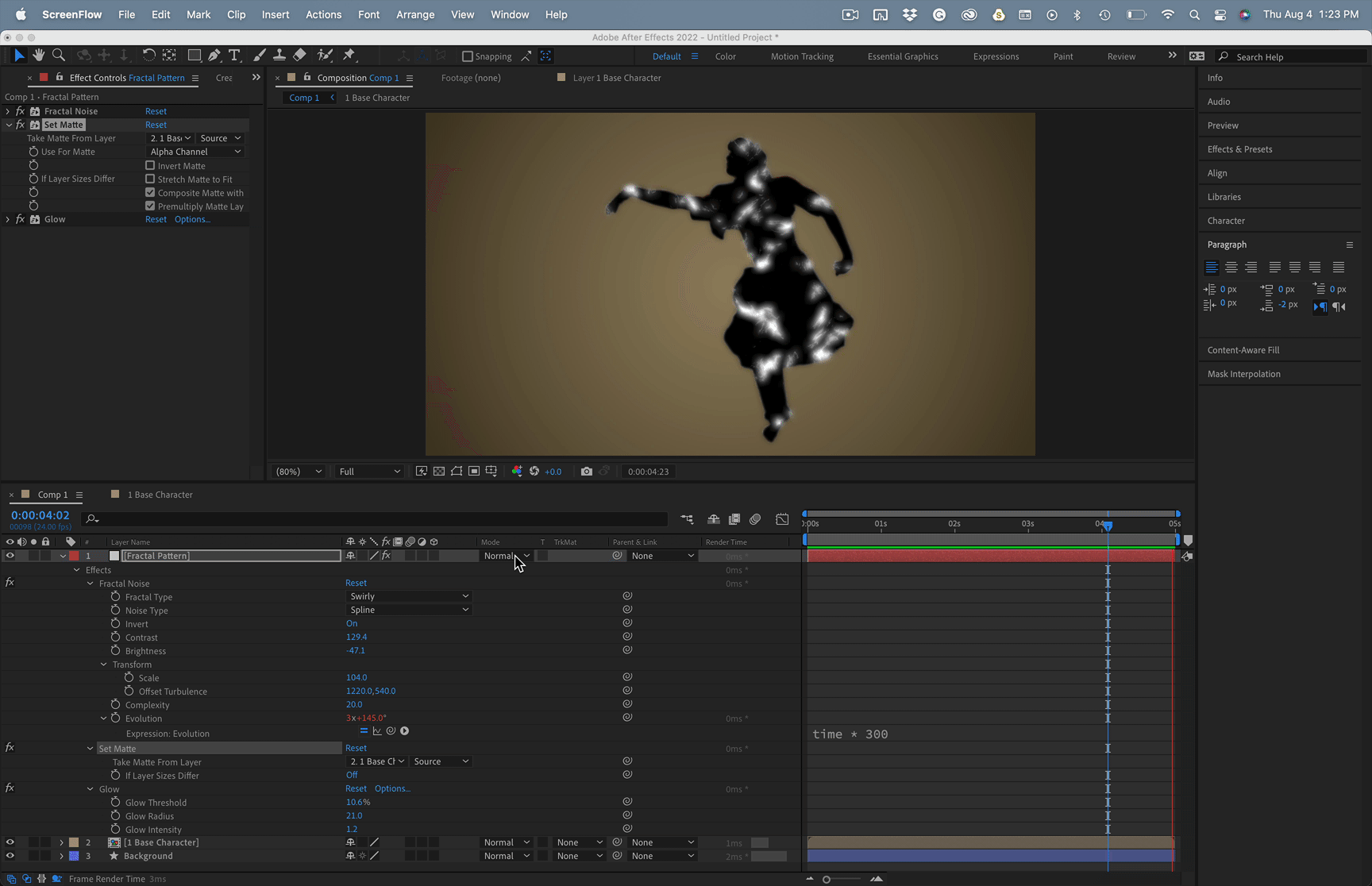

I took your actor image, did a quick manual roto to remove the background, and got this in about 5 minutes. Even though the screenshot was pretty low rez, I could see that the keying or roto you did on the actor needs a little work to improve the edges and give it some light wrap. I think that's where your dark edges are coming from.
I uploaded the project file if you want to take a look. Glow was added after Set Matte so it would wrap around the actor outside the matte.

I appreciate your time and help. I downloaded your project file.  While it looks fine with the background, as soon as I turn that off, we see those dark edges around the character still.  I turned off the glow effect which was a real offender but even without it there are still darkened edges when over transparency vs bright edges of the character when soloed.
I also tried the suggested solution of using a separate copy of the character for the matte layer and adding a matte choker to that to trim back the alpha.  While this technically works it's not perfect as there is always either a little too much choking (causing the effect to not truly reach the edges of the layer) or too little choking causing the slightest darkening of edges.
