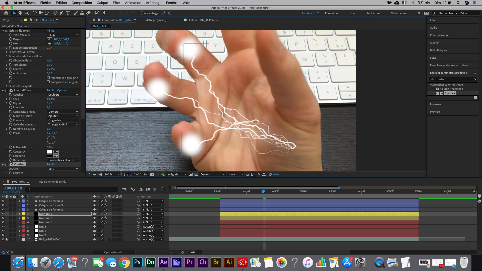

Hello everybody. I would like to know why i can't add any effects on a my nul layer after this one was made for a tracking movement. I mean, before the tracking, i can add effect on the layer like curves or something else but after that the nul layer is tracked and everything, nothing happen when i apply a effects.

I am assuming that Layer 4 (selected) in your screenshot is a comp sized solid that is the child of Layer 7, a null that was attached to one of the fingers by using AE's motion tracker. It looks like you have Advanced Lightning, then Glow, then Curves applied and you are trying to adjust the Green Channel.
If you create a new comp, add a solid, then apply all three of those effects in order and leave them all at their default settings you should be able to grab the green curve and make changes to the image. If that test works then reset all of the Effects applied to Layer 4 and see if that works. If it does, then one of the settings in one of the effects you added is wrong. If that test does not work then check GPU settings in the Project Panel. If you still can't figure it out we need more info.
You can find everything that was changed in layer 4 by selecting the layer and pressing the U key twice. This will let you see every change you made in the timeline so you can start resetting the controls there to figure out which one is causing the problem.

alright so what i have done it's like you said. i made a new comp then put all the effects on the solid and everything work. i try to do the same thing on the principale comp and it work. it seem that if i parent the solid with only the lithgning effect and then try to put the curve it doesn't work.

hello ! thanks you for your time you hava taken. I just follow a tutorial on youtube and i make what he does exactly step by step. But when i want to apply my curves effect on my lightning effect, nothing happen. my glow effect is working but not my curves. i have all the panel like he have and everything. I sen you a screen shot and maybe you can tell me what is the problem. I have the same workflow that he have.
