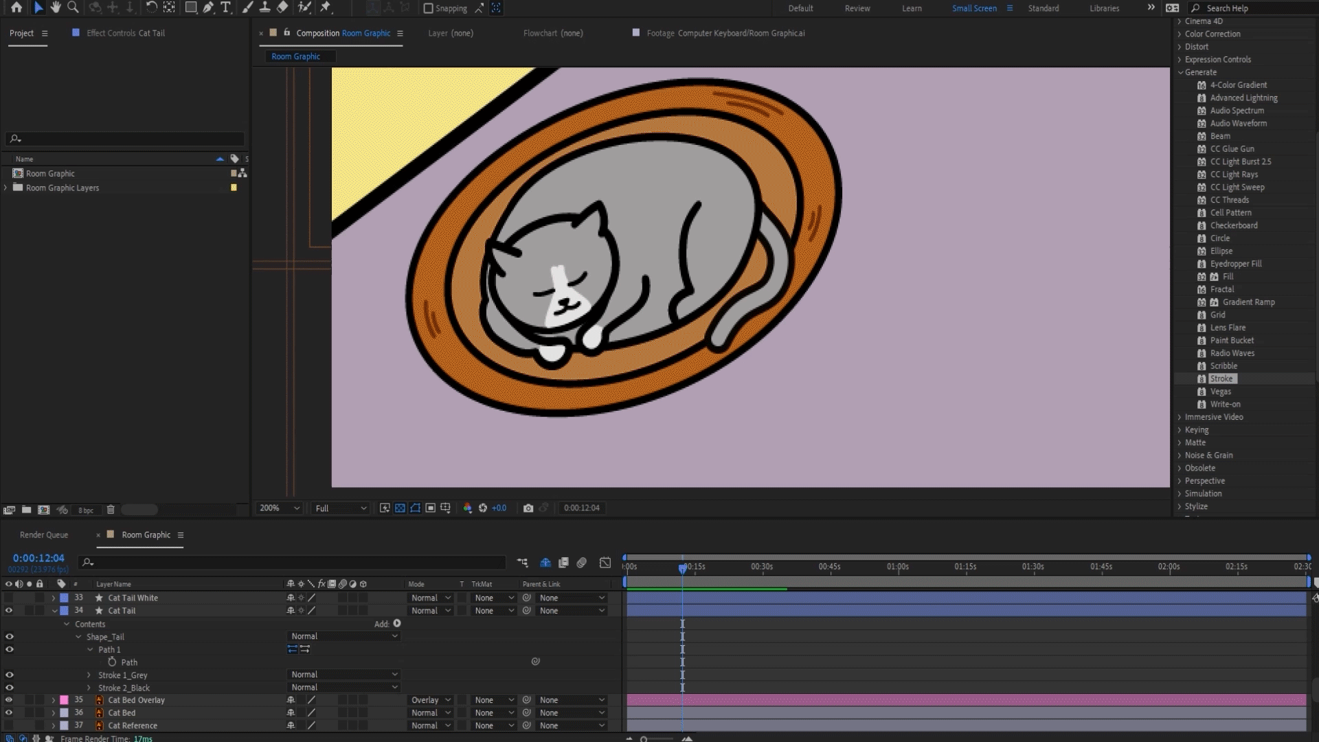

I have a shape that is a path made up of two strokes, one for the grey tail and one for the tail's outline.
I'm trying to make the end of the tail white, which would be easy enough if I just created another shape.
However, I need the white part to move along with everything else as I animate the anchor points and handles, as if it were part of the same shape.
Does anyone have any suggestions on how best to do this? Thanks!

anthonyv6747104
July 4, 2022
Here's a GIF of my workspace
