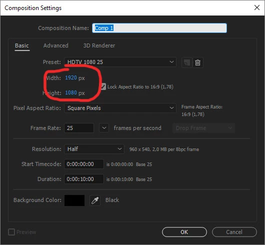

    After last update I have the same problem. OS Windows 10 64-bit, After Effects 2017.0 (version 14.0.0.207), Media Encoder 2017.0, Build 11.0.0.131
    I create Composition (for example 1920x1080)

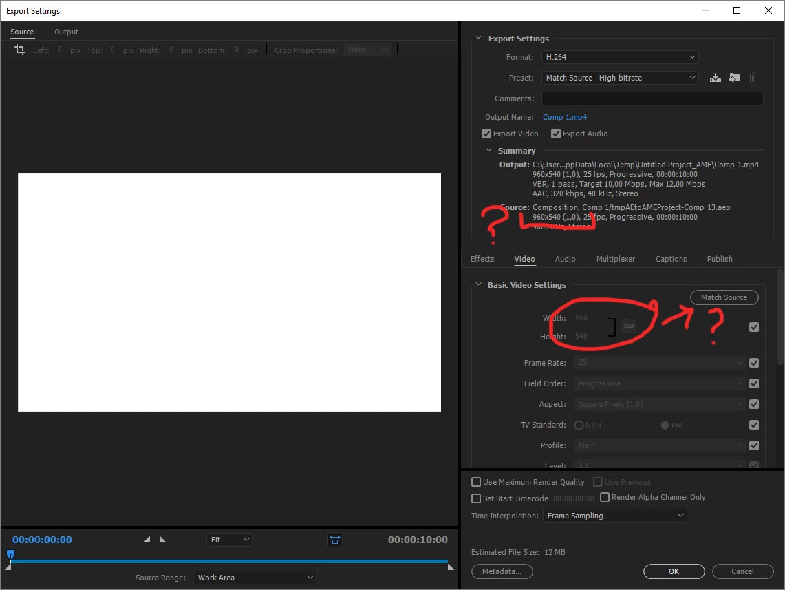

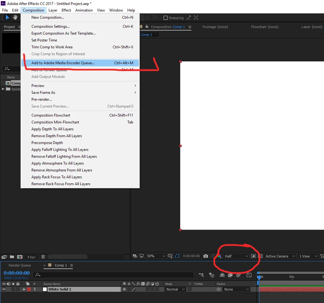

    If I send compostion to Media Encoder  with prevew resolution is not "Full" (for example "half")  in After Effects - Media Encoder render it  960 x 540 (not 1920x1080)
    It renders with bad quality and wrong resolution and no way to change it in Encoder  . Previous version does not have this problem, but now it is  a big waste of time.

    I tested this in my system and indeed there appears to be a bug when using ADD to AME Queue where it gets the resolution from your resolution pop up window. changing it manually won't help as it will upscale a downgraded image. a workaround could be setting the composition resolution pop up to Full before using Add to AME Queue, or use Queue in AME. any reason you are using ADD to AME Queue and not Queue in AME which is a superior method of sending your comps to AME and keep your render settings?  try it
