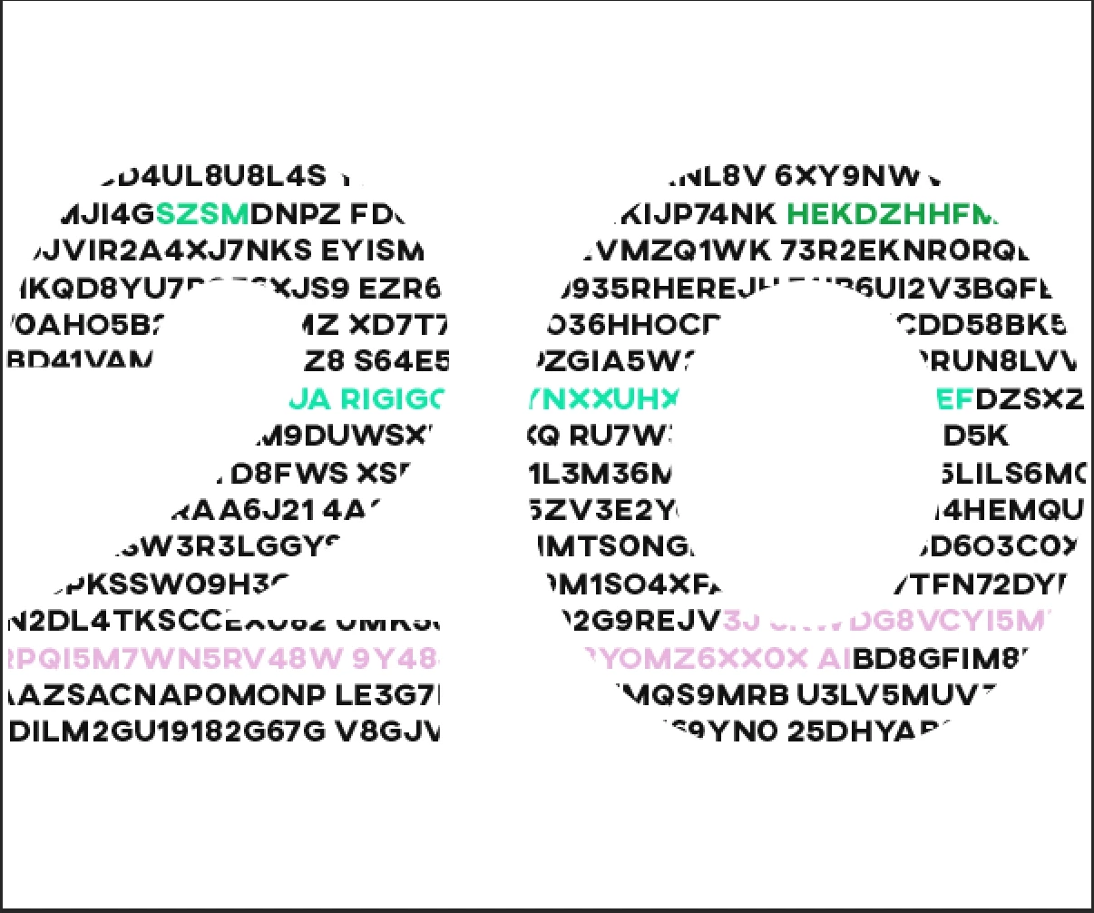

Hi all,
I have a shape layer made out of the digits 2 and 0, filled with smaller letters and numbers.
The entire shape layer consists of over 1000 groups (each with path and fills) and the smaller numbers/letters need to make up the the bigger numbers randomly.
So, it should work as follows:
1. Transparent BG
2. first few small numbers/letters appear with increasing transparency
3. more numbers/letters appear
4. the rest of the numbers/letters appear to finally fill out the entire shape
See rough mockup of the resulting shape:
My problem is that I don't know how to randomly select groups within a shape layer and then address each of their opacity to go from 0 to 100.
I am okish in After Effects but have hardly any experience with using expressions so any pointers would be greatly appreciated!
Thanks a lot,
Juliet

Thanks, after a bit more thought I do get how the expression leads to that exact outcome, I was just wondering as Dan has said I shouldn't have to split up each shape group into its own layer.
The random preset for letters and numbers would work but unfortunately the client needs that exact sequence of numbers and letters.
I think I won't be able to get around re-creating it in Illustrator and putting each number/letter sequence onto its own layer.
Thanks for your help.
Juliet
