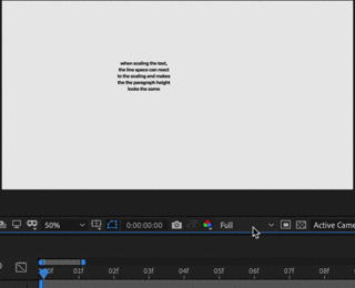

Hi, I need some help here..
I have an expression on the scale using SourceRectAtTime.width to look at the width of a text layer, so the text layer resizes itself when it goes over certain width.
At the same time I put another expression on the line space; so when the scale expression scales down the layer, it will increase the line spacing to make the height visually remain the same.
TextHeight=sourceRectAtTime(time,false).height;
BeforeHeight=TextHeight;
AfterHeight=TextHeight*scale[1]/100;
LineSpace=(BeforeHeight-AfterHeight)/4*100/scale[1];
[value[0],LineSpace]
I realize the preview won’t update until I change the sample resolution, and it goes back too if I change the sample resolution back to the one when I typed in the text. I guess it’s because it calculates the target line space based on the layer height, but when it increases the line space, it also alter the layer height, so the cache just messed up.
Is my assumption correct? If it is, I am wondering if there’s a way to fix this, or maybe at least a way to easily refresh the cache everytime I finish typing? (I tried Edit>Purge>Image Cache Memory, which works for the first time, but never work again after that…)
Any help will be greatly appreciate!

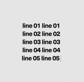

Thank you for the help! And here is more detail of what I am trying to achieve:
I have applied the following expression to the scale of a regular Point Text layer, so when the content you type in is larger then 500 pixels, it will scaling down the layer so it won’t exceed 500 pixels
s=thisLayer;
scl=500;
x=s.sourceRectAtTime(time,false).width;
if (x>scl)
{[scl/x*value[0],scl/x*value[1]]}
else
{value}
It’s working pretty nice.

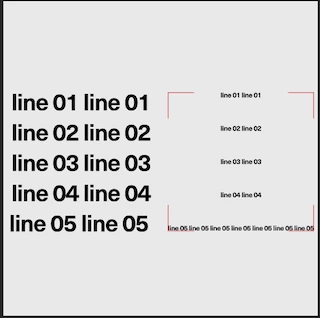

But when I input line return to the text: since the expression scales the whole layer, including the vertical scale, it’s not visually what I want:
I hope to keep the line spacing between lines visually the same even after the scale expression scales down the whole layer:
So I developed the following expression, and put on the line space
This expression kind of works when I change the preview resolution to force the preview refresh, or use Edit>Purge>Image Cache Memory, but sometimes both ways won’t work
I assume the reason is because the line space expression makes it react to the layer height, but when the line spacing increases, the layer height will also increase, then the expression will make the line space to react to that… which creates a “loop” and confuses the AE.
If that’s the case, I am wondering if that’s other way to achieve the line spacing purpose without creating that “loop”, or maybe an better/ easier way to force refresh the preview so it can work every time? Greatly apprecaite for the help!
Attached with the AE file to better illustrate the situation:
https://www.dropbox.com/s/k8fbfsnxmgfuyrp/LineSpaceReactToScaling_Sample.aep?dl=0
