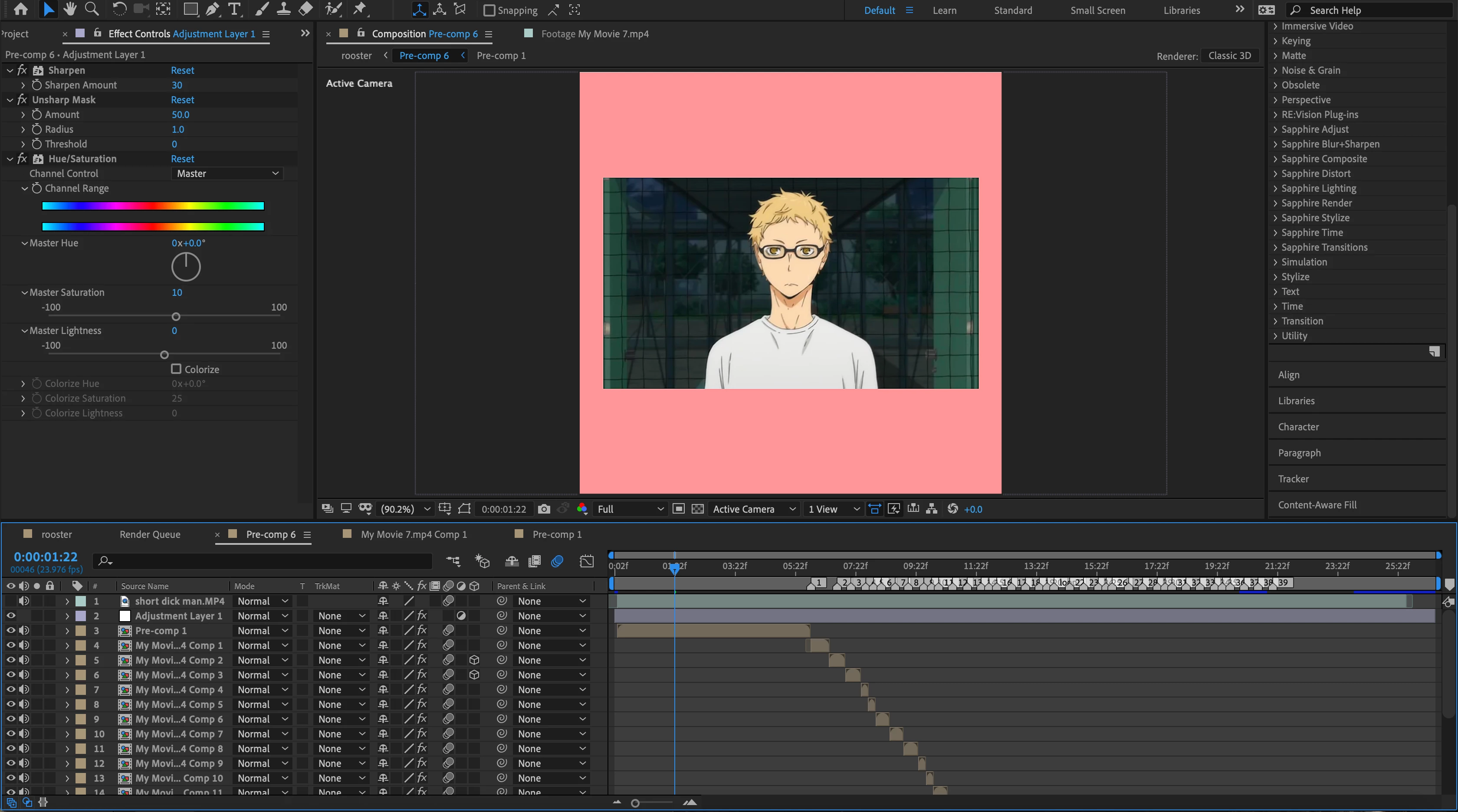

Adjustment Layer Not Rendering
I have tried:
- adding an adjustment layet over all layers, whether they are pre compostions or clips (as shown in the screenshot)
- adding the effects (sharpen, unsharp mask, saturation) straight to the clips or pre compositions
- adding the adjustment layer inside all the individual pre compositions
But, no matter what, I cannot get the effects to take effect when the video is rendered.

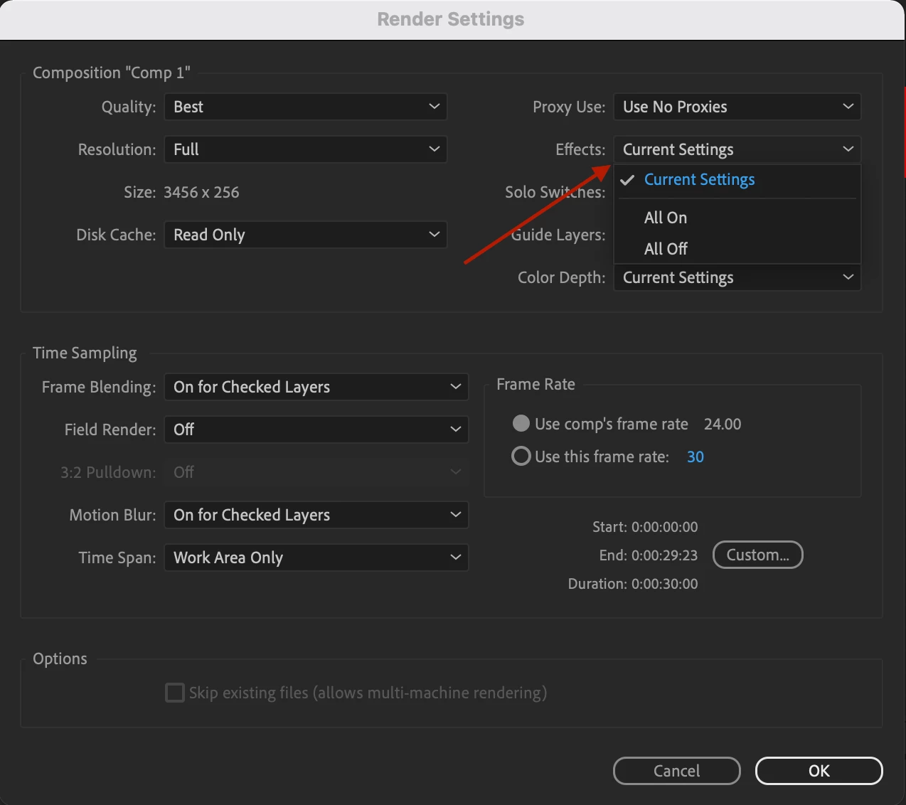

does this issue come with the adjustment layer only or all effects overall not showing in the render?
anyway be sure you set the effects settings to current settings from the render settings
