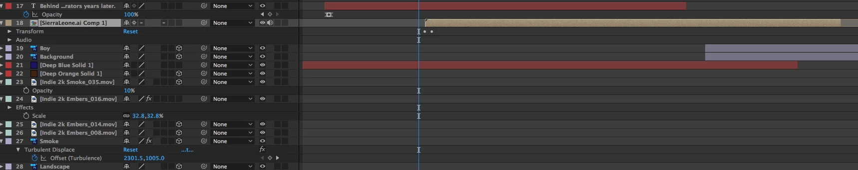

Hey guys,
I have an adjustment layer within a pre comp, but for some reason, it's affect layers outside of the pre comp, that are located below the pre comp.
Here's a screengrab. The adjustment is in that pre comp. but it's affecting the layers below. Anyway to stop this?
Correct answer Szalam
In the main comp, turn off the "collapse transformations" switch for the precomp.

SzalamCommunity ExpertCorrect answer
December 15, 2016
