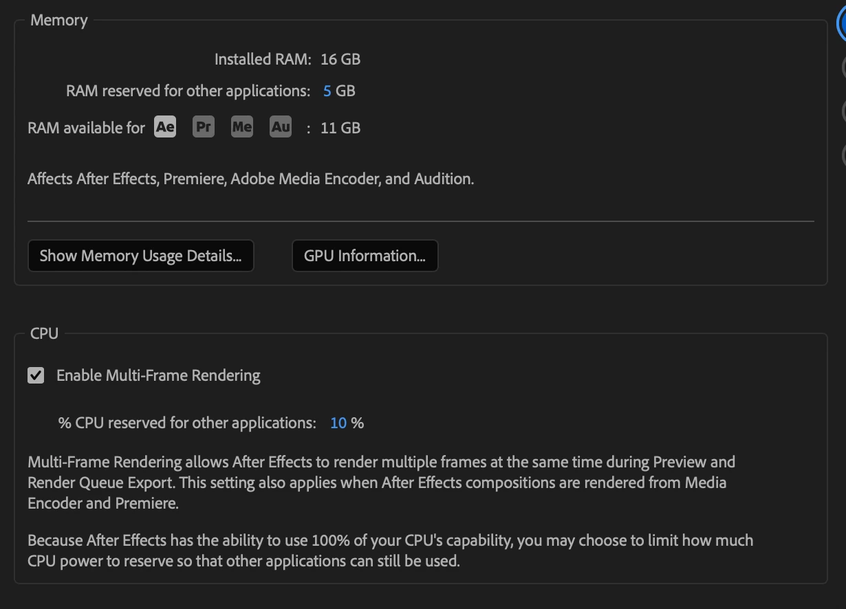

AE Version: 26.05.0 (Build 89)
I’m not sure exactly what you want to know regarding ‘system specs’ so i’ll just attach an image of what shows in settings.
Running in safe mode didnt seem to make any difference.
After submitting this question I did notice that when I have a clip selected on the timeline, pressing space bar enables the hand tool rather than playing the preview. However it selects the hand tool, buffers and then glitches back to the selection tool after a few seconds. If I use the spacebar shortcut without any clips selected it does play the preview but this only works 2/5 times without buffering.
