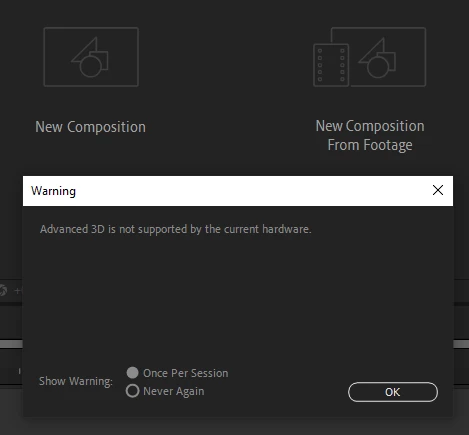

Advanced 3D is not supported by the current hardware
I have this error when I installed the beta featuring the new 3d rendering. My specs are GPU: Nvidia GeForce RTX 4070 Ti and I have already updated my GPU drivers. (I installed the Pilot Studio Ready and Game Ready Pilot given by Nvidia). I am on windows 11 of course.
Could someone enlighten me ?

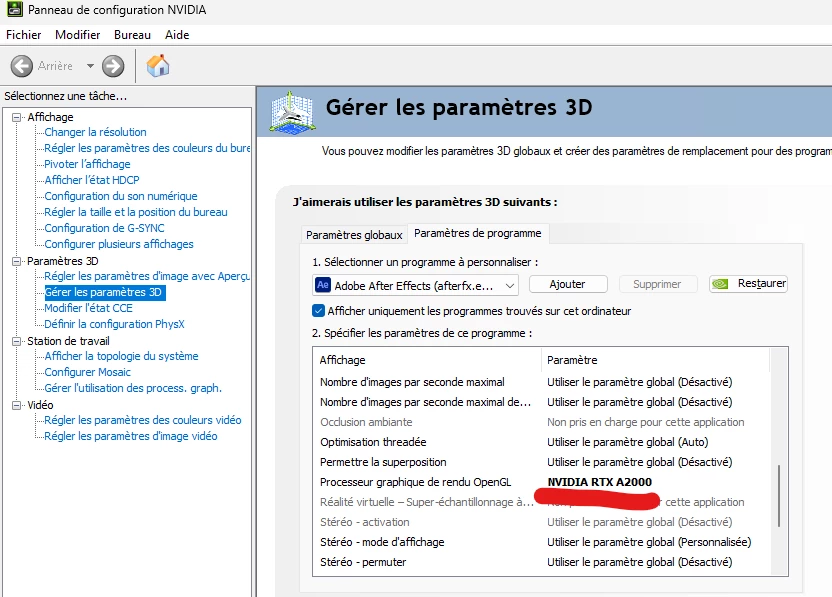

Hi all !
Easy 1 minute Fix for NVIDIA USER :
I got the same issue (pop up message "Anas341554791mtr") and after checking which GPU was identify, it was my Intel one and not my Nvidia RTX.
To force  and fix :
Just OPEN Nvidia PANEL-> 3D manager -> software setting -> select AFTER EFFECT then FORCE the graphic proc to your DEDICATED GPU, it's done.
if not, try a reboot.
this solve my issue.

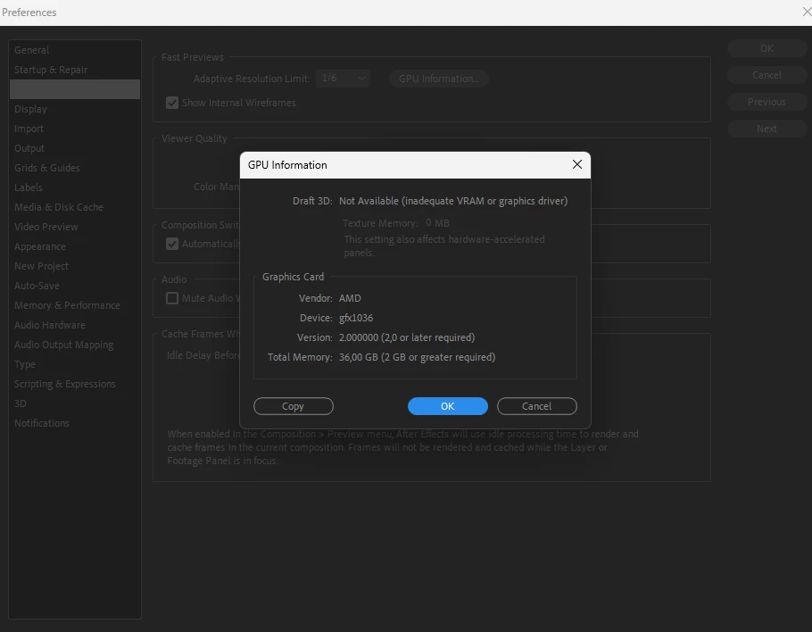

Dec 11, 2023 4:11 PM UTC
At this time, no way to specificy which GPU, AE will generally pick up the first GPU it finds and use that. Can you disable the card and test to see if that gets Advanced 3D working?
Dec 9, 2023 6:54 PM UTC
After some personal research , the further I have managed to try to solve the problem is this window
It is now 100% certain that the AMD is being picked up. However there do not seem to be a window where the picked GPU can be altered (as far as I was able to reach ofc). Are there some internal files that needs to be altered in order for it to happen?

Dec 9, 2023 6:17 PM UTC
Yes I do indeed! AE is probably picking up the AMD Radeon.
Is there a way for me to switch GPU's in After Effects?

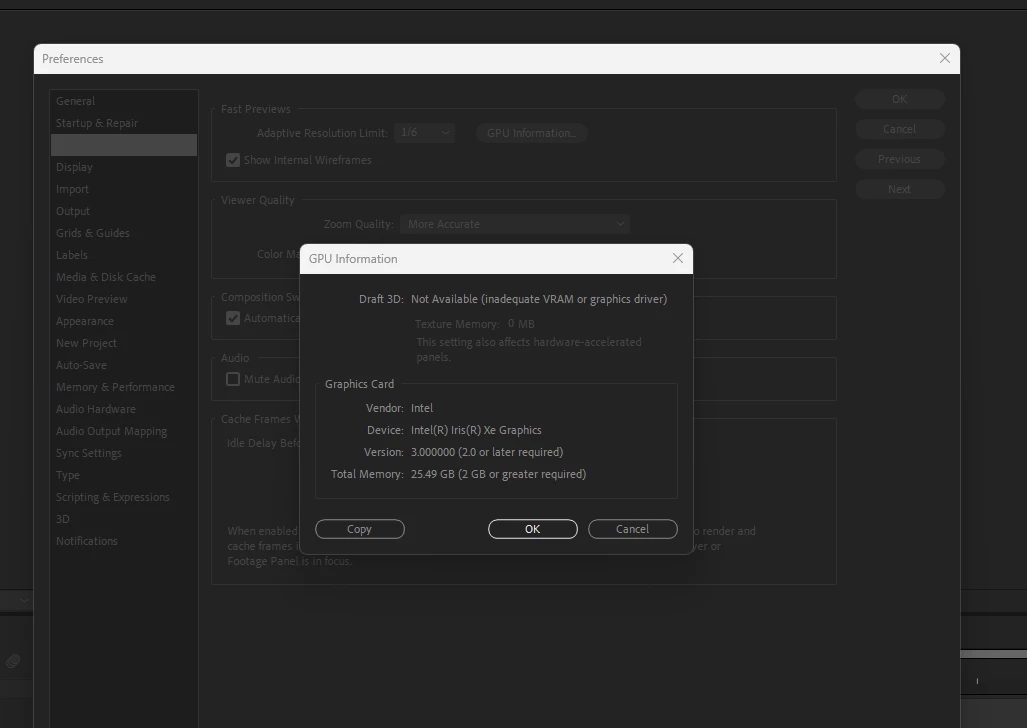

Dec 9, 2023 5:02 PM UTC
Do you have an intel integrated GPU by any chance? We are working on updating the message to help further, but in the mean time, I suspect you may have a second GPU that AE is picking up.
