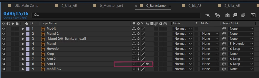

    I have narrowed it down:
    It is the comp "0_bankdame" in my "6_Ulla_AE" comp that makes playback unavailable.
    This happens, when I in 0_bankdame put rasterize on my "arm 1" layer (which already has "fx" (puppet tool)).
    So I guess, being totally ignorant, that rasterize on a fx layer is a big nogo at all times?

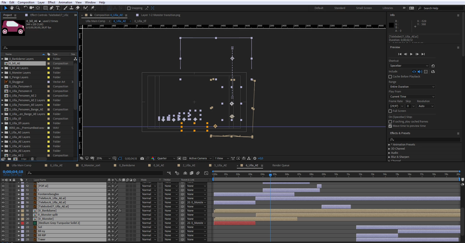

    November 28, 2018
    Don't know if this image gives any idea. When pulling the time indicator, I can see the bounding boxes move.
    Mohammad.Harb
    November 28, 2018
    Check the workarea  for that composition,
    a quick shortcut, press the home button then press B
    then press the End button then press N
