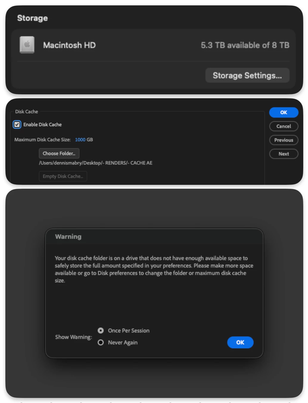

I ran into the same problem. MacBook Pro Tahoe 26.5.1 / AE 26.3.0. I’d worked on something where the files had used up most of the hard drive. After deleting those files, I was unable to avoid the disk space error -- despite the space showing up as available in Finder, etc.
The solution for me was to clear purgeable space on the hard drive. I used CleanMyMac, but there may be other ways to do this that are also safe (I’ve read that you want to be careful how you go about this on SSDs as clearing purgeable space in an ‘unsafe’ way disrupts TRIM functions, which help the longevity of your SSD.
I appreciate this may come across as an advert for some other software, but in my case, following the instructions in this post solved the problem:
https://macpaw.com/how-to/purgeable-space-on-macos

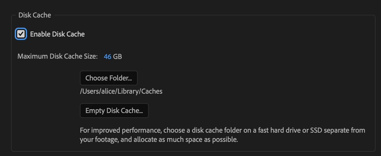

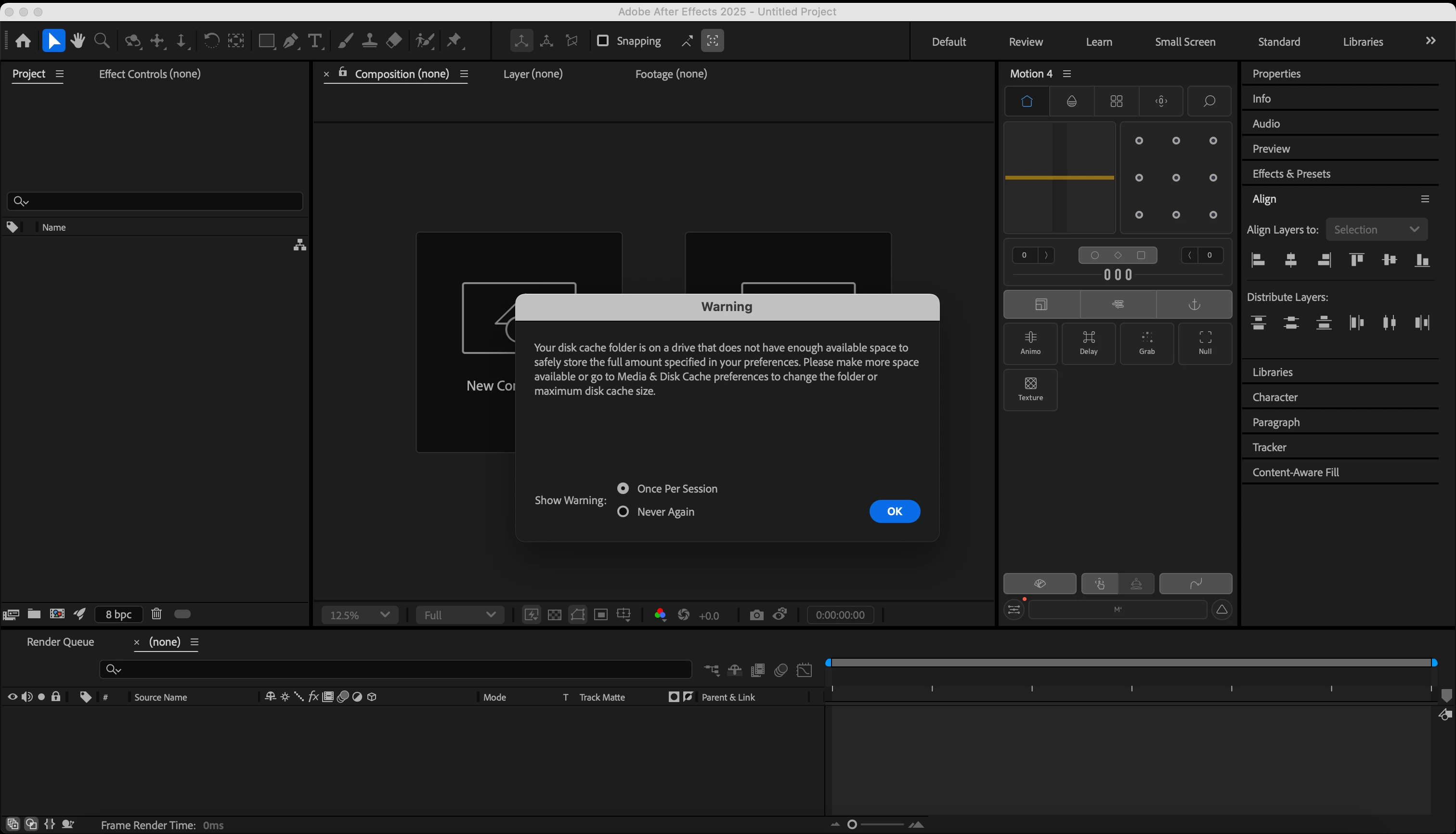

I'm having this exact same issue, started yesterday 14th March. My Mac has plenty of space and AE is up to date (25.1). I've cleared the cache, restarted my mac many times. I thought I'd over extended it with some large files, but it happens upon opening the program now. I've attached a screenshot of the message I get, and also screenshots to show the current cache size (46gb), I've also tried increasing and decreasing it and get the same message.
I haven't tried changing the location of the cache, but I don't have an external hard drive so I believe it wouldn't make any difference. The available space on my hard drive is 86.8gb.

Do you mind sharing a screenshot of the error for clarity? Is this happening with all the projects or a specific one? If with a specific project, is it a template? In which version of After Effects it was created?
