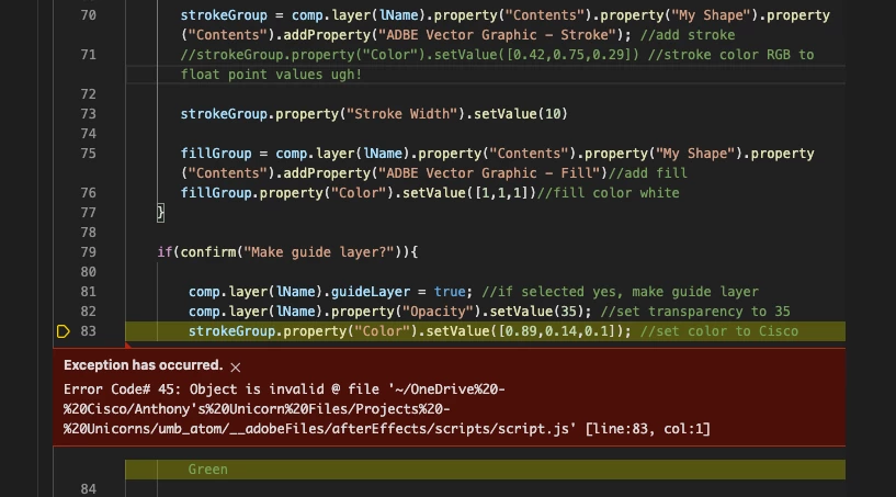

Everytime I set the stroke within the guideLayer IF statement, I get the error in the attached screenshot. But the exact same strokeGroup line in the initial IF statement works like a charm. I don't get it, what am I doing wrong? I've acttached the script as a TXT file so you can see the entire script.

    if(confirm("Make guide layer?")){
        comp.layer(lName).guideLayer = true; //if selected yes, make guide layer
        comp.layer(lName).property("Opacity").setValue(35); //set transparency to 35
        strokeGroup.property("Color").setValue([0.89,0.14,0.1]); //set color to Cisco RED
        //THIS IS WHERE I GET THE ERROR
    } else {
        //user selected no for guide layer
        strokeGroup.property("Color").setValue([0.42,0.75,0.29]); //set color to Cisco Green

Outside the initial creation of the layer you lose the context of which layer you're actually on. You would need to reference the layer again explicitly or simply nest the guide function inside your other function.
