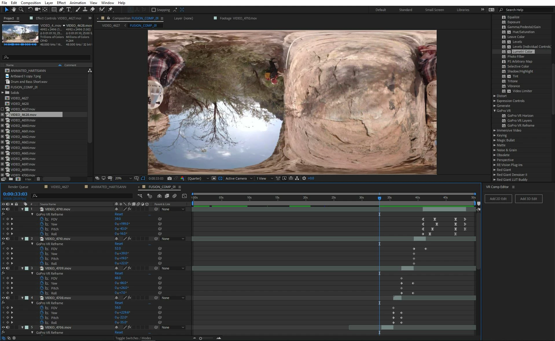

Hi all,
Thanks for your time. I'm working through a series of 360 projects at the moment and am having massive issues with the 'GoProVR Reframe' effect. Basically, when the effect is added, all video associated with that effect starts to glitch, jump around then eventually disappear all together.
I have attempted numerous fixes, keyframe removal, proxies and nothing fixes the issue apart from the complete removal of the effect.
Cheers

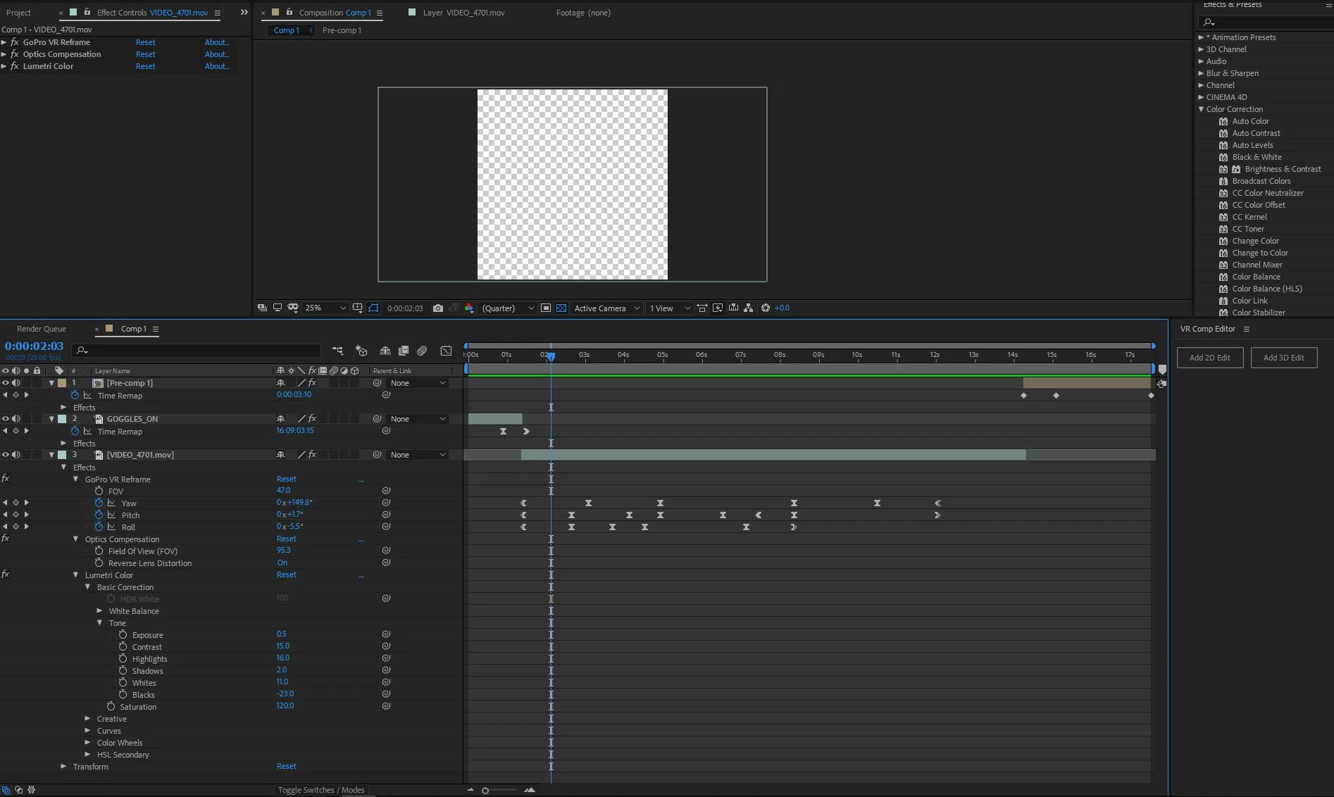

    To give some more insight. This issue seems to happen when adding any extra effect or even render and snowballs across the entire project. From here I usually remove all keyframes and any hint of the GoPro VR Reframe effect, clear all caches and turn the system on and off. However, sometimes even this doesn't help with the issue being reproduced when opening the project again.
    This time the problem occurred after rendering and the re-linking hirez footage from the proxy. Please find 2 separate projects with the same issue screengrabs
