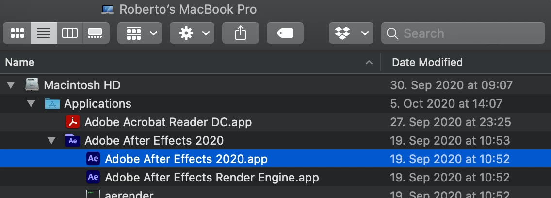

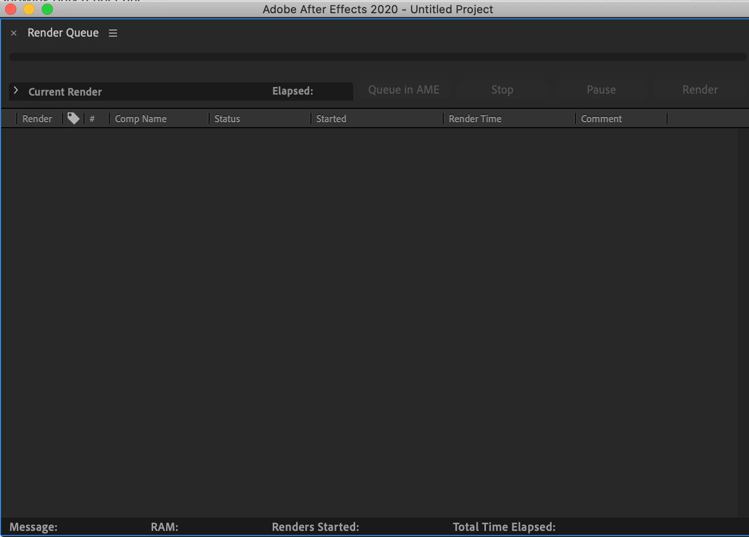

I am a mac user. When opening the adope after effects 2020.app I only see the render queue. I am not able to access any other menu.

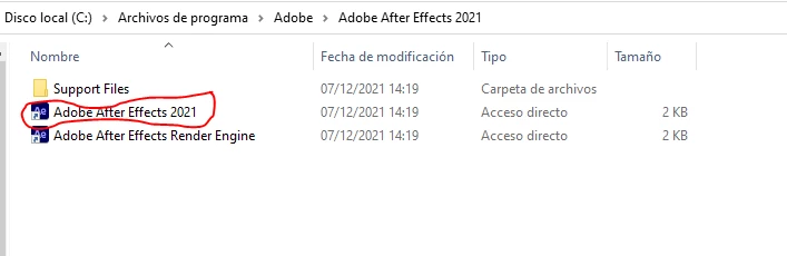

December 7, 2021
@RNaveiro lo que estás abriendo es un acceso directo (tiene una flechita en una esquina) que posiblemente esté mal direccionado, te sugiero buscar el .exe original y darle doble clic a ese, no al acceso directo.
Byron.
RNaveiroCorrect answer
December 7, 2021
Solved! Thanks @Byron Cortez   but it wasn't for the shortcut. That .txt was to blame. 2 copies are created in different places.
Two copies of this file are created: ae_render_only_node.txt
One in Documents and one in (C: \ Users \ Public \ Documents \ Adobe)
I have removed that one and now it does open normally.
You have to delete both files!
From the Render Boss support they have answered me to tell me that this file was probably missing to be deleted.
Support reply:
AE uses the render-only txt file only if the 'Render as Render-Only Node' option is selected (see screenshot below) which is meant for secondary machines that are not logged in with Adobe (that way, Adobe doesn't ask you to log in before every render).
Make sure this option is not enabled. If it is, disabled it and click OK, and that should remove the file. The next time you open AE, it should open as normal.
If you'd like to remove the file manually, you have to remove it from Documents as you did, but there's another copy at C: \ Users \ Public \ Documents \ Adobe
Thanks again and I hope I have helped.
All the best

No estás abriendo la aplicación como tal sino que has abierto el Render Engine. Intenta ir a Applications / Adobe After Effects 2020 y desde ahí ábrelo.
Byron.
December 7, 2021
Gracias por tu respuesta @Byron Cortez  Fue de las primeras cosas de las que me aseguré. Lo que está claro es que me abre siempre Render Engine. =(

October 9, 2020
Hi robertok77743852,
Sorry for your issue. That's not ideal.
Have you tried going to Window > Workspace > Reset "Workspace Name" to Saved Layout? If that doesn't help, try resetting the preferences of After Effects. Here's how: https://community.adobe.com/t5/after-effects/faq-how-to-reset-trash-preferences-in-after-effects/td-p/10634342?page=1
Let us know how it goes.
Nishu
