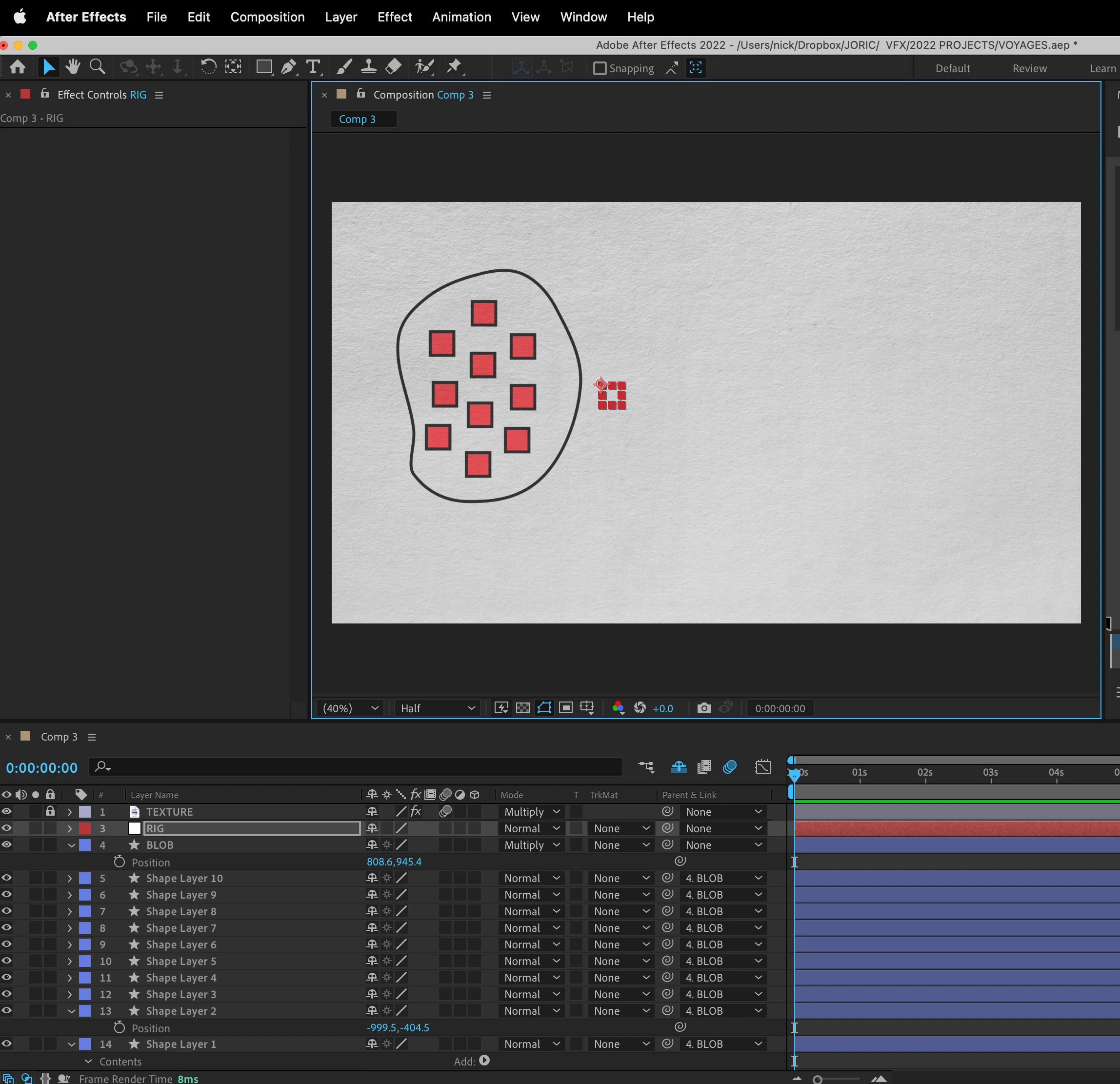

AE question: easiest way to make a group of objects move in a dynamic / fluid motion
  • June 12, 2022
  • 1 Antwort
  • 629 Ansichten
I'd like to move a group of layers/objects across a map fluidly/dynamically and I'm not sure whether to parent them to another shape layer or null so that the master shape layer or null pulls them across. But what I'd like to do is have the squares (in this example) move fluidly in the sense that they don't all take off and stop at once. I know I should use easy ease keyframes and perhaps stagger the 'square' layers. But I was wondering if there might be a better way to do this with expressions or a plugin perhaps? Thank you in advance for any helpful tips / suggestions.

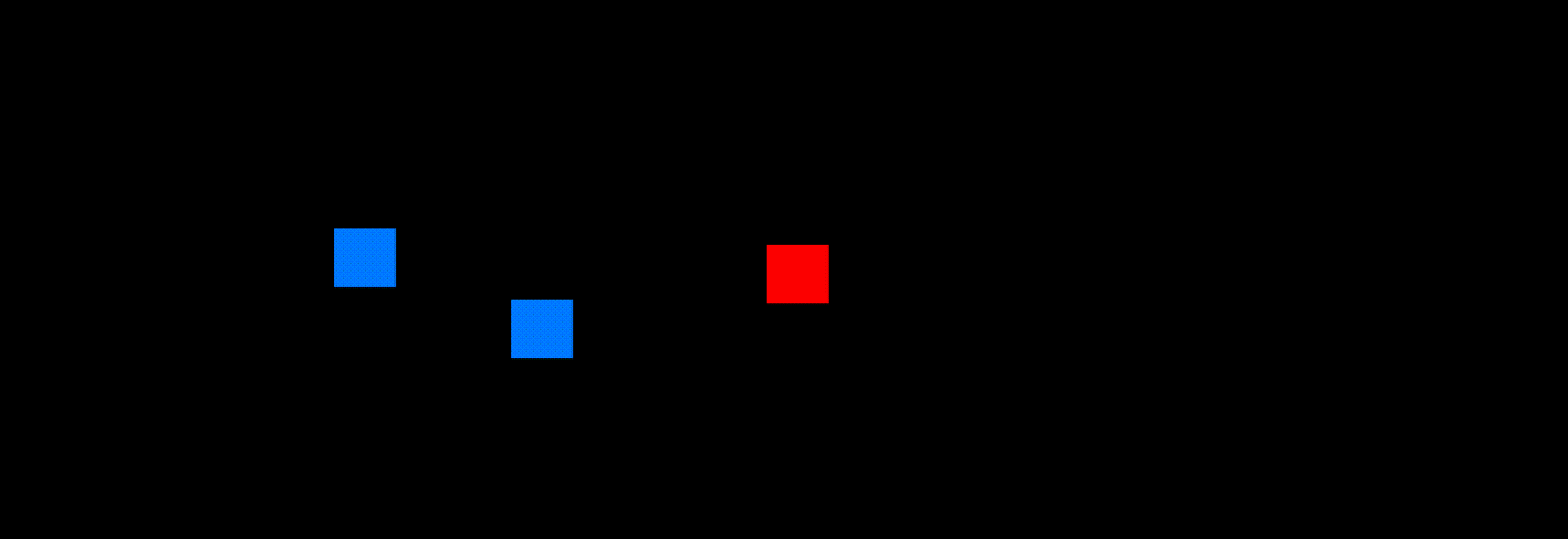

Add Time Displacement effect to your layers and assign the Time Displacement layer to your controller then give a different max displacement time to each layer. in this case your will get a random follow effect
OussK
June 12, 2022
You will get somthing like this

Hi OussK, thanks so much for your help and taking the time to put that example together. This is exactly what I'm trying to do. Thanks again, 😀🙏
