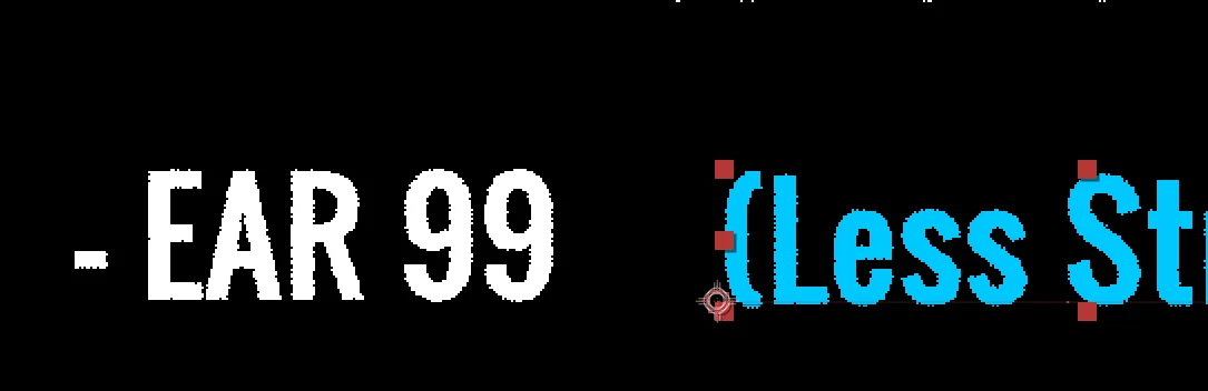

    ebisujack
    Jan 14, 2019 7:16 PM UTC
    I'm having the same problem. See below. For me, it's not an issue with zoom or resolution settings. I've had the same issue before in Illustrator and fixed it by turning off GPU performance. I can't figure out how to do the same thing in AE. If I go to File>Project Settings and try to change the Mercury GPU settings, this doens't do anything.
    Dave_LaRonde
    Jan 14, 2019 11:06 PM UTC
    It looks like you applied the Roughen Edges effect to the text layer.  True?
