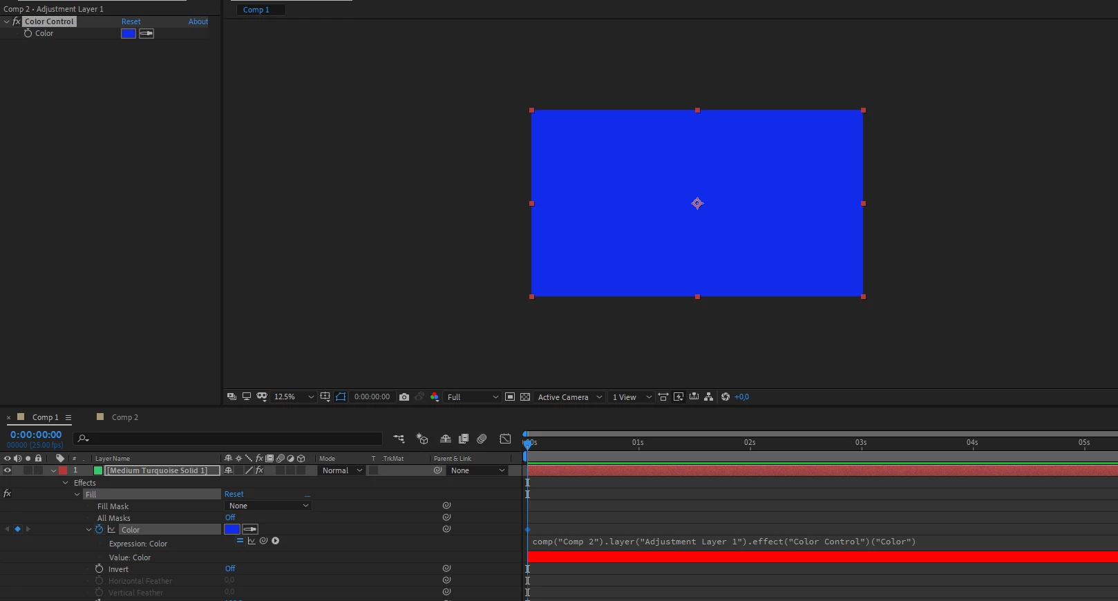

When I render my comp in AE everything goes fine, but as soon as I send the same comp to AME it renders without the color information from the "color control" layer.
This happens since I've updated to the latest version of AE and AME. Is this a bug or do I do something wrong?
I've created a new test file to see if the problem was inside my file or more general.  And apparently it's general :
inside AE  :

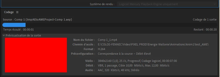

When rendered on AME my blue solid appears red :
Thanks forward for your help
