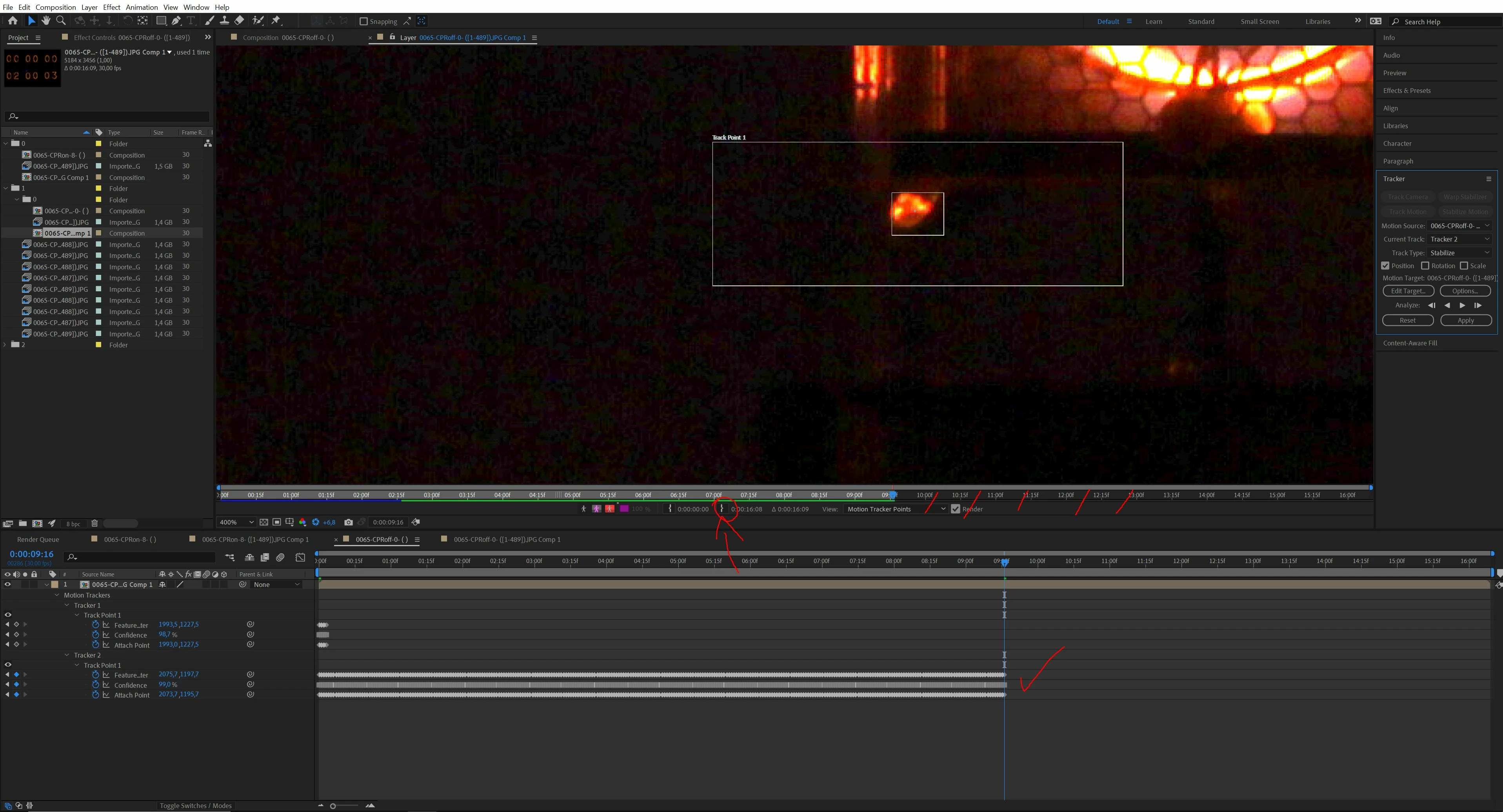

    What I found out to be working for me is:
    Once in the tracking viewport, right in the viewport, TRIM the duration of your clip and the tracker would stop automatically. Then you just expand it till you reach the end of your clip.
    Check the screenshot.
    Hope it works!

    Sep 2, 2021 2:01 AM UTC
    Bless you ! that method  worked for me .
