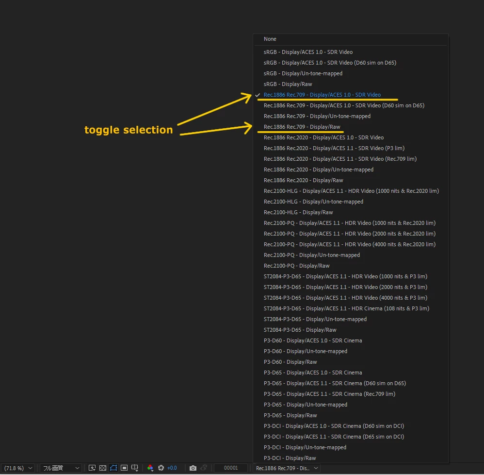

If you set the color engine to [OCIO] in After Effects 2024, you will be able to use [Display Color Space], but this [Display Color Space] cannot be assigned to shortcuts, etc.
Is there any way to toggle between color spaces A and B as shown in the image below?

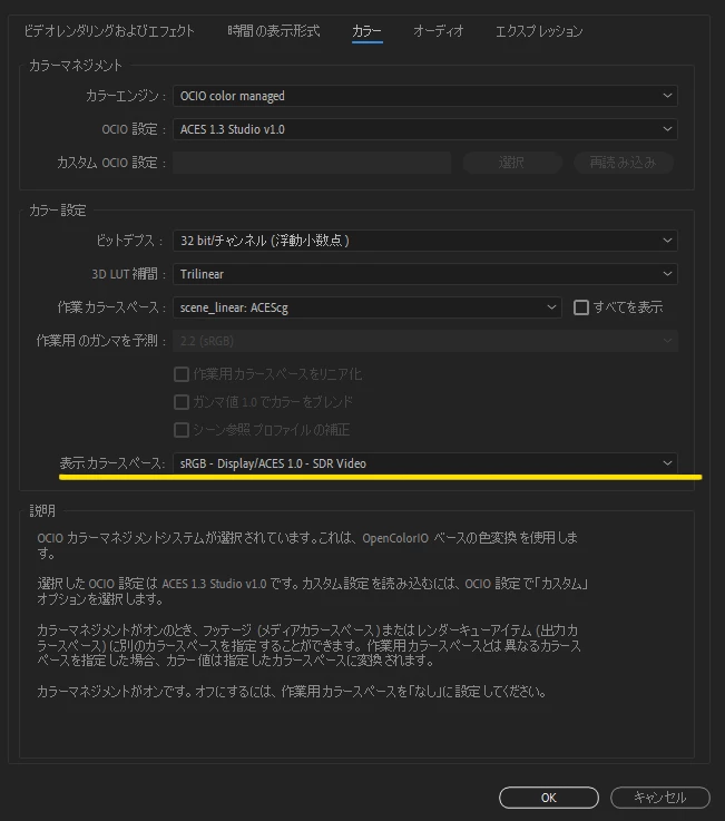

I'm not familiar with javascript, but the part I want to change is "Display Color Space".
Attached is an image of the project settings.
Or, if the "Display Color Space" can be changed using the javascript below, I would like to know if I should write the same.
app.project.workingSpace = "Rec.709 Gamma 2.4"
