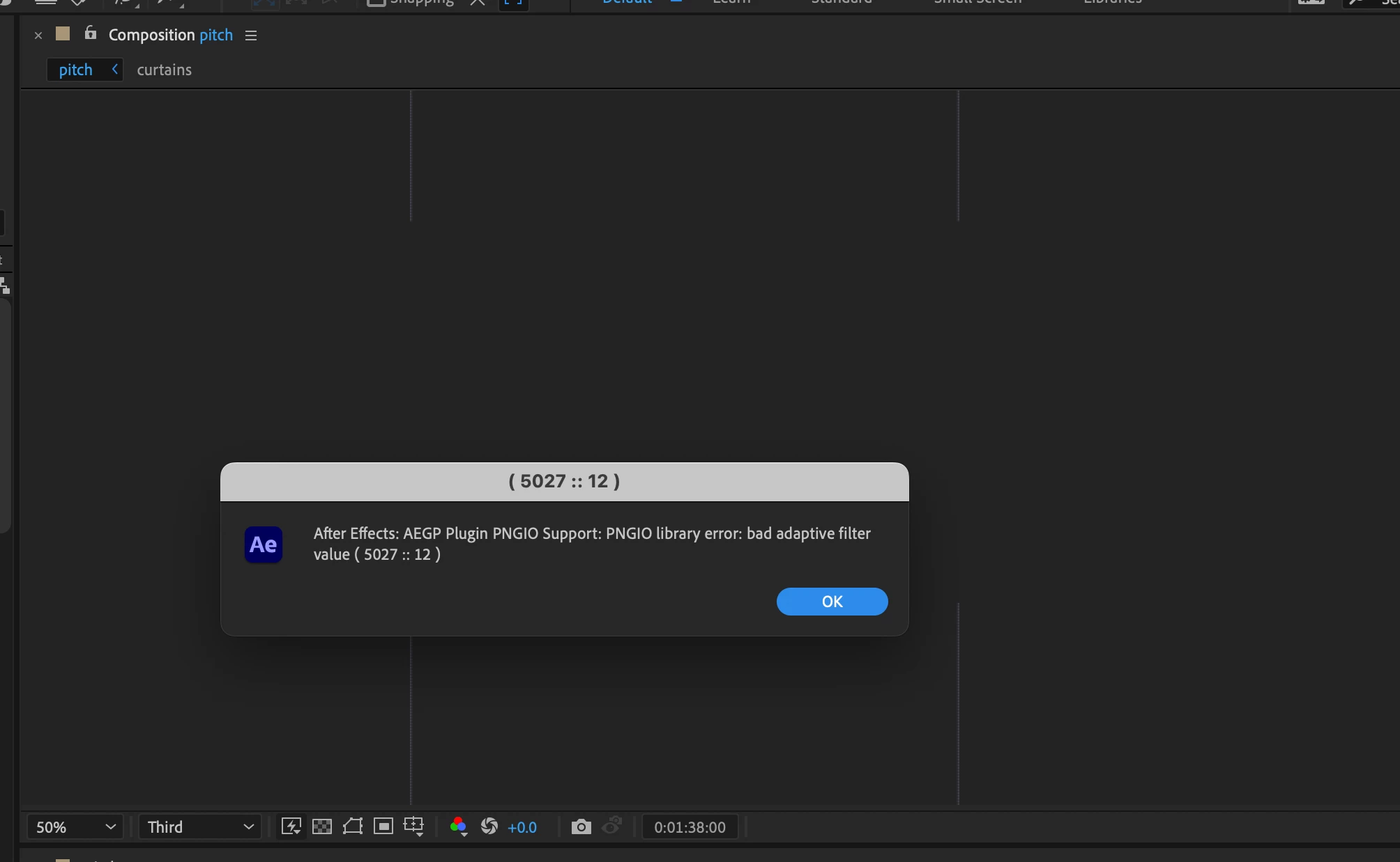

AEGP Plugin PNGOIN Support: Error 5027 :: 12 PNGO library error: bad adaptive filter value
I can't find anything online about the bad adaptive filter value error for 5027 :: 12 and I have no clue how to fix it. The error only occurs when I use playback, I am able to scrub through my timeline without issue. please if anyone has suggestions I'd like to know how to fix this.

Im kinda late to the post, but if you look into your PNG sequence you will find one or more PNG with broken render (grey and colorful glitch line), that's what causing the error. Just re-render and replace that frame.
I found the problem when I look into the PNG sequence one by one.

The "bad adaptive filter type" message means that the PNG file is either corrupted or was generated by an encoder that doesn't meet the PNG specification. Each line of a PNG file begins with a "filter type" byte which must be 0, 1, 2, 3, or 4 and that is not being found.
