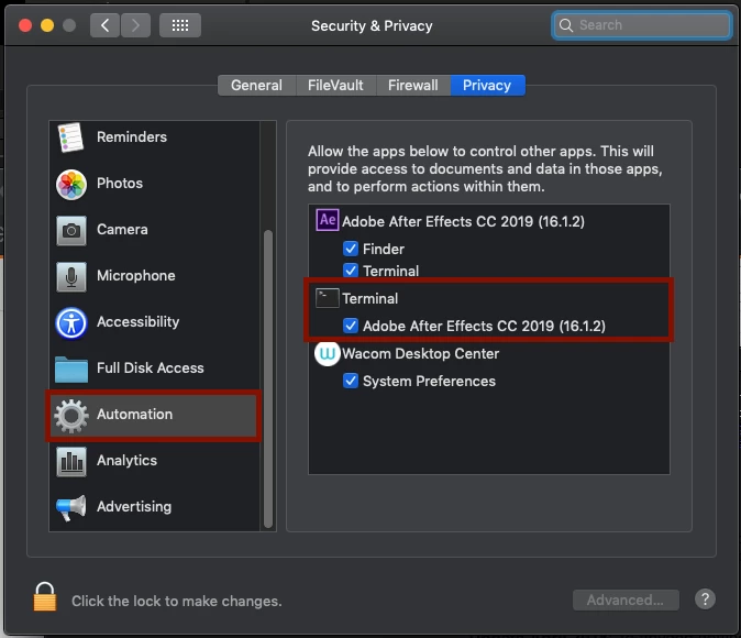

    I am having the same problem. I am simply using the command in a shell on Mac OSX 10.14.5 and get this :
    Launching aerender...
    aerender version 16.1.2x55
    PROGRESS: Launching After Effects...
    aerender ERROR -1701: AEGetParamPt failed at line 780
    cb43551664
    July 29, 2019
    This is a security & privacy issue specific to Mac OSX 10.14.5 ( and possibly later versions ).
