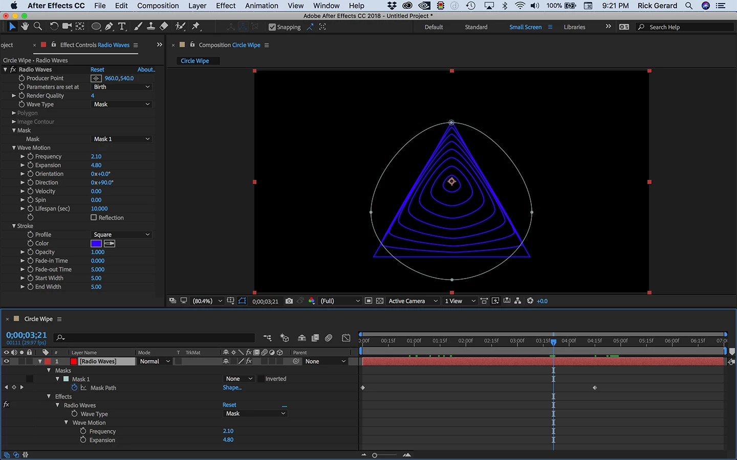

November 17, 2017
I would just animate a mask path. You can start by drawing a triangle and a circle in a shape layer then convert both shapes to a path. The circle is going to have 4 points and the triangle only 3 so you'll need to add an additional point to the triangle. The middle of the base would be a good place. Then you set a keyframe for the triangle and cut or copy it, then add a solid layer and start a path with the pen tool and paste. You should now have a triangle shaped mask on the solid. Next you set a keyframe for the circle path and copy or cut that. Move the CTI down the timeline where you want your animation to stop and paste. Now just select the mask path and paste. You will end up with an animated mask.
Now add radio waves and make the adjustment you need to make to get the look you want. I'm not sure you are going to get what you expect. The first wave generated will be a triangle and each wave generated after that would be more like a circle. You'll end up with something like this:
