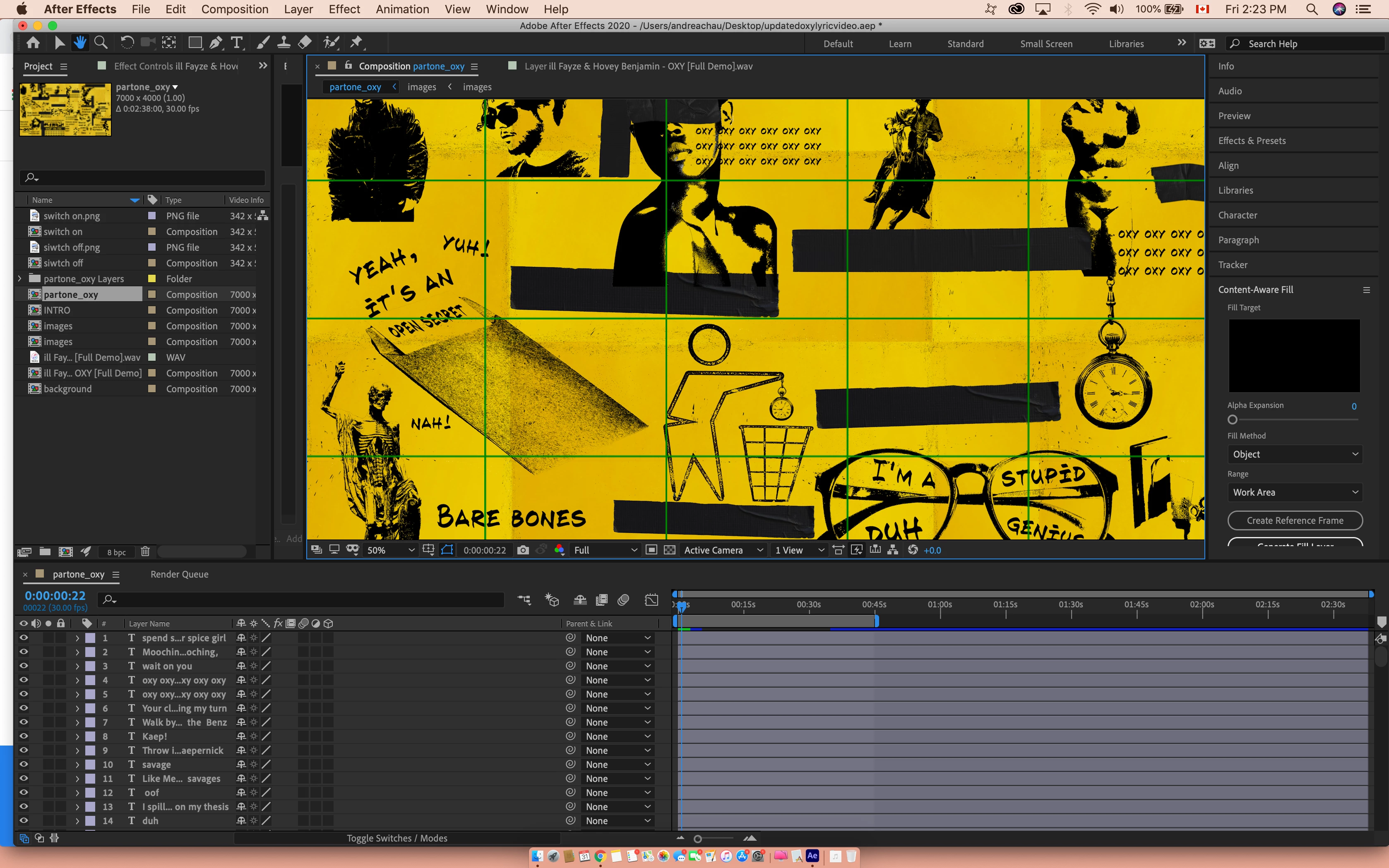

I have been struggling with AE's playback for the duration of this project. I am creating a lyric video with a composition I made in photoshop and utilizing the layers / converting them into text. I emptied the disk cache, made sure the audio hardware is connected to the correct device, cleaned up my computer's storage, and tried the purge>all memory and disk cache method. I have a lot of text layers that I am using the typewriter effect on them. The playback loops within a green bar and the audio is lagging when previewed. Please, someone, help me.
(Attached is a screenshot of my current workspace)

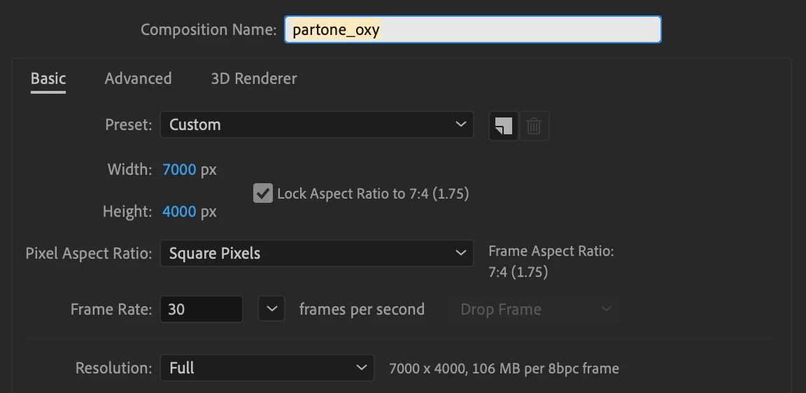

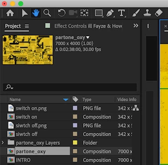

Your comp is 7000 X 4000 and a little longer than two and a half minutes long. You also have at least 14 text layers that I can see and probably as many images in nested comps. That's a heavy, heavy, heavy comp.
Even with a very powerful system that has at least 16GB of ram, you are going to have to set Comp resolution to Auto instead of full, set Magnification to 50% or less and probably set preview to skip 1 frame to get a preview to run longer than about 5 seconds. My 32GB iMac pro will run about a 20-second preview of a 4K comp if I clear everything and have the resolution set to auto and the scale to 50%. You can also increase the preview time if you select Fast Draft so you can check the timing.
Your comp is nearly 8K, but it does not match any video standard. Why is it so big? Are you going to have one shot that is over two minutes long? If you could explain your design goals and workflow we might be able to help you work more efficiently.

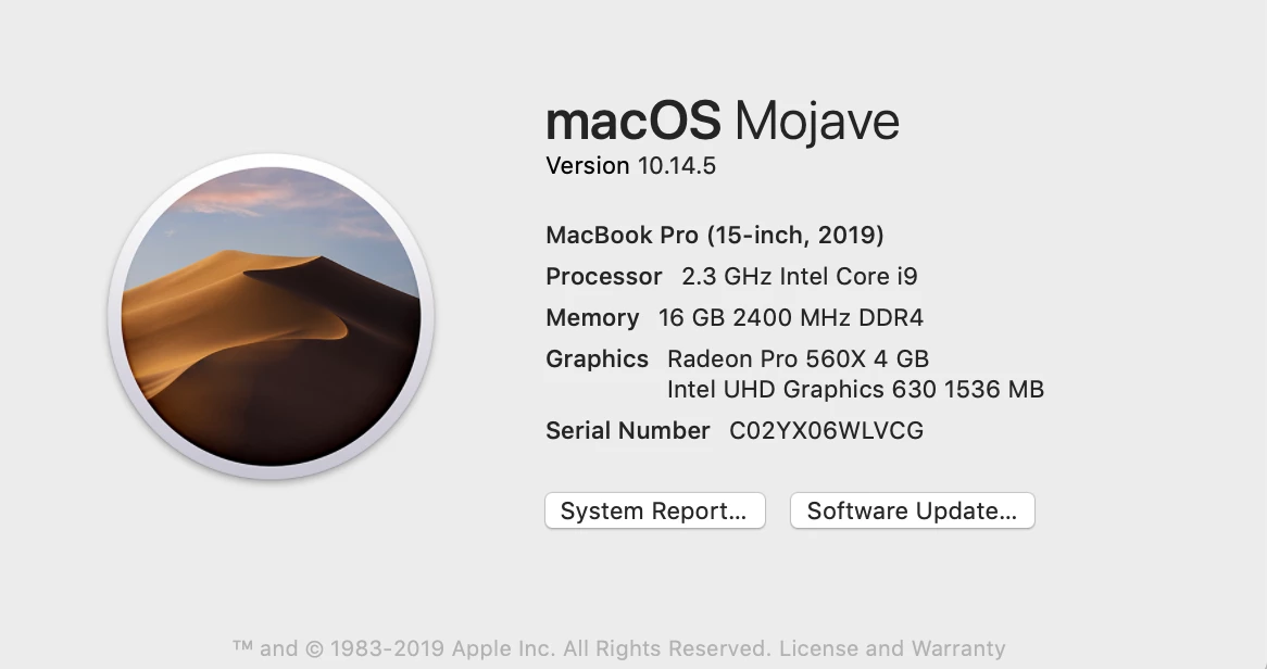

Could you share your system specs and composition size?
August 5, 2020
