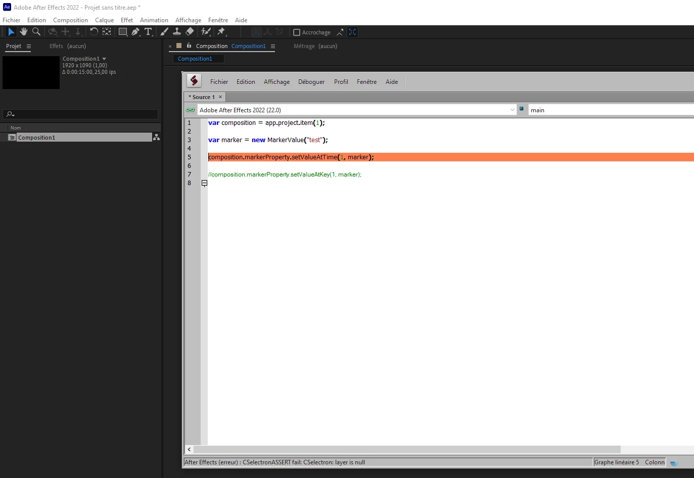

Here are screenshots of a minimal crash example:
1) Create an empty project, with an empty composition "Composition1"
2) Use ExtendScript Toolkit to execute the following code, which should create a composition marker.
There is an error CSelectronASSERT fail: layer is null, which is an exception.
The marker is created if you press the green triangle of the debug bar.

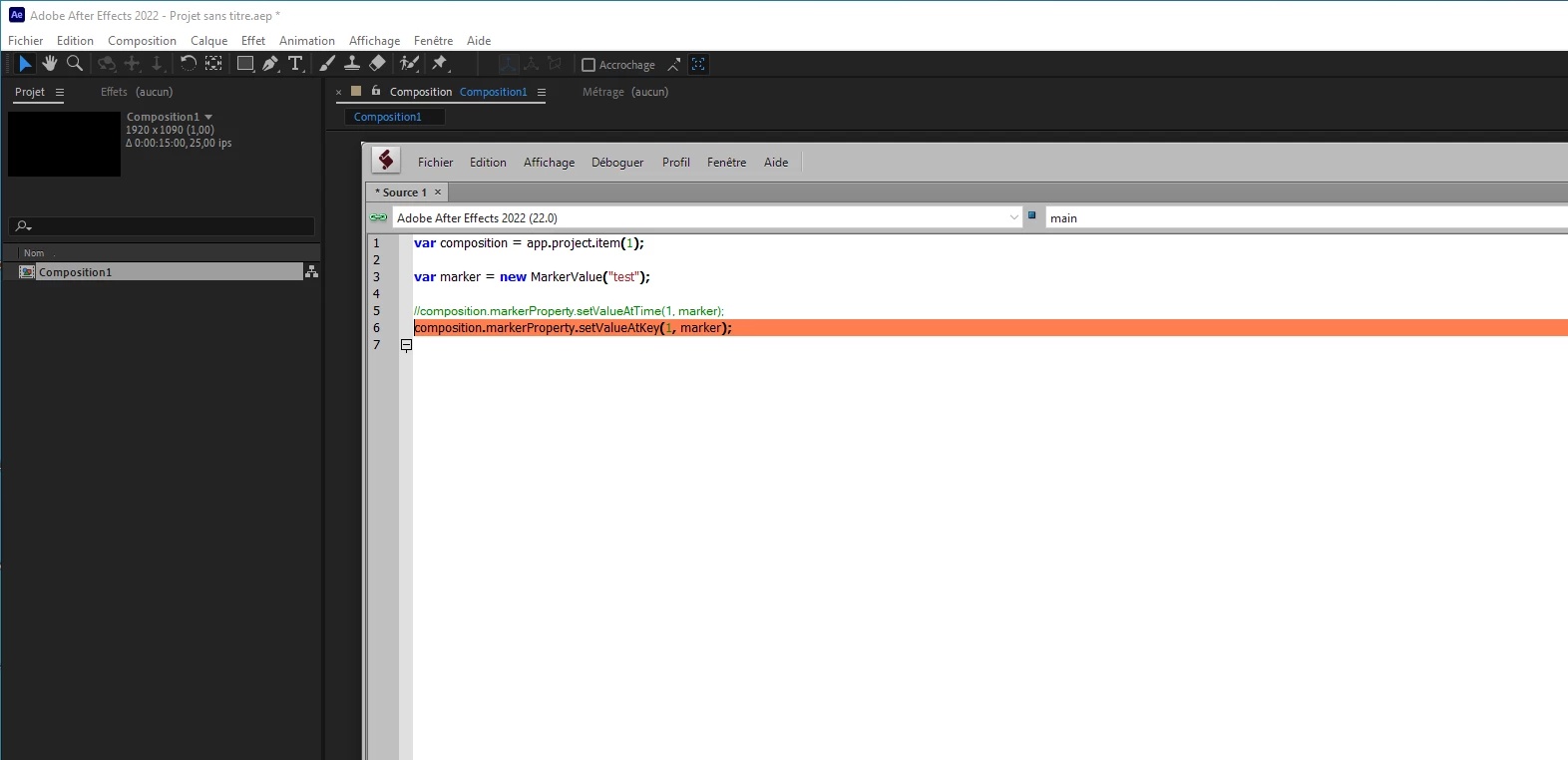

3) Use ExtendScript Toolkit to execute the following code, which should update the marker.
Same error.

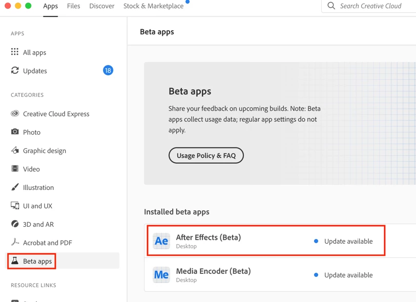

Thanks for reporting this bug. The After Effects team is aware of this and have put a fix in After Effects Beta v22.3.0x62. Feel free to install the beta build from the Creative Cloud Desktop app.
More info can be found in this UserVoice post: https://adobe-video.uservoice.com/forums/911311/suggestions/44793199
Rameez
Rameez_Khan
February 15, 2022
NOTE: Installing the beta version will be a separate install and will not interfere with your current stable release of After Effects.
