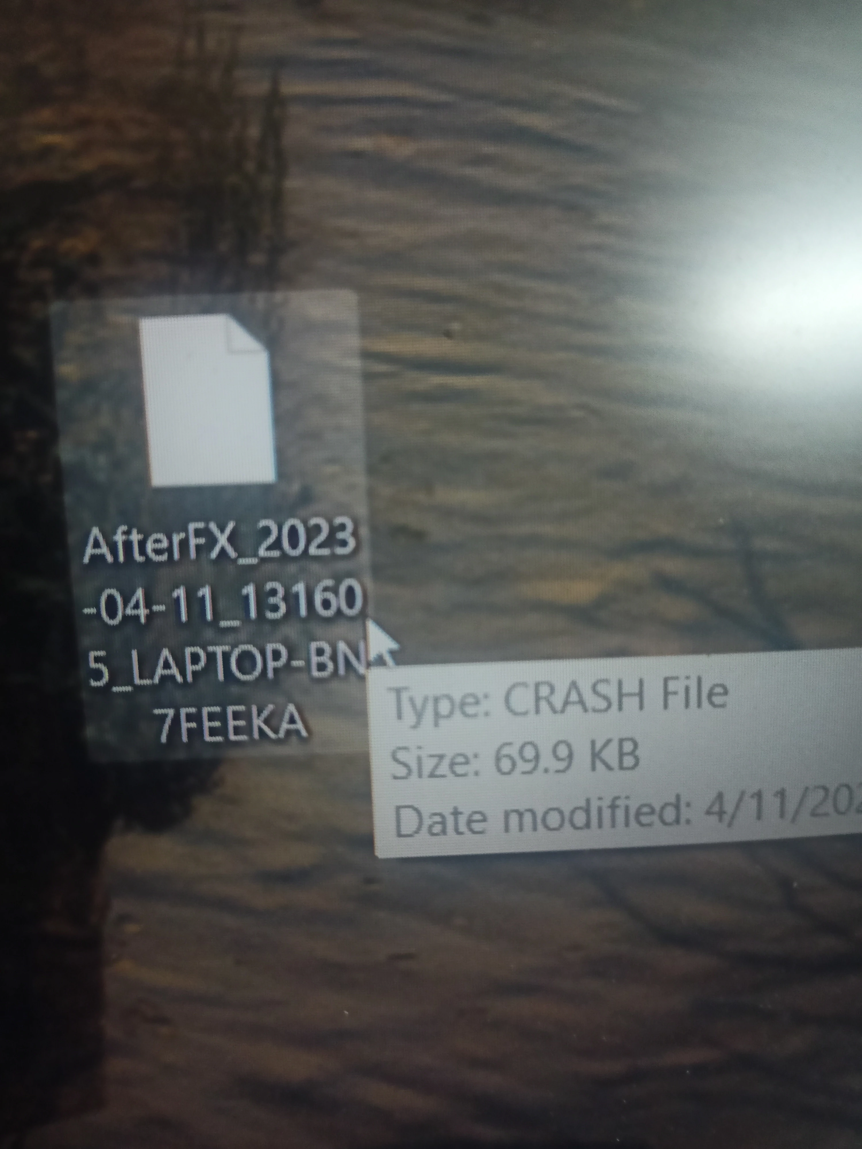

Apr 11, 2023 3:37 PM UTC
Good afternoon. Please tell me, AE does not open. When I go to AE via Creative CD, the wheel spins and then throws it out and a CRASH file is created on the desktop. tried reinstalling, updating, completely deleting Adobe suggestions. but the problem never went away.

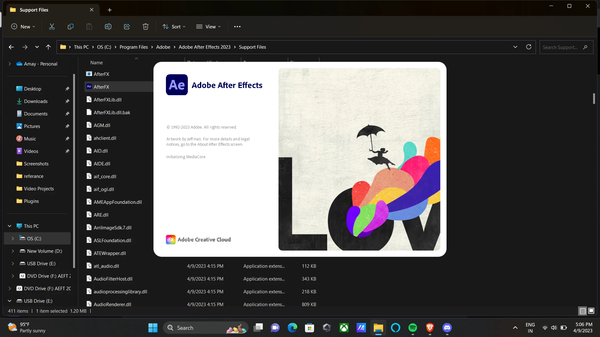

AmayIzzzLearning
Apr 9, 2023 3:21 PM UTC
Hello, I'm also facing same issue on my ROG Strix G15 and my RTX 3060 drivers are updated. And I have same story as I had exams I took a break from editing for a month and now it doesn't start ( gives same crash file everytime I try to start Ae).
