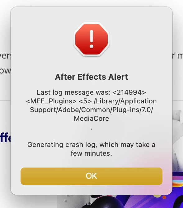

After Effects 24.5 crashes on loading - MediaCore plugin error message
I updated After Effects to the new 24.5 and it just crashes upon the loading screen and supplies the error crash message - Last log message was: <194416> <MEE_Plugins> <5> /Library/Application Support/Adobe/Common/Plug-ins/7.0/MediaCore
My setup
iMac M1
Mac Os 14.6 Sonoma
I have tried re-installing as well as installing AE Beta and older version of AE to see and I get the same error message, I basically can't open or run AE at all... I cannot do my day job now and am in trouble.

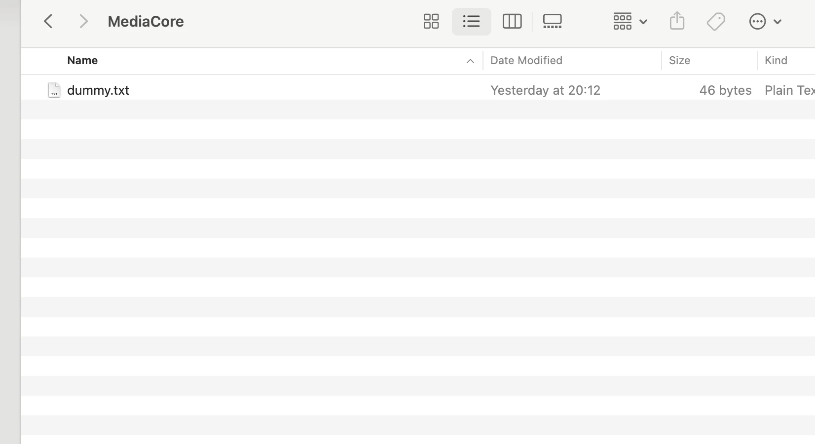

Hi, I get the same error crash message when I click "Manage Plug-ins". In the folder for HD/Library/Application Support/Adobe/Common/Plugins/7.0/MediaCore there are no third party plug-ins it is empty bar teh dummy.txt file. No hiddens files in here either. I had already read online here about this fix but nothing to copy out.
What can we do?

Sorry to hear about the crash. Have you tried disabling the plug-ins when in Manage Plug-ins? If not, give that a try. In case it doesn't help, go to the following location and remove (or move to a different location to keep a backup) all the files and folders except dummy.txt and try to launch After Effects.
Location on macOS - HD/Library/Application Support/Adobe/Common/Plugins/7.0/MediaCore
Note: macOS has two different libraries, User Library and System Library. You need to go to System Library.

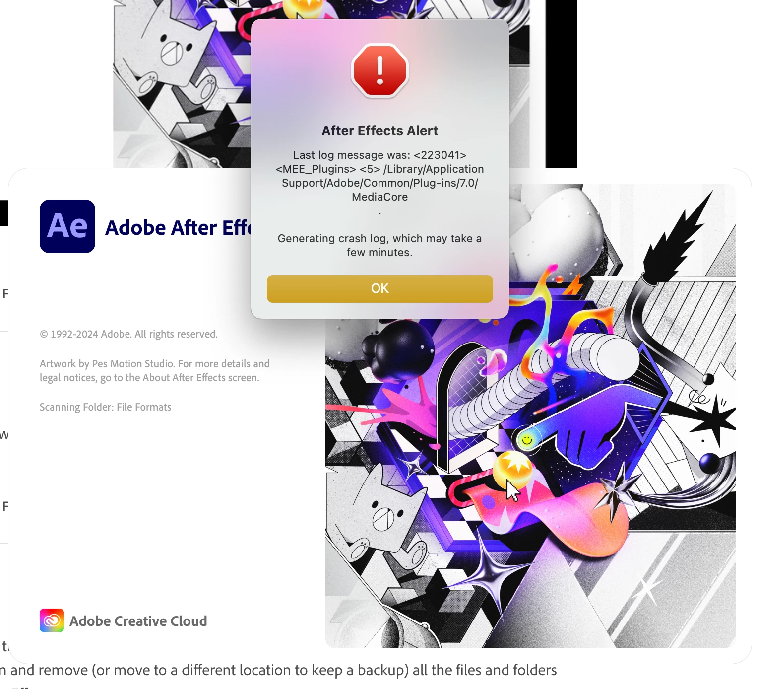

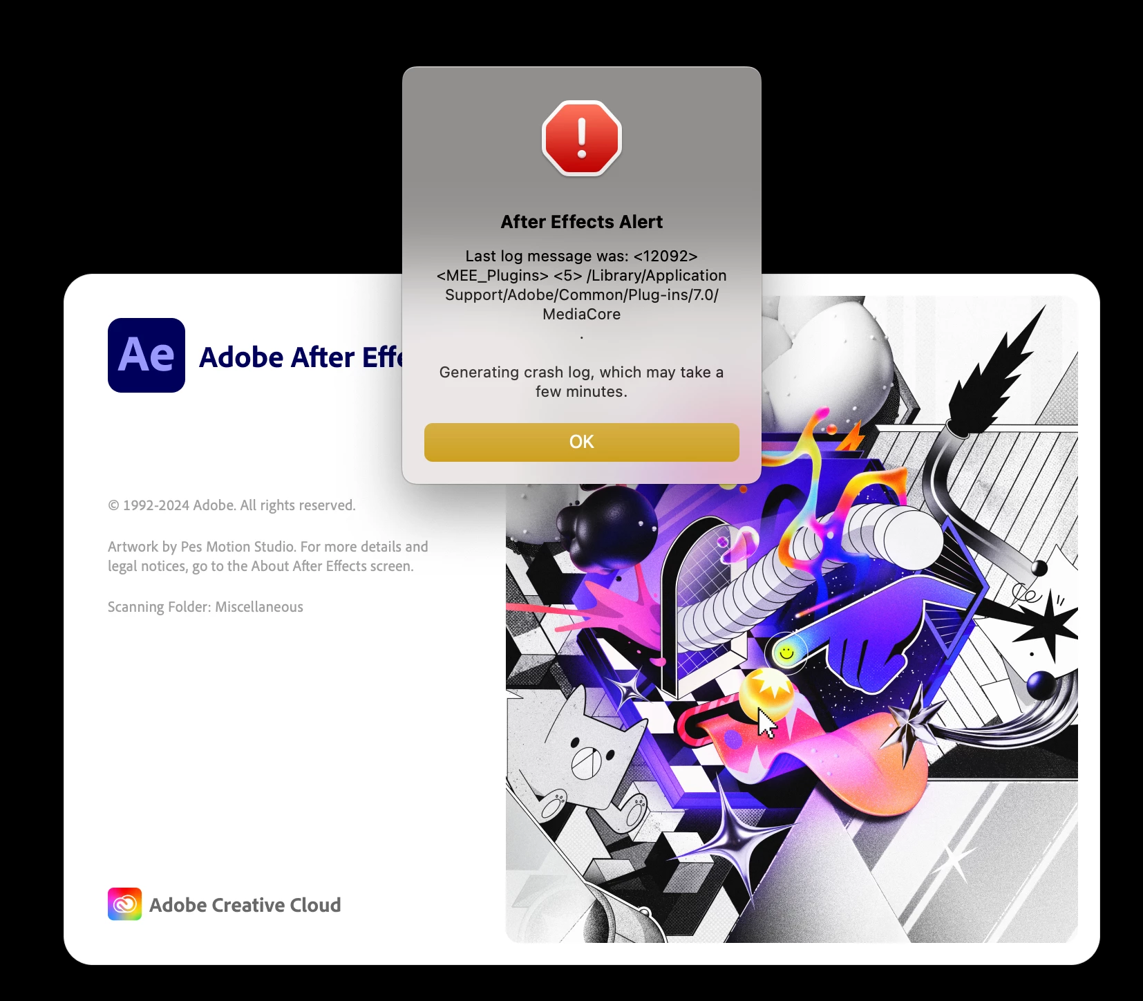

Tried again today from Safe Mode and this message comes wether I click on "Contine", "Manage Plugins" or "Reset Preferences"
Aug 6, 2024 9:13 PM UTC
Safe mode creates a crash just the same and the same error message box
