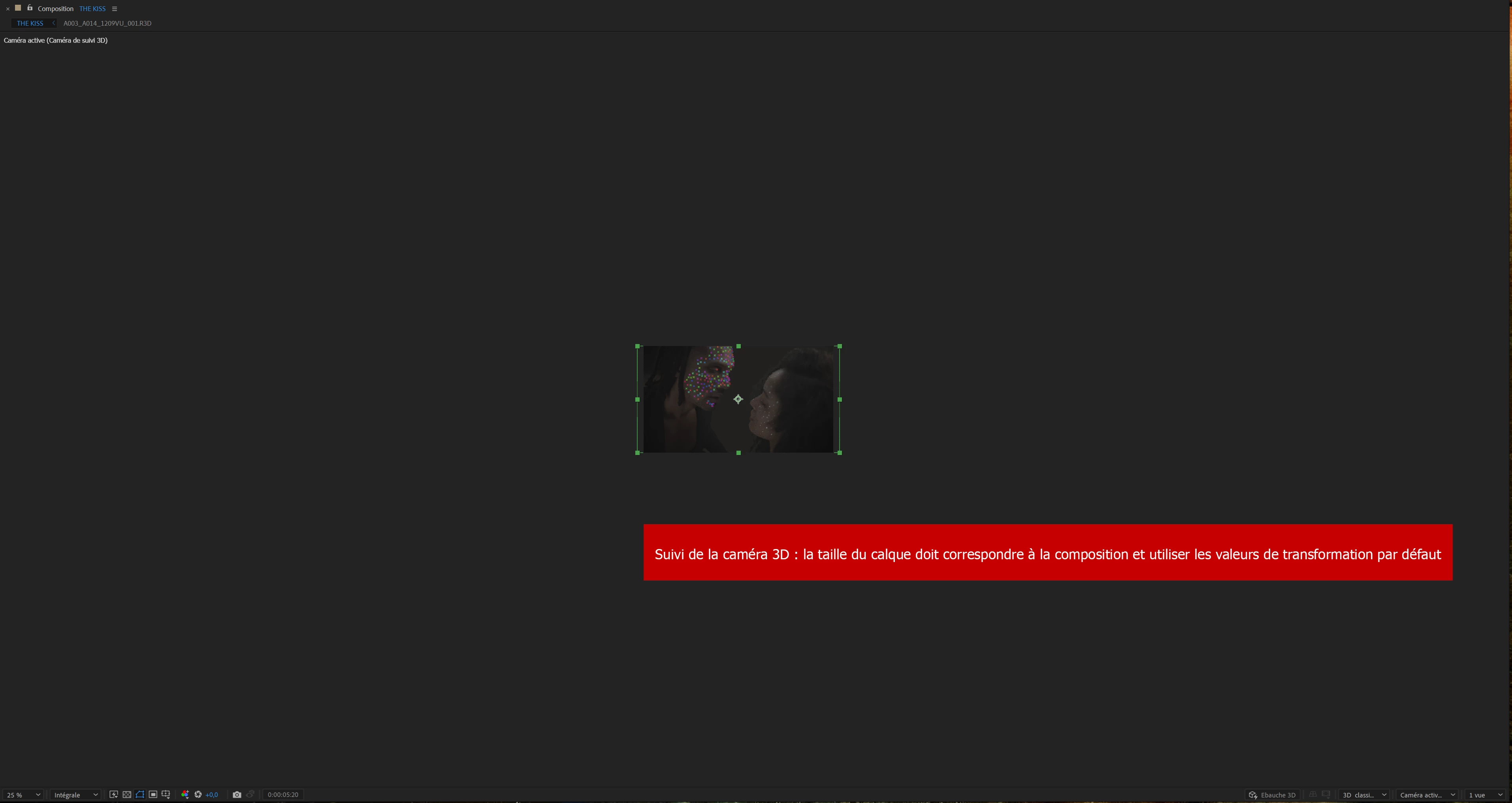

Nothing was working for me but i figured my footage was larger than my comp size. I couldn't tell this was the problem because the warning banner was waaayyyy out of frame for some reason. I saw it while accidentally zoom/scrolled out of the comp size. So here you go : you just have to pre-comp the footage, analyse again and voilà!

I had the same issue and all I needed to do was pre-compose (move all attributes) the layer that I was trying to track and it worked. If the layer is a different size than the composition... I seem to have problems selecting the track points.

If you film with 4k you have to convert it to 1920/1080 then it works for me

i had my comp at a different resolution and had scaled my layer down to match. This seemed to cause this error when it came to tracking. I could see my points but couldn't interact with them and my target wouldn't appear. I remade my comp at the same resolution as my video clip then tracked it. The target tool then appeared.
