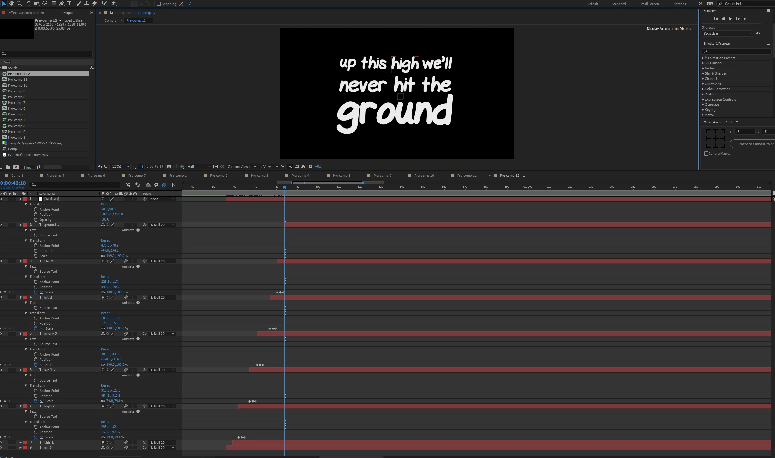

Sorry for the very (hopefully) basic question, but I'm quite new with after effects and I'm trying to learn it.
Basically, I used to be able to select the 3d layer on a text layer (or even a null object) and the 3d was front facing.
I had to format my PC, and now, every time I select the 3d layer, it start with an angle and it hides all of the other layers, showing only the 3d.
I'll try to add some picture to better show you what i mean
The second one should be front facing (at least it was before the format and it is on different compositions), so i am assuming it's something to do with a setting?
can anybody help me, please?
thanks
Correct answer Mylenium
Set the view to "Active Camera" at the bottom of the comp viewer.

May 10, 2017
Thank you very much, that worked.
