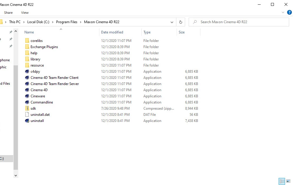

The Editing section of the Cineware Plug-in it set to C:\Program Files\Maxon Cinema 4D R22​\Cinema 4D.exe
When I look in the folder there is no C4D Lite version, is there a place I can download that?

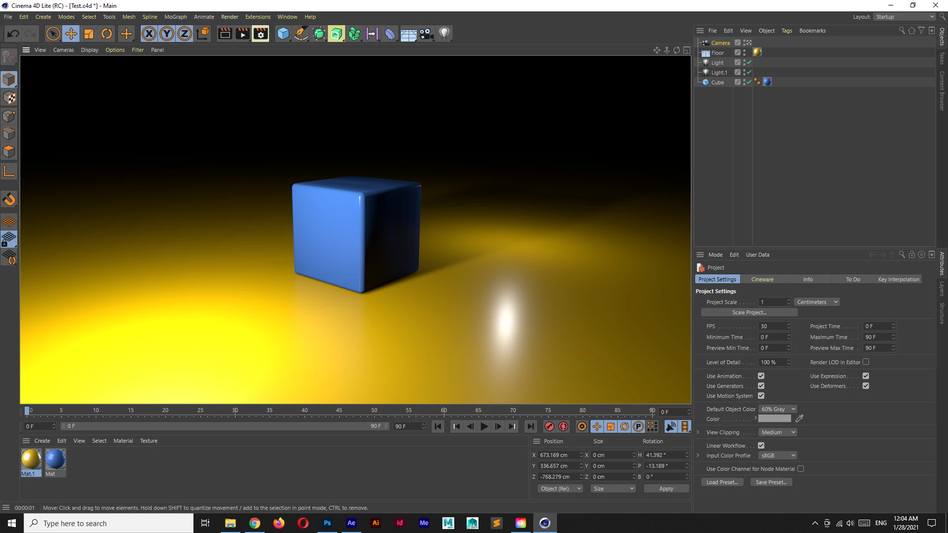

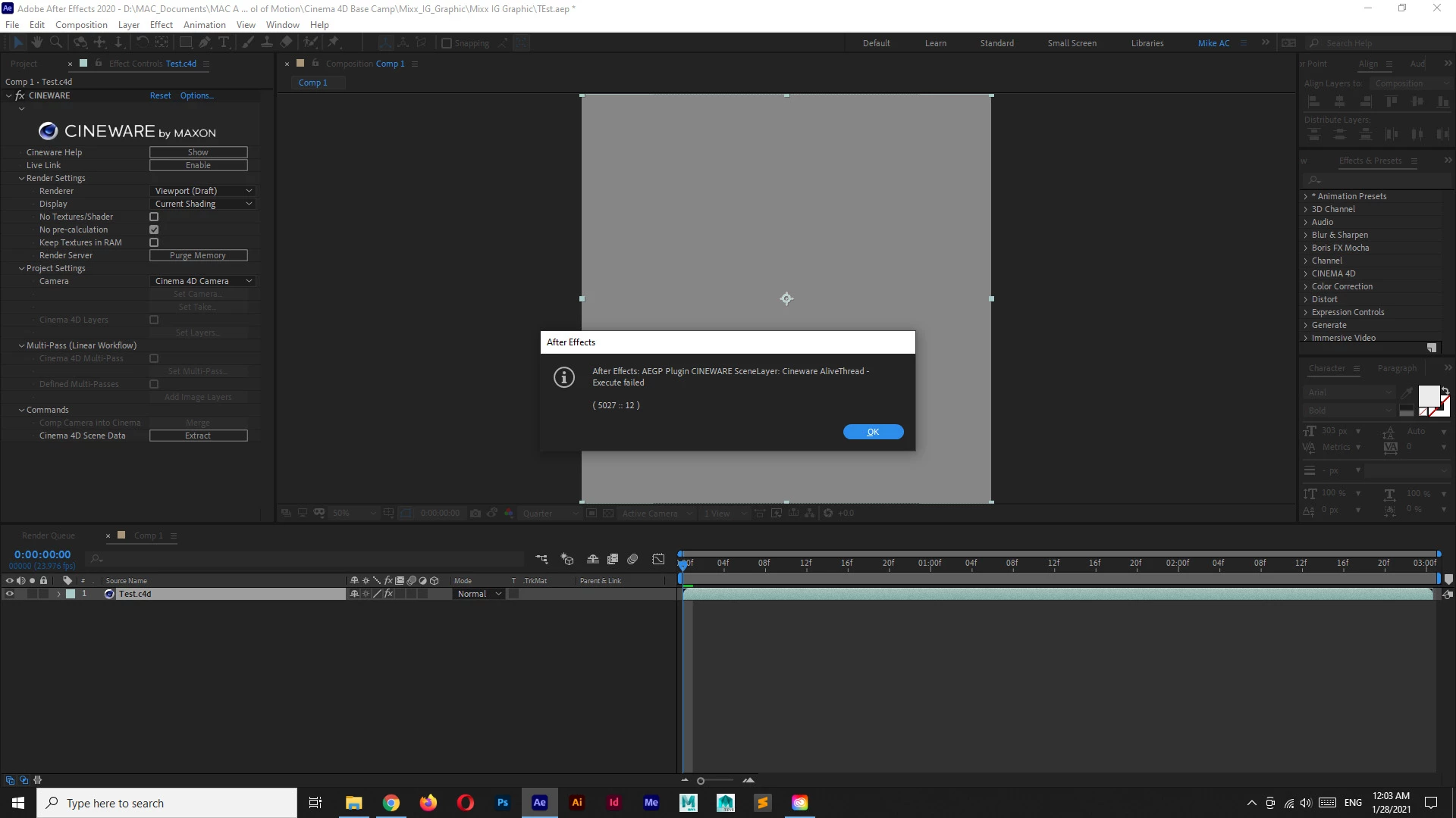

So I almost resolved the issue by clicking the uninstall Cinema 4d program, and then I reinstalled After Effects. Even though I reinstalled everything it still says C:\Program Files\Maxon Cinema 4D R22\Cinema 4D.exe, but Cinema 4D Lite opens this time. However it will not display in After Effects, it still gives me the same error when I return to After Effects to see my C4D Scene.
This is a Scene I made in C4D Lite:
This is what happens when I go back to After Effects:

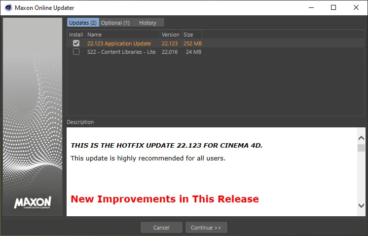

So I misunderstood this inital solution up at the top, I thought the issue was the After Effects version. The issue is on Maxon's end. It doesnt matter which version of AE I use (I kept downgrading thinking it was an AE problem), everything worked fine each time until I installed the HOT FIX Update22.123 for Cinema. That is when it stops working in AE.
DO NOT INSTALL THIS UPDATE!!!!!

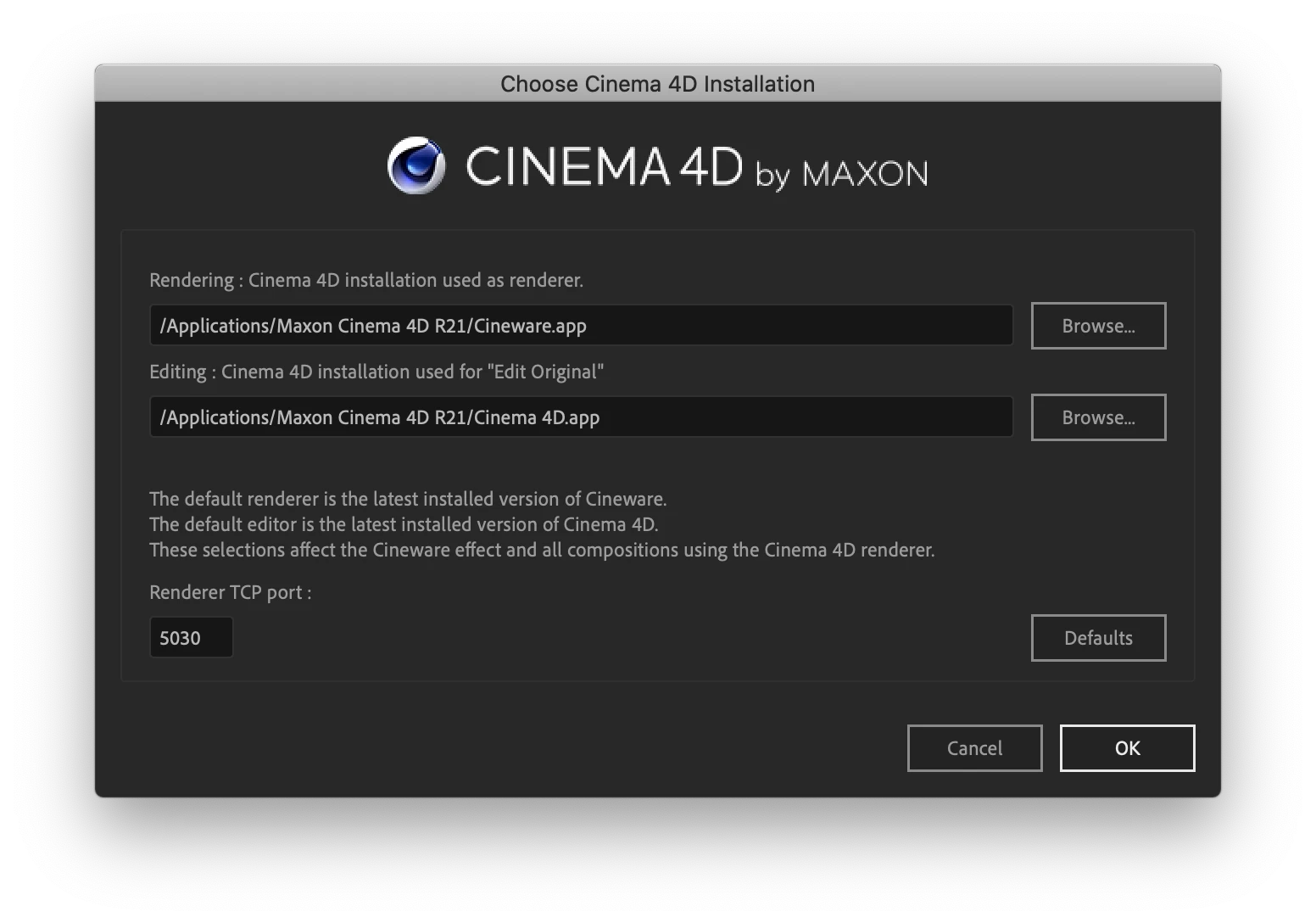

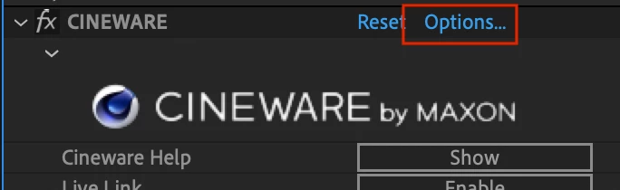

September 12, 2020
Tell us one more thing. When you create a composition file with the C4D file inside, click over the Options button in the Cineware Effect plugin and check where is Cineware looking for editor and renderer options for the cinema 4D files. (Check attached images)
