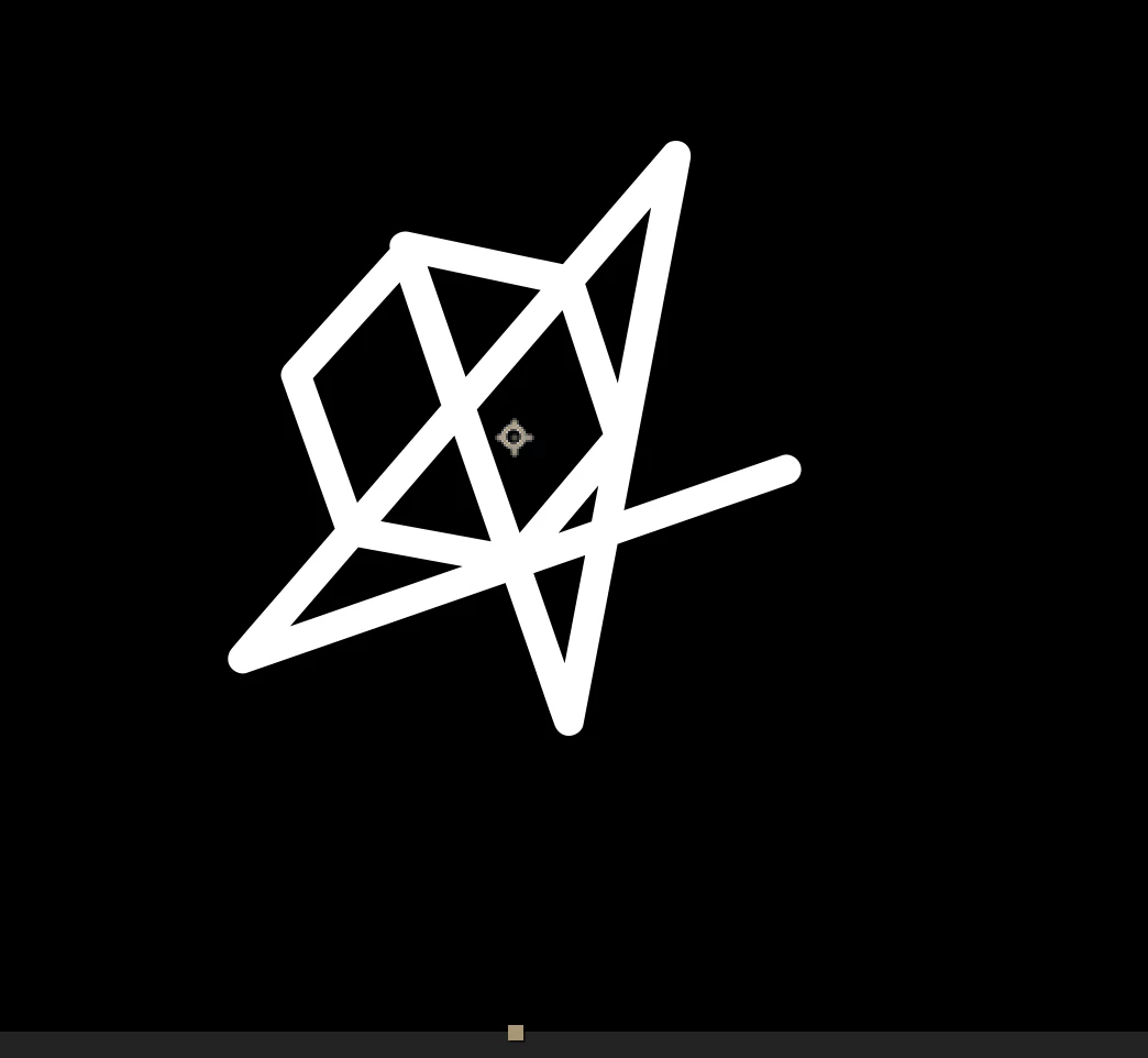

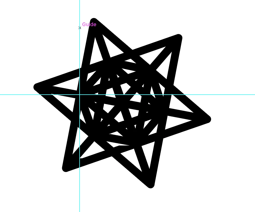

this is the shape i want to animate with three paths, in white with a black background in after effects
this is one of three paths created to extend from center to draw the shape
but it keeps looking something like this as I try to use trim paths (approx 40% of trim path effect)

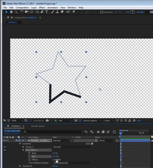

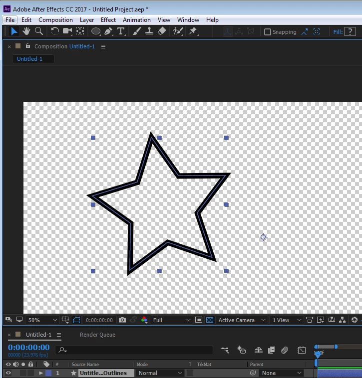

it has to be uniform and regular brush like this
it will convert to a shape retaining the same path
now when I trim path it will behave as expected

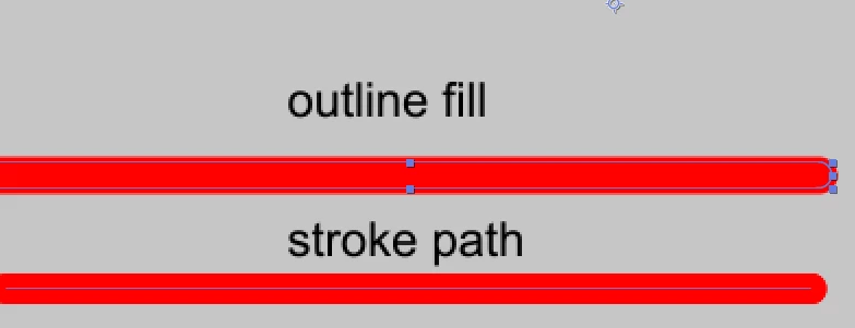

if you want to successfully use the trim path operator you need to make sure that your illustrator path has made the transition into a shape as a stroke path and not a fill outline.
you want a thin path in the middle of the shape, not an outline on both of it's sides. if you have an illustrator art then make sure you are using a regular brush and a constant width stroke. this way when you create shape from vector layer, it will be a shape with a stroke path and not a fill path. if you made it initially with fill outline, you would have to rebuild it as stroke path. now when you trim the path it will be predictable.
if you are experiencing anything different please share the file here? upload it to any legit cloud service.
